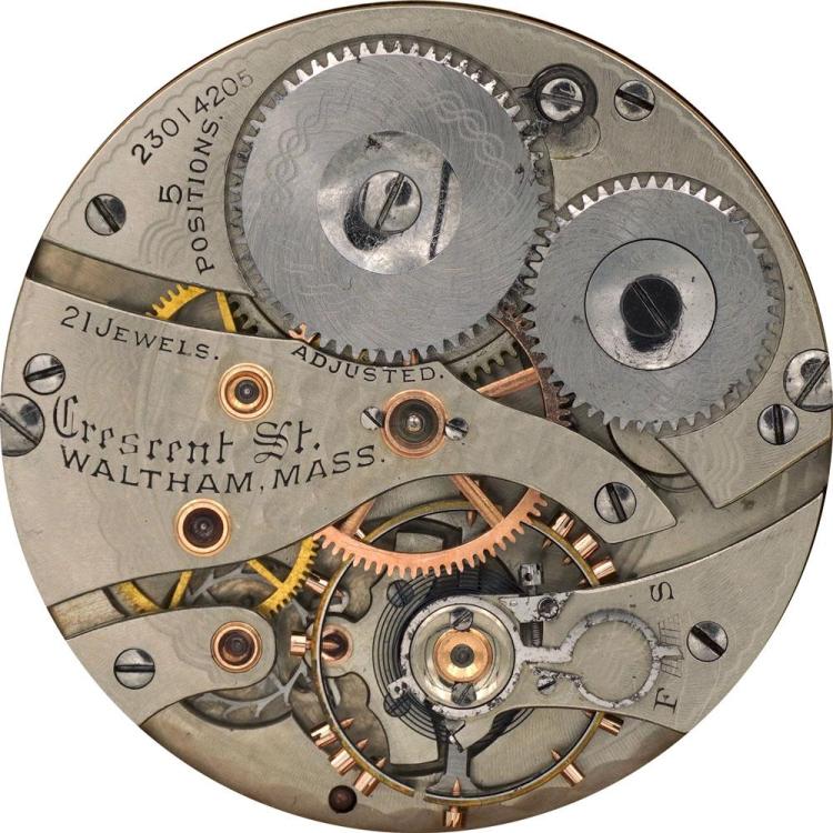

Any thing like this as you can see it has a bridge plate movement, its a Waltham and there are plenty of spare parts, the photo is a high end grade but you can get them with hardly any jewels I think as little as two.

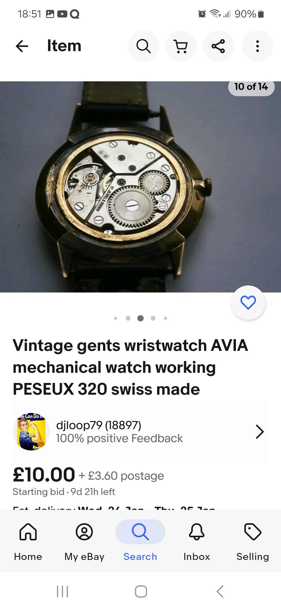

If it's a complete wristwatch you want to work on, you could do a lot worse than something with a working ST/FHF96 movement in it. There are a lot of them about, as it was a popular budget movement back in the day. That makes them reasonably priced, spares are available, they were made to be serviced so they are relatively easy to work on, and what you learn there will transfer to a lot of other movements. Avoid anything coming out of India though
Edited by Klassiker
Spelling
I do rather like that watch, I would now ask the seller if they can take the back off so you can see the movement.
then we can confirm what it is.
Tom
Seems like there's one picture with the back removed, not sure if there is enough detail for you to make out the movement:
Yup had another look and it indeed looks like a FHF 96 from the engraving under the balance. I like the look of it so if you decide not to go for it let me know 😀
