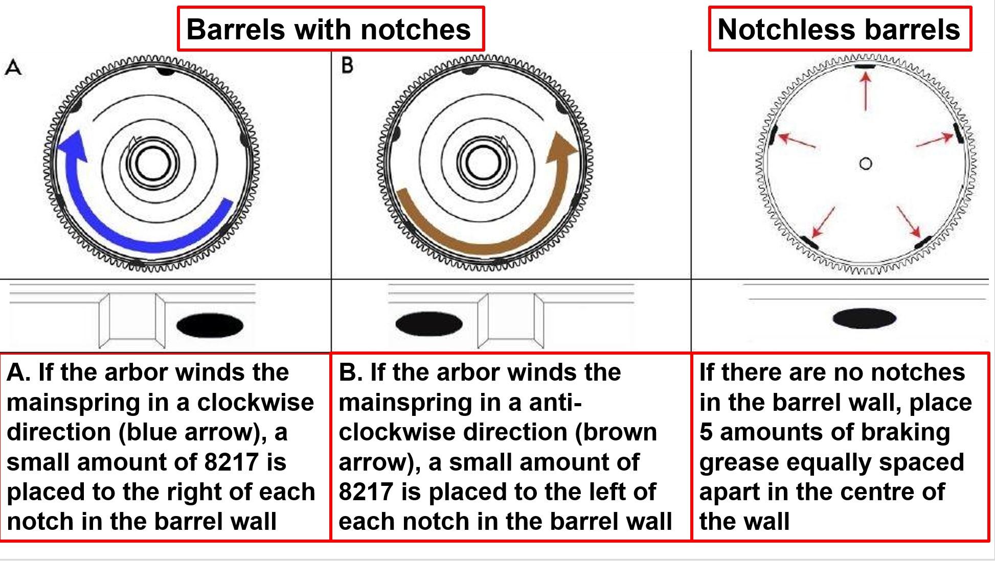

There are generally three types of braking grease for the barrel walls depending on what the barrel is made of. Moebius 8212 is meant to be used on aluminum barrels. This grease has a moderate braking effect. Moebius 8213 is meant for brass barrel walls and isn't quite as thixotropic as 8212, but is more viscous than all of them so provides slightly more braking. The goldilocks of them all is Moebius 8217 which can be used on all barrel types, This grease is the least viscous but still has a fairly good thixotropic effect. The thixotropic effect is when the grease is under load or pressure it changes from a viscous grease to more fluid like an oil. Moebius 9415 is a thixotropic grease for pallet stones because of this effect; it is better than 9010 which used to be used. Oils and greases have developed a lot in the last decade

Here are some slides from a lesson I wrote for my students. As you can see the slipping bridle was set incorrectly which I found when taking the movement apart. It is important the bridle has room to close up properly, which highlights the point that "just because you found it that way doesn't make it the correct way" So, don't ever assume how you found it is how it should be!

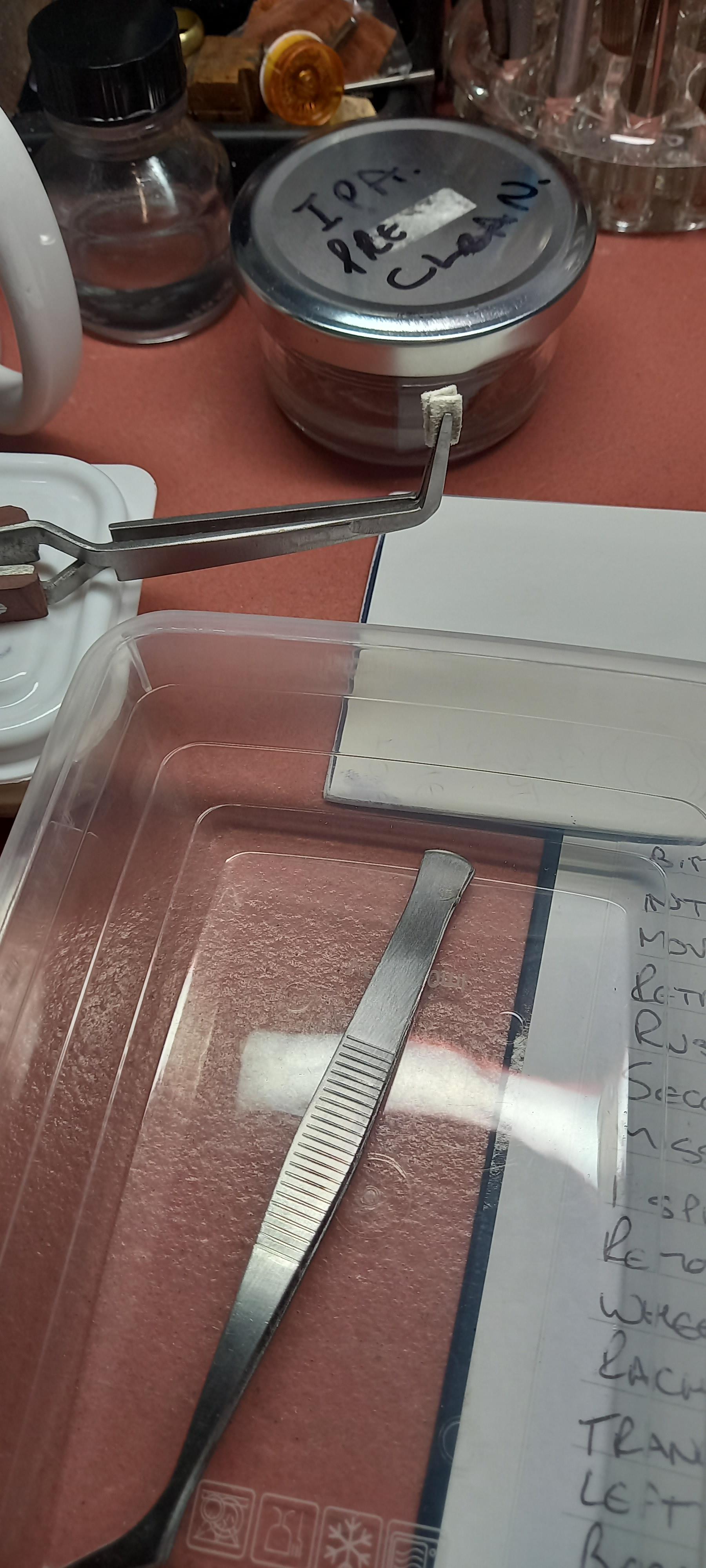

👍I use greased watch paper in a pair of tension and tip adjusted reverse lock tweezers. Makes life a little easier and gives you an extra hand to control the spring. Same tweezers i use to clean the spring with a small strip of chamois after ipa soaking the spring. Clean and grease in one operation.

make a pair of greasing tweezers with chamois leather on the inside. The chamois is greased with 8200 or 8300 is best in hot climates and the entire length of the spring is lightly greased. You know when enough has been applied as it is the feel of the grease on the spring and how easily those greasing tweezers slide over the spring. If you have greased the spring too much you'll see excess on top of the spring when you use your winder and it is within the barrel. If you haven't greased the spring enough then put a few small drops of grease on the top of the spring like Kalle Slappe does. There are many ways to skin a cat here. I can only say what works best for me. After you've greased a few mainsprings you'll get a feel for what the right amount is on the spring. If it is too much and you see pools of grease on the spring when in the barrel, then mop up the excess with some rodico. The great thing about making these greasing tweezers is you can get into the innermos
Thats almost exactly what i have cept my tweezers are locking, just frees up a hand. Either greased watchpaper or chamois.

I make a pair of greasing tweezers with chamois leather on the inside.
Great tip. Bergeon has dedicated tweezers for this purpose but as usual the price is, shall we say, a bit steep?! 😱
How do you get the chamois leather to stick to the tweezer tips? Where can you get chamois leather? I want to make my own.
A grease frequently used as a braking grease we haven't talked about is Kluber Chronogrease P125. I'm pretty sure @nickelsilver mentioned using it for all types of barrels. It's the grease I use. And mind you, it is only £23,000.00/Kg (including VAT) 🤑
I chose to use locking tweezers, makes it a little easier to change out the paper or leather and holds the spring in place handsfree I also like Jon's idea as well , i copied that from the nekkid watch maker ages ago but slightly preferred my idea. Chamois leather most hardware stores in the UK, traditionally used to wipe down your car after washing it, my dad was doing it 50 years ago, and the old faithful piece of equipment of the window cleaner. Thats how i aquired mine from our cleaner.
Superglue on the tweezers to stick the chamois leather. You can buy the chamois or a faux chamois at most auto parts stores for cleaning your car. When the chamois has had its day, soak the tweezer tips in acetone and start again with fresh chamois.
Just perfect Jon! Thank you! 🙂👍

The confusion for me came from the comparison between a dry barrel wall and a greased wall. In contradiction a braking grease will allow a spring to slide along the wall being it at a set moment of force applied as opposed to an ungreased wall that i expect wont allow much slippage at all. The term breaking i guess just comes from the comparison between different greases, they coud just as easily be known as different slippage greases.
The term is somewhat oxymoronic (as opposed to me, who is usually just plain moronic 😉 ). Think of it like giving parts a final dip in IPA to absorb any residual moisture. You have to wet it to make sure it's dry. 🤨

Actually, it is even more complicated. It lubricates because it forms a film on the metal surfaces, preventing metal-to-metal contact. But the "braking" effect is due to the viscosity of the grease. The friction between the molecules of the grease gives resistance to slippage.
An easier to understand example would be the focusing ring on a camera lens. If the parts were dry, the metal would rub against each other and could actually squeal and make your hair stand. If normal grease was applied, the focusing ring would turn so easily that it wouldn't feel right. So, a special type of grease, similar to braking grease, is used. But in photography, it's called a damping grease, adding even more confusion.
