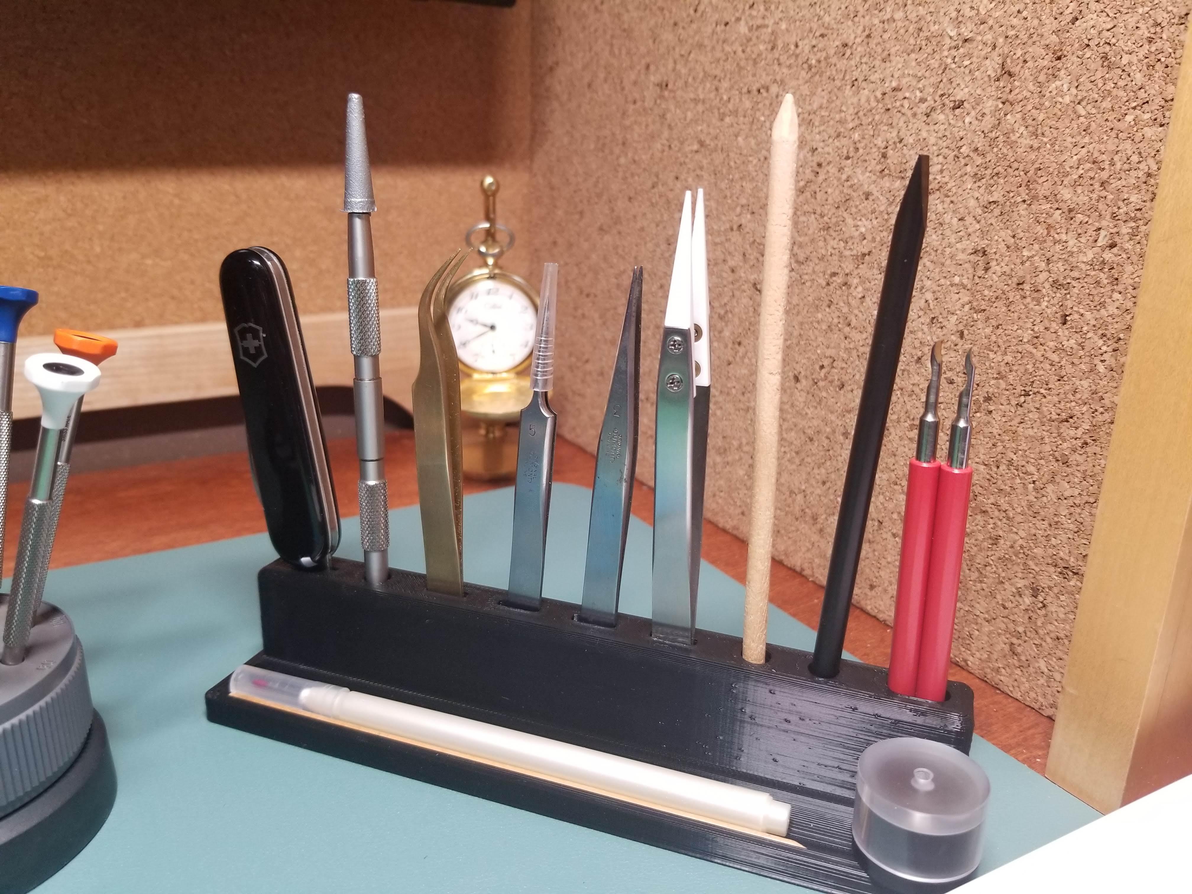

These are the tweezers that I use for most things.  The Italian brass tweezers I use most often.  The angle on them makes some things easier to do.  I did have to dress them a bit to get them to my liking.  The ceramic tipped tweezers I use for dials, date rings, hands, and other delicate items.  I do occasionally use them to open up case backs, by pushing on a notch.  They've held up to that abuse.  Vintage Dumont #'s 3 and 5 round things out.  I do have some cheap tweezers that I use on occasion when I don't want to risk damaging my good tweezers with a task.

I do like those brass 7s, i have 2 pair of cheap cousins in my set, i might dig them out now.
