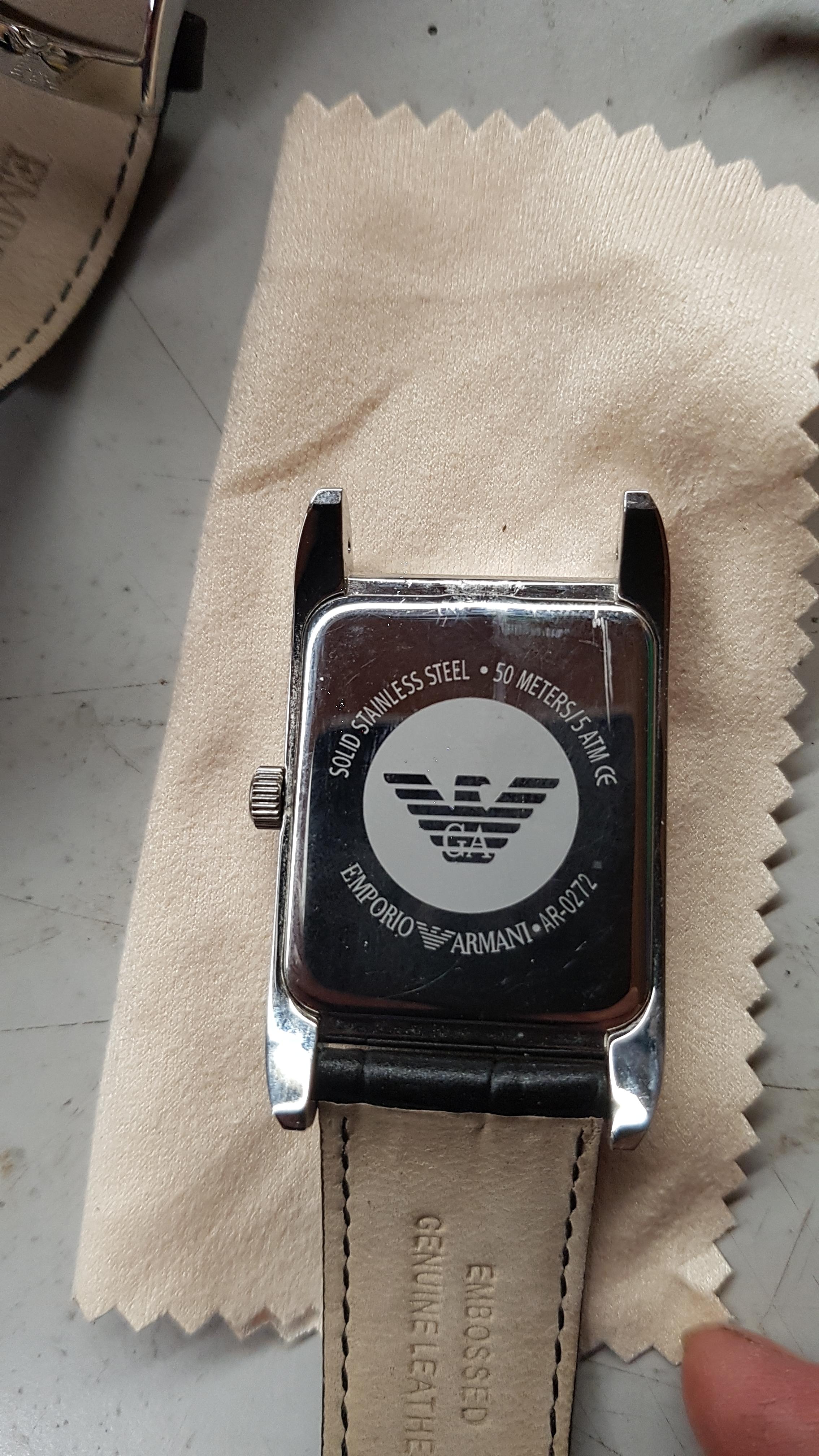

I have a dress watch, Armani AR0272, with a clip on back that simply won't budge and all I'm achieving with various back removal tools, levers and even small screwdrivers are more and more scratches. I'm also scared that pressing on the lever (to stop it slipping out of the slot) will result in the tool ploughing through the mechanism if the back suddenly gives so what are my options please?
Can you please send a picture, this will help us advise. Also if you list what tools you have available, we could maybe recommend the best one and how to best use it ๐Ÿ™‚
We'll crack that nut!
Btw the big scratch on the right wasn't me(!) but the marks centre top were. I have a pry bar and two different "tab" style openers but none of them will stay in the slot and as I said I don't want to be leaning on any of them too hard in case the back does suddenly give out and I gouge the mech inside.
I changed the battery in one of these for a friend. I remember it took some force to get the back off. But with my cheapo tool wasn't a problem. I had to use a press to put the back on, I couldn't do it with fingers.

I have the same one and it's my go-to if the case knife doesn't do the trick. There is a technique with the case knife as @Michael1962ย says, more of a twisting action than a pushing/levering one. I also have one of those spring loaded things, like a spring loaded center punch, but I find them difficult to use and have a small scar in the palm of my hand where it slipped, however it does seem to work well on the thinner quartz type case backs.
Probably need to think about replacing the case back too. If its this hard to get off, you can be reasonably sure it will be difficult to put back so need to think about how you will do this, a case press is probably the best option and can be relatively inexpensive:

Yes I've tried pushing, twisting swearing! I saw someone using a small jewellers screwdriver and a small hammer- yeek!!!
"mikepilk" that looks like the kind of tool I was imagining, a pry bar but with a clamp to keep it in the slot ๐Ÿ˜„ Where did you get it please?

I bought it on ebay. Cousins do one for about ยฃ15, (or ยฃ70 for the same but labelled Swiss!)ย  ย https://www.cousinsuk.com/product/bench-top-case-openers

The best way I have found to use this tool is to move the blade so it is aligned horizontally at the same height as the gap between the case and case back. Next wind in until you make contact with the gap between the case and case back, then give the wheel a 1/4 turn (may be less on your model depending on the thread pitch) then try 4 or 5 levering actions as up and down, note that you may not get it on the first levering action, but maybe on number 4 or 5? Next, tighten the wheel a fraction and repeat the 4 or 5 levering actions, and so on. If you go too hard too fast there is a real risk you can deform the case and/or case back. If it isn't working, back off completely and grab a coffee and then come back and start again and but move the case a mm or two to the right or left of where it was (if possible). If you don't re-start and just keep going you can deform the case back and crimp it in place, then it's really is stuck there, or if it releases the blade will carry on and damage the case and/or sealing surface.
When the case back pops it goes with a bang.
Another warning, and I learned this the hard way, make sure that the crown is in the little cut out (green insert thing in the picture above) this will reduce the chance of it seeing any bending force and snapping the stemย ๐Ÿ˜ญ. Also watch how much you lever up of down as this too could cause the crown to contact the bottom of the tool and snap the stem, or catapult the watch out of the tool completely and fire it across the room (been there too!).
@mikepilkย et al., chime in if you have any other recommendations on using the tool.
That's how I do it @Waggy. I bought this tool after scratching a dial while removing a bezel using a case knife. I never liked using the case knife - there's always the possibility of it slipping and scratching something, or cutting yourself. There's no chance of that happening with this tool.

Thanks all. I don't have to worry about the crown or the stem getting bent on mine as the slot and crown are at 90 degrees to each other, hence why I removed the strap and pin for access.

I also have this type of remover, super tight casebacks on modern quartz fashion watches still cause it a problem. The blade that comes with the cheap version is too thick and soft and when reduced in thickness damages really easy. A one sided razor blade can work in better.
Neverenough, you are so right. I tried using my Husky utility knife and it did the job. There's a reassuring pop. I needed to be careful to not pry up, but slide in and around the edge to work it up a little at a time. Thanks.
