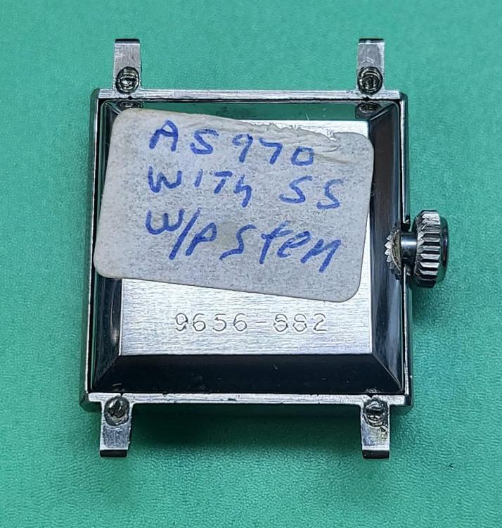

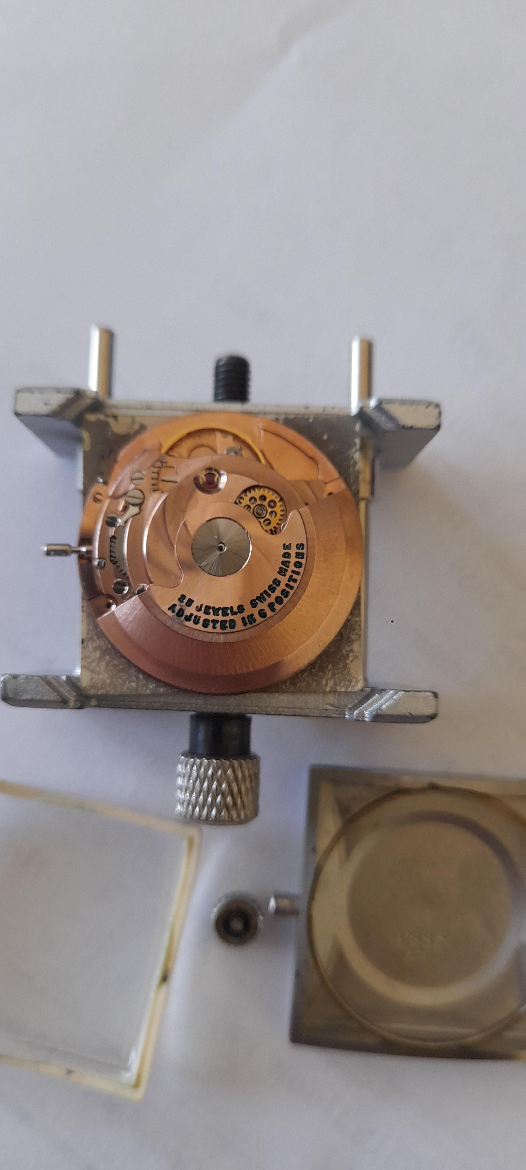

Hi again - no problem removing the crystal with a thin blade and the crown split from the stem easily so I was able take movement out of the case.
It is an ETA 2542 movement and is in very tidy condition and runs well.  My next step is just a minor outside clean and put it back in my collection.

Thanks guys for the advice - I've since had a look at the gasket edge under my microscope and there is a chamfer that could be an insertion point for a thin blade.
I'll try first using a  razor blade and hopefully get it apart.
I have an 'Empire' watch with a case like this. Mine is a split stem, so I first removed the crown, then the 4 small screws, then push on the crystal and the case back and movement will come out.
There was a seller on ebay about a year ago that was selling a bunch of watches with this same case but a number of different manufacturers. EDIT: he is still selling them. Here is a link with the movement out of the case.

Thanks for the info.
Yes, your watch is similar to mine with the 4 grub screws holding it all together.  Going by the movement, mine is probably from the 1960s. Yours looks a bit older.
I don't normally collect these types of watches, but I couldn't resist it as it was unusual and in great condition and only a few dollars at church thrft shop.
