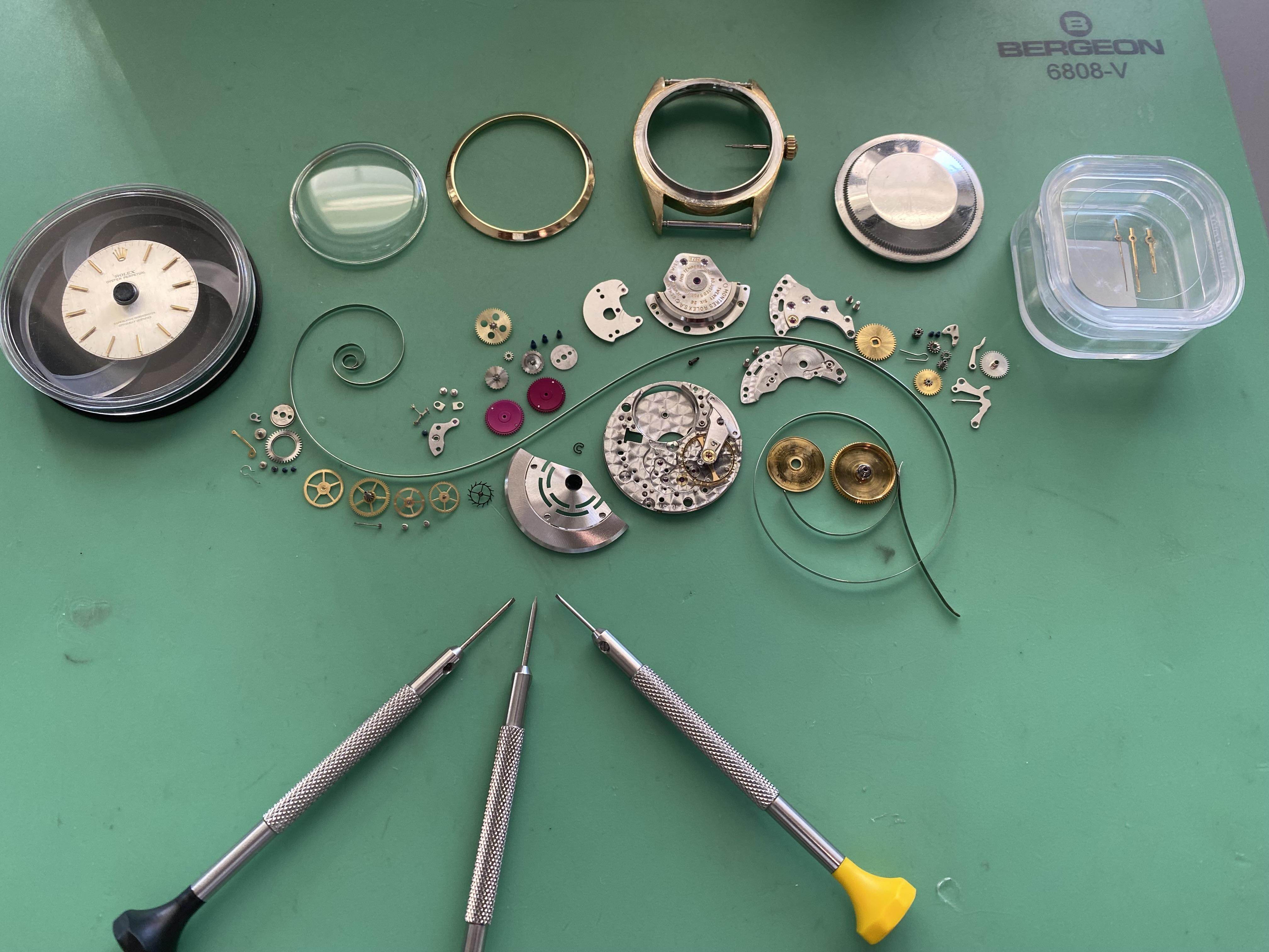

I'm currently working on a Rolex 1024 with a 1570 movement in really great condition. One thing which is a little off is however is the hairspring which I am noticing is a bit off center when the balance is mounted on the main plate. When checking out the hairspring, it seems like it's a bit kinked at the spot I have marked. However, I don't think this is the main cause for the off center profile of the entire hairspring when mounted. Can anyone with more experience see if there is something obviously wrong in another spot of the spring?
The reason I am asking is because I'm not terribly experienced on balances in specific. I feel like I am getting good at everything else but balances, I don't get to work on too often and it feels wrong to start on a Rolex hairspring /:
I don't really feel like paying for a replacement if I ruin anything haha.
Thanks in advance(:

Did you notice the watch is currently in pieces way up above? Not the first time on the group somebody's working on a Rolex with no Rolex knowledge. I'm looking forward to how the hairspring turns out.
How was it when you did the initial inspection before disassembly?
Can we see how it behaved on the timing machine / timegrapher or whatever you have before you disassembled it?
