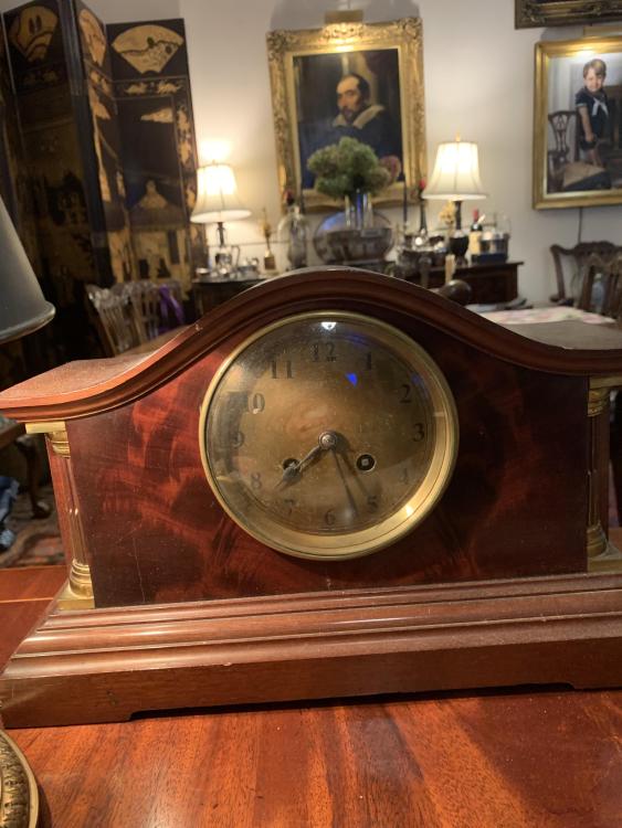

Now that the mantel clock is keeping good time, I have another question.  The clockface is a dark bronze and is quite hard to read even in the daytime.  How can I clean or lighten up the clockface.  I am afraid to use Brasso to clean the brass? and think it might remove the black numbers whicn are most likely just black paint.
Thx for your help.
Apart from going over it with cotton wool and dip it in warm water there is nothing you can do. You could have the dial restored by a dial restorer but then it might look odd against the clock case.
Don't use Brasso as it will remove everything on that dial don't use any abrasive.
