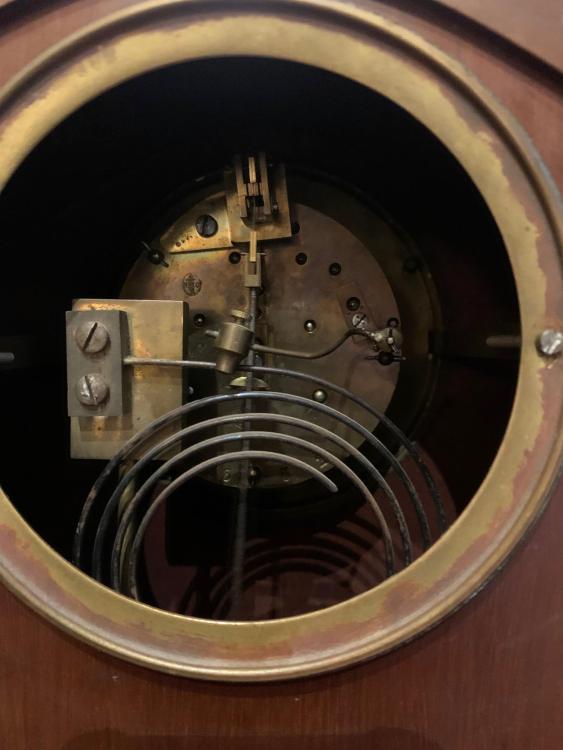

Gents - I received great help for my Schatz 8 day carriage clock and am happy that it continuously runs again.  Thx to oldhippy and a number of others who helped - I am calling that project complete.  Now seeking help with mantle clock.

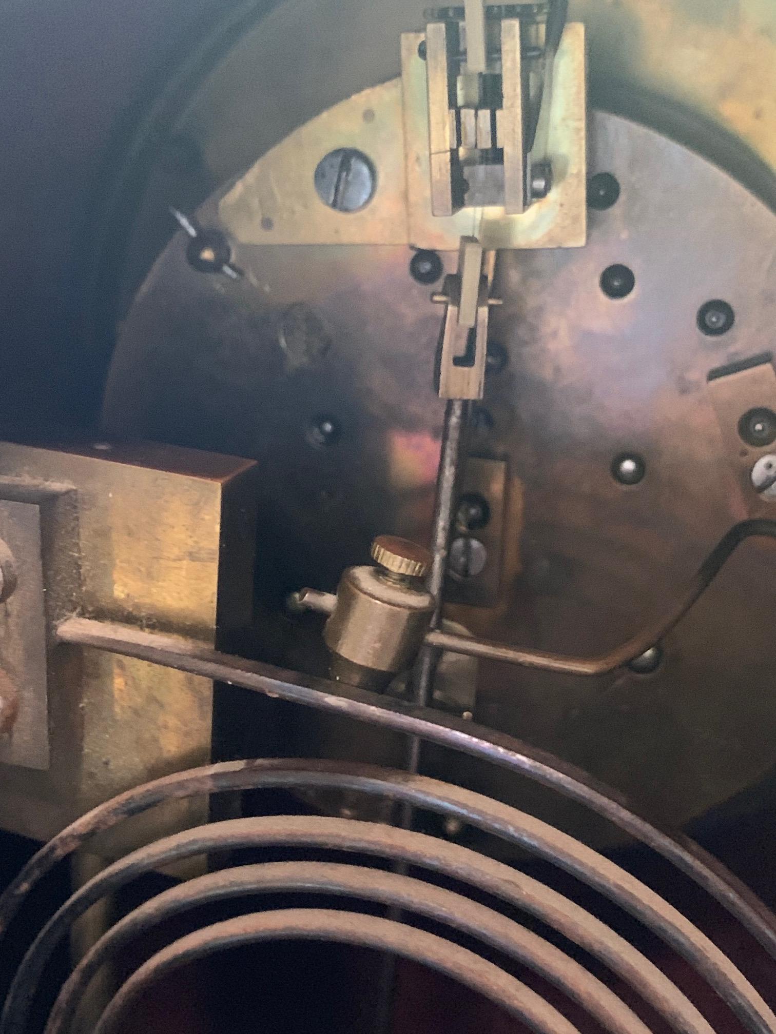

It does not run.  The backplate is stamped with a medical medusa or Caduceus with R on the left side, C on the right side, and (I think) A at the bottom on the rear place seen when opening the back portal.  It is also stamped 543352 at the bottom of the back plate.  I have included pictures.
I have it perfectly level, have just carefully oiled it, and cannot get it to run.  I am now keeping the pendulum moving enough to release some of the tension as it is wound tight with the key.
The suspension bracket (?) which holds the pendulum must be slanted upwards as shown in the picture for the gears to work and move the hands.  Strange - seems it should be parallel to the ground.
Can anyone possibly provide info about this clock, maker, age, etc.  - and ideas about how I might get it to run?
Appreciate your help.

Hi the clock is attributed to C.A.RICHARD &cie. Rue de Bonny,Paris Frankenriech 1867
from your description it sounds very much that the escapement is all out of kilter. What needs to be done is remove the movement from the case, and set on a level base with the clock level and see where it’s at, check the state of the anchor/ pallets for wear, broken or bent pivots and worn pivot holes,  In other words the obvious. Check the pallet locking on the escape wheel.   The state of the plates looks like it’s in need of a good clean and oil. Maybe a new suspension spring as any kinks bends or twists render it useless. Enough for starters,  but remove the movement set it up and then maybe more pictures especially of the escapement.   By the way it a nice little clock.

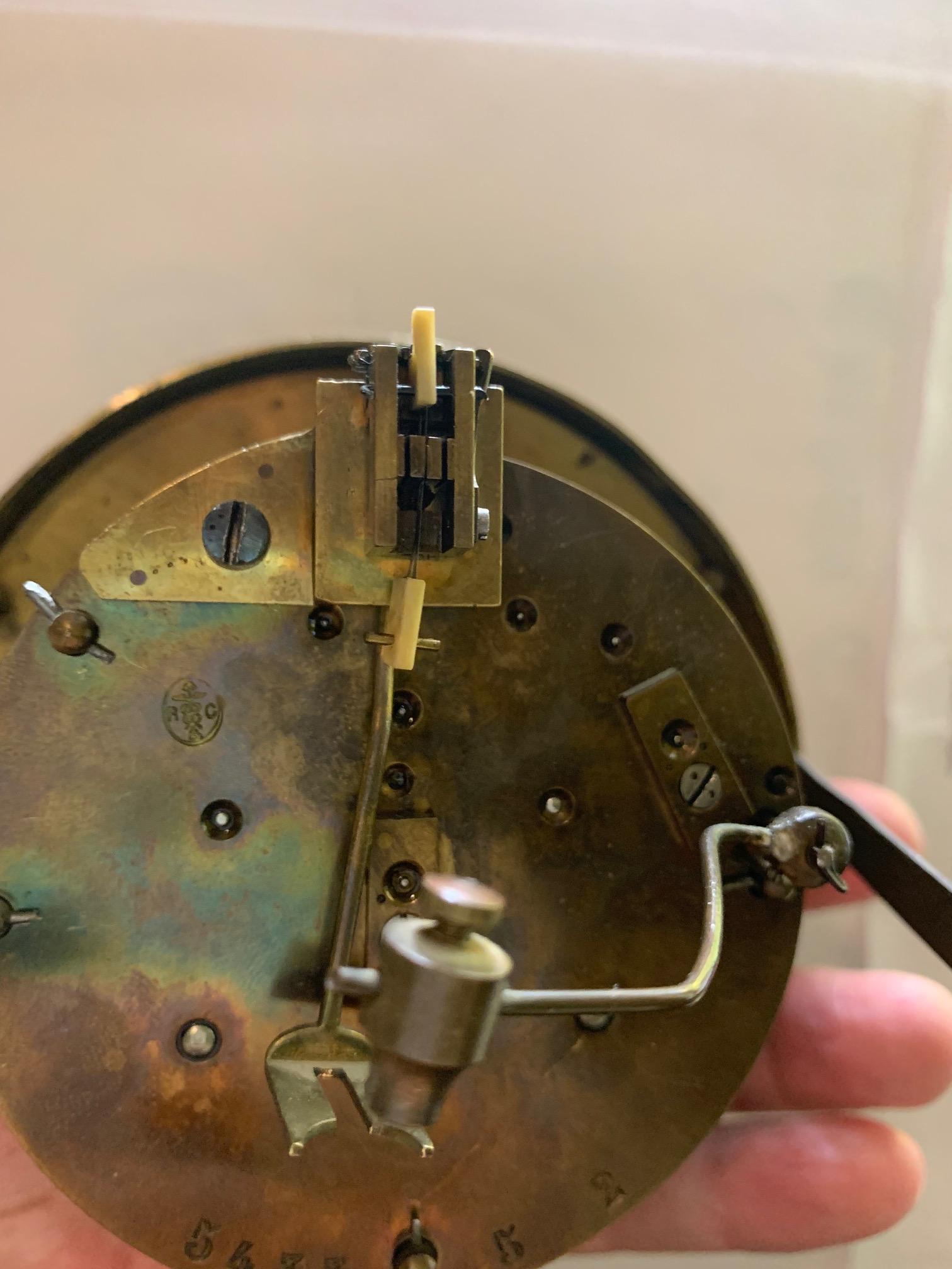

It is a French strike and it is filthy and I would say it is 8 day duration with rack striking. The suspension spring is broken (see photo) so it will not work properly. It needs a good clean. These movements are good quality and made in there thousands. It is late for me and I'm off to bed. I can carry on tomorrow explaining what and how to clean these movements.

Oldhippy - very good eye.  The suspension spring is in fact broken; the front leg is broken away from the plastic (foot-keeper?). And that explains why it spins a bit as it swings back and forth.  I believe it can be removed by extracting a pin at the top.  Is it possible to put a spot of glue on it?  Then I would test the clock to see if it might run.  How would one find a replacement?

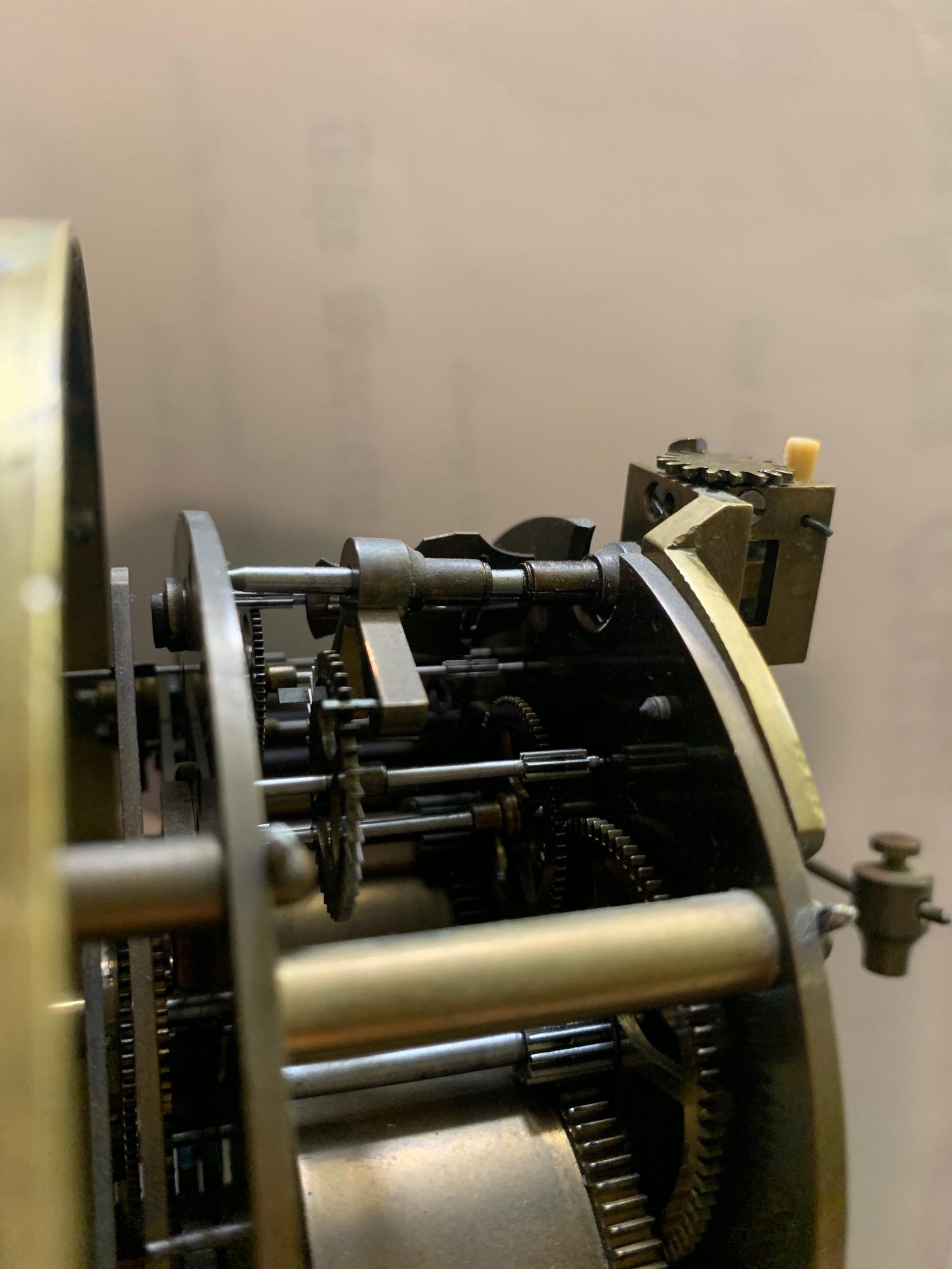

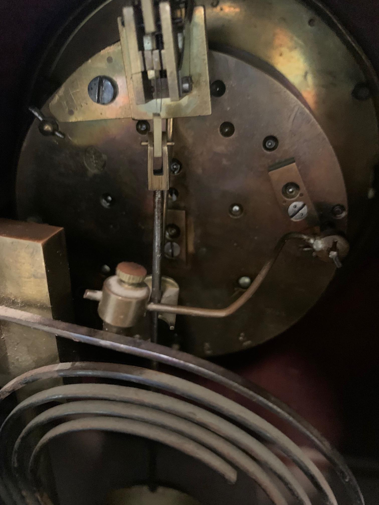

Responding to the first reply from watchweasol.  As a novice the inside looks very clean to me.  The pallets look good; I see no broken or bent pivot.  Not sure about pivot holes.  Can not identify the escape wheel; have not been able to find a schematic of the clock from the internet (appreciate the front schematic sent last night) - so I cannot comment on the pallet locking on the escape wheel - makes it difficult correctly to name the parts.
More pics below to show the escapement (?).  I had to angle it upward to make the clock tick and pics show it upward and also level or parallel to the ground.  When angling it up I notice the rear pivot does not appear to come out of the pivot hole but there seems to be some slight side to side movement and the pivot hole seems to be countersunk somewhat, not visible - I assume a very small pivot hole is below the countersink.
With the escapement level the pivot rod will not slide back and forth.  With the escapement upward this rod will move significantly - maybe 1/4 inch back and forth.
All for now.  And I appreciate the help.  So immediate question is whether I should attempt to glue the foot on the suspension spring.  Would be shocked to know that this is the only reason the clock would not run - but perhaps possible???

Believe I found a suspension spring.  Ordered it tonight.  This is a new suspension spring for a French clock movement.  Measures approximately 1 inch long x 3/16 inch wide (25 x 4.9 mm).  Brass fittings.

Hi. Your idea of glueing the spring is a non starter, it would impair the freedom of the spring. Best to replace it with the one you ordered for starters and see what happens. I take it you do not feel confident enough to do a full service/repair on this clock. The photo supplied bu OH shows how clean it can look can look done properly and realistically that is what it needs and by doing so will reveal any anomalies for example worn pivots and pivot holes, worn teeth , escapement, which can be then repaired. By not doing so and running the clock as it ( if we can get it started) it will only add to any wear and shorte n it’s life.  So a service is what it needs to be kind to the clock and give you the pleasure of it working well for a long time.

What is the purpose of the escarpment being moveable up and down?  Am I incorrect; should it really be fairly parallel to the ground and I have it adjusted way to up?  Looks strange but that seems the only way to make the pallet move the gear; cannot hear it tick even when parallel.
Hi as far as repair costs it depends on what the repair man finds. Worn bushes, worn pinions. Definitely needs a good clean up to standard of the one OH showed.  A friend of mine in the U.K was quoted £350  for a three train bracket clock .  Yours probably £200  to £250. These are only rough estimates, it may be considerably less depends on the repair shop and their pricing structure.
the escapement moves up and down to enable you to set the entry and exit locking on the escape wheel  one correct and the beat (tick/tock) is set even on a level surface it should work quite happily. As mentioned by OH it’s self beat setting due to the friction fitting on the pallet arbour of the crutch.
Update.  I replaced the suspension spring yesterday and the clock has run now for 17 hours.  It picked up ten minutes so I assume I need to make the pendulum a bit longer.  Attached is a pic showing how tilted I was required to make the escapement for it to run.  This was very, very, very touchy.  I must have adjusted it slightly, slightly up and down over one hundred times before it would continue to run; otherwise it would tick about 30-60 times and then stop.  The pic shows how much angle the escapement needed; this cannot be by design.
