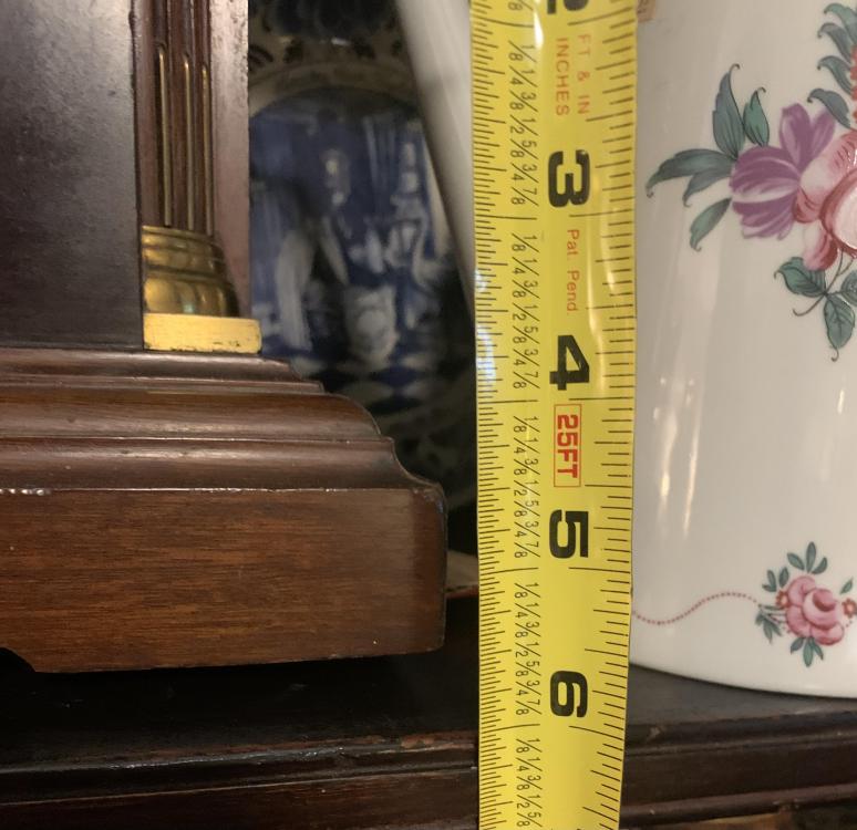

Mantel clock has run well now for several months.  However I am getting more picky.  The bookcase wherein it sits is slightly unlevel.  To make the clock run I have four pennies under the front right foot and it looks quite bad (to me).  The pics attempt to show a gap of about 5/16 inch necessary to make it run.
Conundrum - leave it this way or attempt to fit it to the bookcase.
Logic says I can loosen the two back retaining screws, remove the pennies, and twist the clock in the opposite direction - making adjustments until it is happy again.  However it seems that the dial would then be cockeyed with the 12 and six in a position to affront the eyes.
So should I leave the pennies under the front foot or attempt to fit the clock to the bookcase?  Or perhaps have I done something wrong getting it to run - also a possibility.  Cannot see how a clockmaker would be so imprecise that it will not run unless it is lifted up.
Appreciate your thoughts.  Pics attached.

Hi. The antique nature of the secretarie and the shelf makes it impossible to adjust. Adjusting the clock to suit the shelf is ok if it remains in the same place. Depending on the type of movement even that could be a pain in as much as the dial alignment.  I have the same problem with my 400 day clocks. Setup and working on the bench, when put in the cabinet they stop as it’s not level so unless I set every clock to the shelf they won’t go so they remain stopped.    I would be tempted to leave well alone, ok not perfect but working.
How about a small plinth of dark stained wood, just big enough for the clock feet or frame, with either an overall taper or wedges adjusted to level the top and then glued under the edge as needed?
Add some self-adhesive felt or baize once it is set up, to avoid scratching the top of the cabinet.
It should be virtually invisible on top of the cabinet, from what I can see in the photos.
(There are places on ebay that sell eg. Oak offcuts planed to 8mm or 10mm, which are perfect for making small stuff like that).
Excellent feedback.  Going to give it some thought. Wife likes the clock in the secretaire so not going there.
I did take it down and shorten the pendulum recently and it took over a week of tweaking to get it to run again.  At this point I am considering letting well enough alone.
