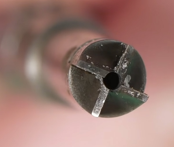

End mill for removing solder
By nevenbekriev · Posted
This is a flying cutter, usual one. The cutter itself is shown in the pictures in the first message, it is made of broken tungsten carbide drill bit. I asure that all the angles of the cutter are as they should be. I have video - little older one - that I made when onse making the same kind of winding pinion for a Poljot 2200, which is even smaller than this one. It is not easy to see in the video, but the tool rest moves about 1mm towards the object in Y direction and then returns back untill cutter is rotating. Then the spindle is rotated one tooth ahead and everything repeated untill all teeth are cut. -
