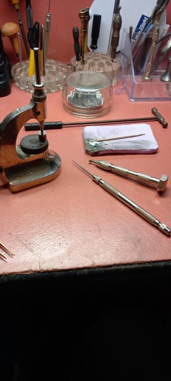

Hole closing today on the barrel and lid of the Raketa that had too much sideshake. A bit more to it than plate hole closing and more than i expected, these are my thoughts so far. Choosing the right stake was important, needing to be small enough to reach into the sink holes to squish material. Too big and you are just hammering on the flat surfaces and compressing to big of an area . So using a flat stump and a domed stake a couple of sizes above the hole diameter. I decided to work on both sides to reduce the hole, thinking material pushed from both sides would give a longer lasting repair in addition to the compression of material through the process of peening. Hammertime over and time to test fit the arbor and broach out as required. Marking the barrel and lid's depth up the smoothing broach with a felt tip pen helps to judge how far to open out. After a few trials i thought the right size would be as the arbor only just fell out of the opened hole when tipped upside-down. The broaching leaves a slight burr on the outsides of the holes which i removed with a curved burr tool as i dont have any sink rollers. This in turn leaves a burr on the inside which needs broaching out again. After a couple of gentle back and forth the burrs diminished to nothing. One issue i think that may happen is one of increased endshake from the arbor inside the barrel. This could be caused by the flattening of the two rims inside the barrel and lid. I'm sure this has happened as after peening the inside rims which created a chamfer and then peening the outsides of the holes, that chamfer was reduced in size and a flat rim was reformed. My only conclusion for this was compression from the flat stump while hammering. Peening the outside of the hole first or only may reduce this problem. With holes resized the last job was to polish up their insides with a loaded toothpick and autosol. Yet to improve with polinum and polinox on its way from cousins. Final check tomorrow with reassembly of the barrel, lid and arbor. These are the results so far, notice the line through the centre, this is the original untouched brass surface. Also the tools used and flattened rim of the lid

There seems to be a lot of wear on the barrel lid. Has the mainspring been coned?
The contact area seems so small after punching it. I wonder how long would the repair last.
Is there a more permanent solution, like rebushing the hole or making a new barrel cap?
Actually I do recall a Russian movement with excessive endshake and sideshake. It was so bad that the watch stops when turned dial up.
There doesn't seem to be much visible wear on the arbor or barrel holes. My diagnosis was a wrong arbor. After all, we all know how much arbors like to take flight.
I left it alone until my skill level would permit me to turn a new barrel arbor.

Yes hector there is heavy wear inside the lid from the mainspring, althought it isn't particularly coned. The contact area of the lid rim is much thinner than originally so one reason not to peen the inside. This was then flattened again while working on the outside, so I'm sure the endshake has increased. Rebushing might be beyond me at the moment but is certainly a better solution, and could be my next answer to fix the excess endshake ive created.

The tolerances on rekatas seem too quite large, the barrel on this wobbled so much that it could touch the mainplate.

So reassembly of the barrel and lid  and the end and sideshake are now minimal.  A gentle push with a fine artists brush and the barrel spins for a few seconds. The barrel tilts one or two degrees from its resting plane around the arbor. The hole on the mainplate also closed up fine, but the barrel  bridge has a steel bush. This has the most side play 😒

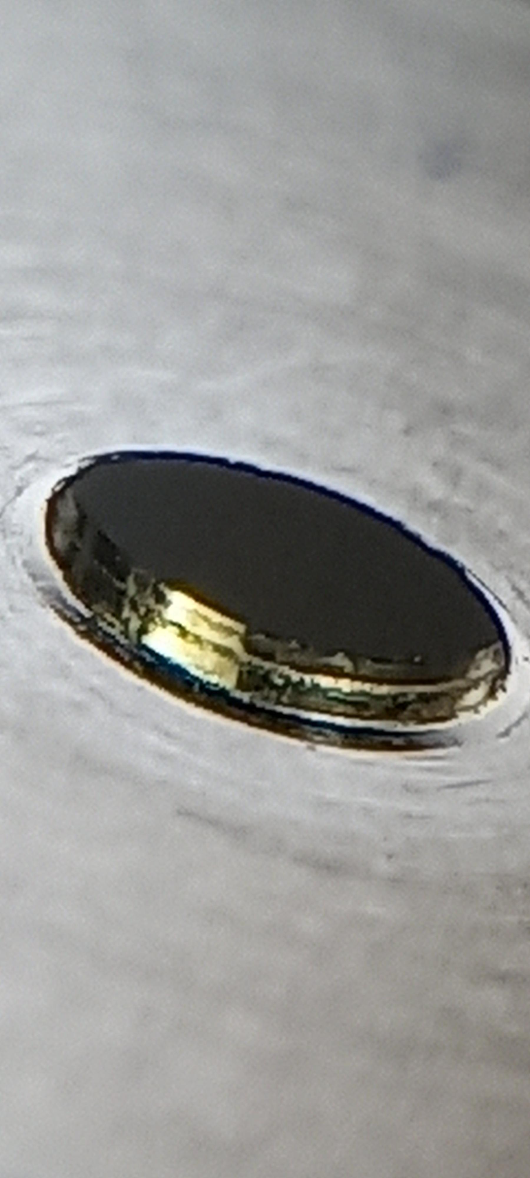

I've been reading this thread with great interest. I also just closed barrel holes (and barrel bridge).
The famous Kalle Slaap/ Chronoglide video (https://www.youtube.com/watch?v=T2O6z1Nra0I&t=68s) does not mention the polishing the inside of the hole (polinum etc). In the video, Kalle seems to only use the smoothing broach - and done.
What you do, @Neverenoughwatches, makes sense, though. Is it standard procedure?

Not sure if its a standard proceedure, just seemed logical to polish the inside to reduce friction. A toothpick initially with autosol which does polish quite well, the polinum might be overkill but i had it,so why not. At that level of grit very unlikely you are removing noticeable materialand only takes a minute.  Since then i have seen others do very similar.

I'm not conversant with that product, whats in it ?. I figure you have to be careful with what is used,so an abrasive paste🤔. Autosol i  think is aluminium oxide. There is always the possibility that the material being polished gets charged with an abrasive compound.  Maybe a reason that kalle only uses a smoothing broach. I have seen discussions of folk using pin polishers on arbors and balance staffs, is that ok? They are hard materials,  whereas a brass barrel and lid is soft  comparison.  Maybe more discussion is needed on if and what to polish with.
I wasn't taught in either of my schools to polish the hole in the barrel/lid, only smoothing broach. As the barrel is brass or similar, there's a very real chance of charging it with whatever abrasive is used. Even if very fine that will wear the arbor over time.
