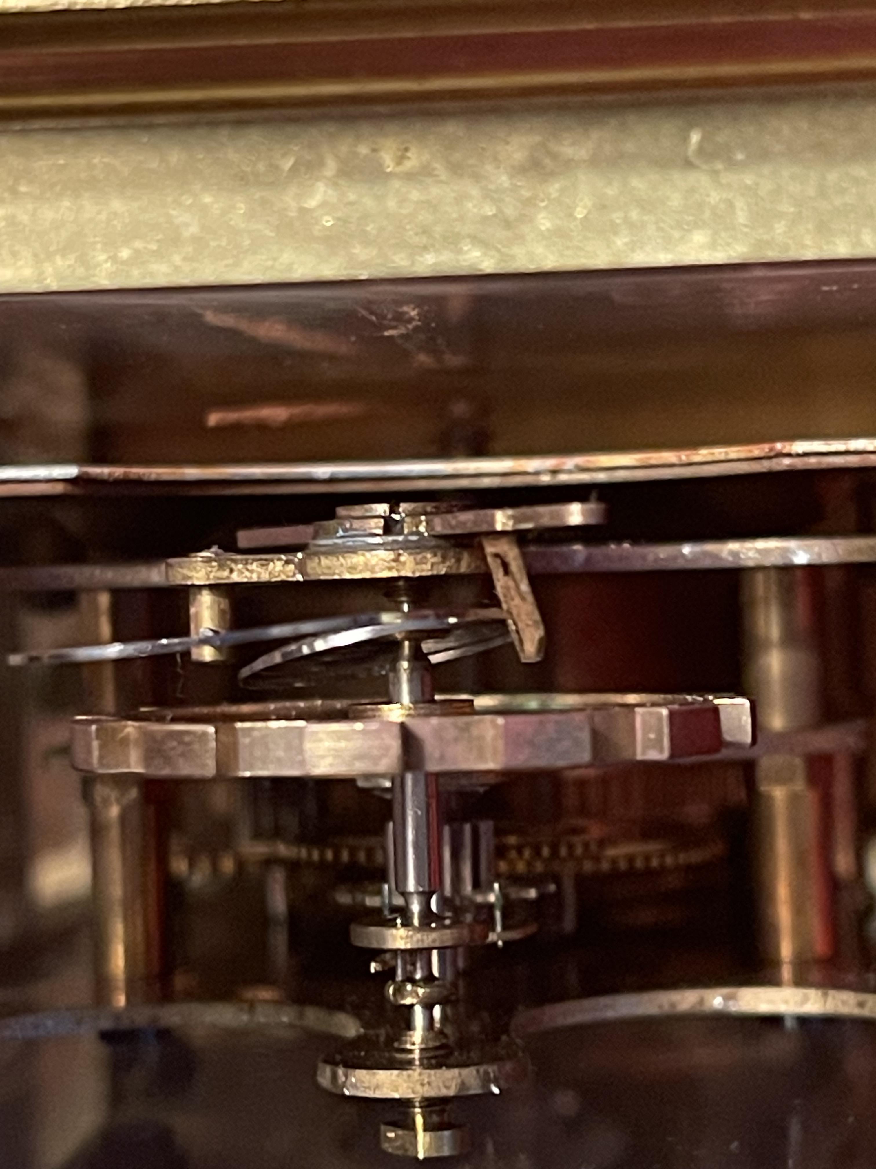

I need to see a photo of the hairspring going through the regulator before I can say if the regulator is complete or broken. Can you post a nice clear photo of it please.
Gained eight minutes overnight.  I am trying something different.  Moving it to -45 degrees or to the left (toward the + marking) and leaving it at the 9 o'clock point.  Will let it run for a day and see if it slows down.  Maybe I have been adjusting it the wrong direction as I see the hairspring getting tighter when I move the regulator to the right (toward the minus sign).
I had moved it to the right as far as it would go and the hairspring was very tight.  So I am moving it to loosen up the hairspring and will see what it does.
Appreciate the help and comments.

The hairspring appears to go through a slit in the regulator tab (see pic and question below).
If I do need to disassemble the clock, can it be done from the back without removing the face?  If not, are the hands a press fit?
Assume the response about spring letdown is if I need to disassemble?
So here is where I am now:

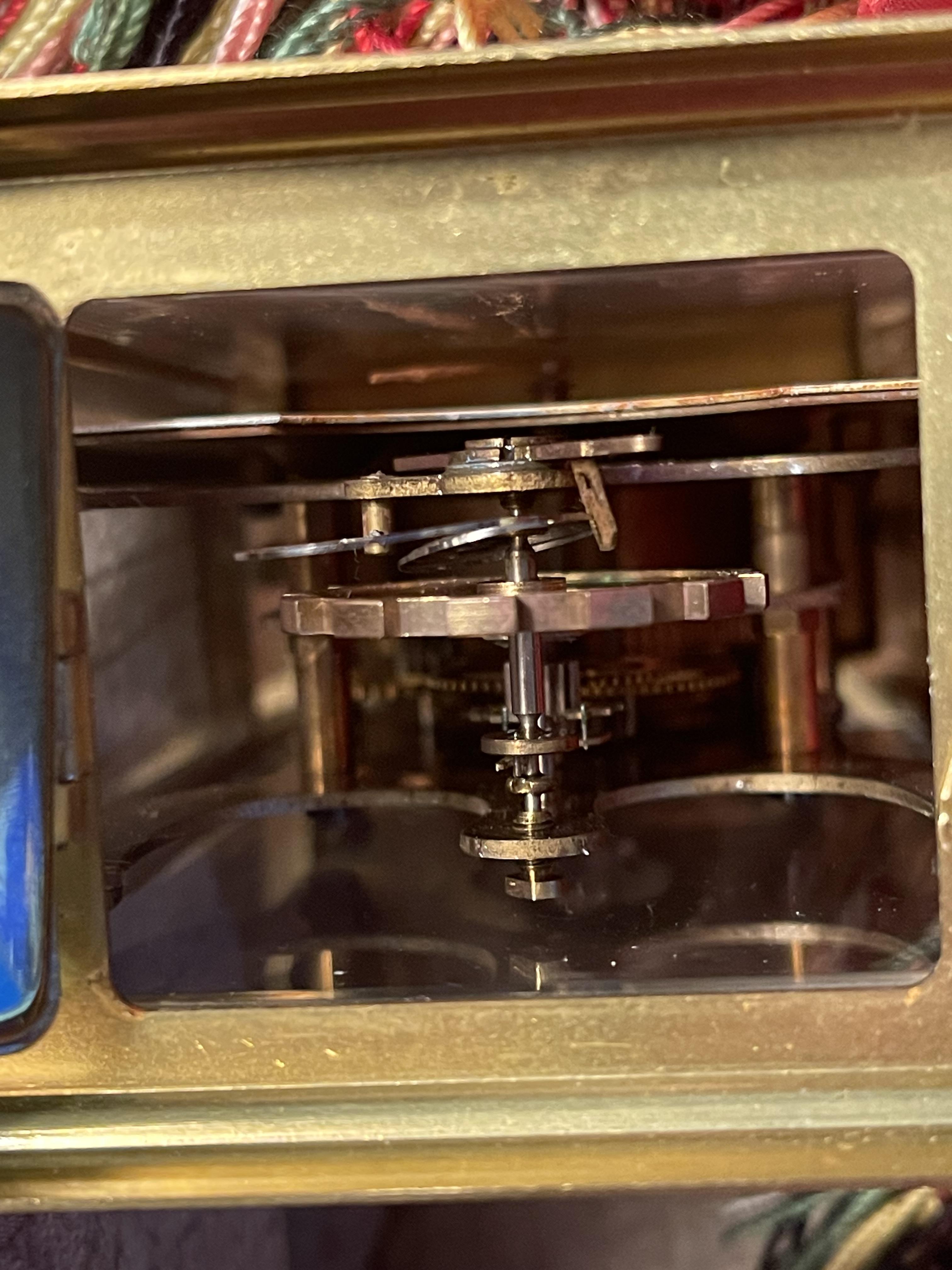

Disaster.  After moving the regulator negative 45% it has now completely stopped running.   And I think I heard a thump or felt a thump when adjusting it back to 0 degrees.  Wondering if the hairspring just got cockeyed or jumped a loop as I was readjusting. Hairspring is not (no longer?) perpendicular to the ground; in fact it slants (see pic).
And I find a greater length of hairspring between the slotted regulator tab and the permanent end of the spring - not sure but I do not remember seeing this much hairspring actually extending past the perimeter of the "balance wheel?" before.   I do not remember seeing this kink.   Is this normal?  None of my earlier pics is clear enough to see.  Did I release a coil of the hairspring by mistake?
Regulator tab question.  The hairspring appears to pass through a slit in the regulator tab.  However there is a cutout at the interior end of this slit and I wonder if the hairspring is supposed to be in that cutout instead of captured in the slit?  Could this be what I heard?  Or does the hairspring slide back and forth in the slit with length adjustments?  Should I push it over to the cutout? Does it need oil?
Pictures below.  Again your help is much appreciated.

So you’ve flexed the hairspring,it’s easily sorted but I know you’re not confident in stripping the clock so I’d reframe from messing any more until you strip the mechanism now.
As for stripping yes you’ll need to remove the dial, the hands should be press fit, once the power is off the mainspring away you go taking it apart, if you want to see a rescued hairspring look on my Instagram under white_time_horology
I had a mangled one on there that I rescued.
The hairspring is in a mess. You need to unpin the hairspring then feed it out of the regulator then remove the complete balance by unscrewing the cup on the opposite side to the regulator, then you can start to re-shame the hairspring. I think you should just put the clock to one side until you have gained a lot of experience.

Pics of hairspring somewhat flatter and somewhat more round.  Do need to work on the roundness more?  There are a few places where the spacing is not very good.
Thx for the help.
That should say do I need to work on the spacing  or roundness of the hairspring more.  Fingers faster than brain.
Thank you for the advice about unscrewing the cup on the back of the regulator.  Worked like a charm
Doesn't look too bad. Now you'll need to take note of the position of the collet on the balance staff and remove the hairspring from the balance and lay it flat on a white surface. I use an old watch crystal on a piece of paper.
Work on getting the spiral evenly spaced first, starting from the centre and working outwards. Keep the spring in a flat plane, don't develop any twists.
For the endcurve, I like to mount just the spring back on the clock plate, threading it through the regulator. I will form the stepped crank near the stud first by moving the regulator towards the hairspring stud, as far as it would travel. Then adjust the spring until the collet is centred over the balance pivot hole. Then move the regulator in small increments and repeat centering the collet.
This is best done with the plates disassembled. But to do that, you'll have to learn how to disassemble a clock. That's another story.
Got it.
How close does this hairspring need to be to work properly - does it need to look machine perfect?  Not sure I can do that.
Being OCD, I would probably spend hours trying to get it as perfect as possible. But practically, as long as the coils do not touch each other at full amplitude, I think that would be good enough.
