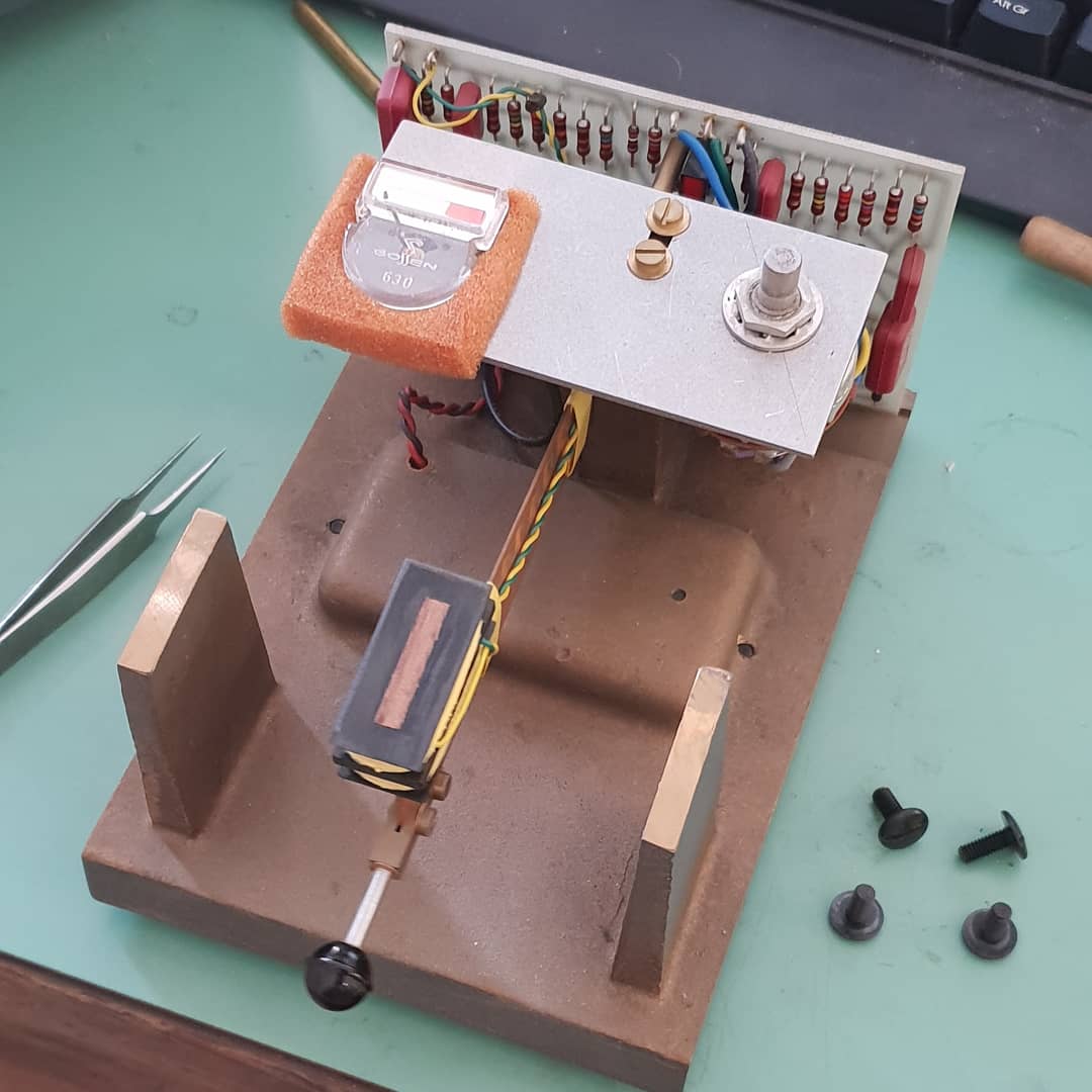

Otherwise, back when the Magnomatic was designed Greiner also made the Magnotest, a really cool device that will detect any magnetism at all. It's so sensitive that even "fully demagnetized" steel , even a tiny steel hairspring, will register something at the high sensitivity level. There's a modern version, Magnotest II (not cheap of course), and a slightly cheaper one from Horotec, about 650 / 450 respectively at Cousins. The current Magnotest says in the manual to turn it on for 20 minutes before use; I imagine so that it zeros out to its environment or something?- but the old one, with it's massive bronze core, works instantly.
You put the part on the window (where the dime is, dime for scale), then flick the lever at the bottom, which passes a coil back and forth under the part/watch. If there's magnetism the meter will indicate it, at level one it should remain motionless. Any magnetism will show as it rises toward the red. At level 2 it will register a little for any steel- I think it's to help see through thicker cases or something, but not sure. I'm sure Frank or Littlewatchshop can explain what's going on. B is battery check, for the 9v battery it runs on. Heaven forbid it get's left on, battery dies in a day or two!
Edited by nickelsilver

Yes, I have a Magnotest, too and wonder how its old electronics still works fine. Its action is like a generator or a bicycle dynamo: a magnet passing a coil will generate a voltage.
I used it to show that Nivarox hairsprings can be magnetized here.

As to Greiner and their old stuff, I am quite amazed how solid they are after many decades. Were they using Mil-spec components or something? And they made some cool stuff. Just got a Greiner mic that apparently does 6 positions automatically; not sure how it works (can't get it to do anything other than light up), a quick look inside topside shows a Greiner favorite, a Cerberus thyratron tube... haha.
similar to their old hairspring vibrating unit…
Result was, they can be magnetized (hand fully right on Magnotest on position 1). And also fully demagntized. Rate was fast after 2nd magnet application however. After demag the before rate was fully restored.

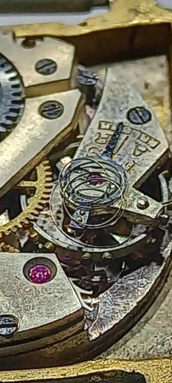

For the time being I'm practising HS-manipulation whatever little time I have left over after work and family. Ay caramba, it is challenging! Especially when the spring is neither flat nor round.

Yes, sort of, especially when you succeed. One of the springs I was using for practice was also entangled, but I managed to take care of it after having studied the technique used by Henry B. Fried in the following video. I was actually surprised to see that it was relatively easy.
I remember watching that about a year or so ago. He certainly doesn't pussy foot around with them. Its surprisingly how much punishment a modern spring can take can. Something old can fall apart just by looking at it. I had this a couple of months back, it remarkably survived quite well.
