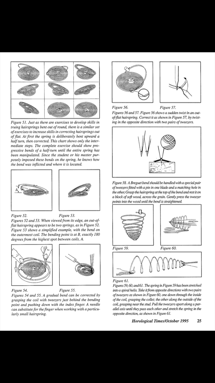

Hi I have more of a question I have an issue where the balance  spring is stretched out of shape but the balance itself is ok  is there  any way to replace the spring
Another skill that needs to be learned is how to fix your hairspring. Of course the first step is identify what exactly is the problem know how you'd need to fix the hairspring. There are books that talk about this there's also some videos. Ideally you want to get a scrap balance wheel or two or three and practice bending your hairspring there it's a thing you need to practice every single day to be good.
In order for watch to keep time to balance wheel and hairspring have to be matched to a very very close tolerance. This means in the case of flash hairsprings every single hairspring was vibrated for the specific balance wheel with someone. So if you look at the parts list there is no hairspring balance complete only
The exception to this is an over coil hairspring. To get the over coil in the correct location it's easier to pre-make the Springs to exacting specifications. But this means the balance wheel now has to be matched hairspring. Severe looking at American pocket watches in their parts book you always see timing screws. This way you can match your balance wheel to your new hairspring.
Then here's a link to the video or one of the videos have the same person wrote like a lot of books and one of them at least one of them has an entire section on hairspring fixing. When you're watching the video I would get a practice balance wheel because he is really really experienced any makes everything looks so simple and if you don't practice well after outcome might not be quite what to expect
The Sep 1995 issue of the Horological Times has two articles on hairspring manipulation by Archie Perkins and Henry Fried. The October 1995 issue has the second part of Fried’s article.
My copy of Fried’s bench practices does not have the chapter on bent hairsprings which I believe these two issues reproduce.

1 hour ago, Tonym199 said:
Thanks for the info but the spring is destroyed do you know how to replace the spring ex connect a spring to the balance wheel
The reason why we practice on practice watches is because their disposable.
Now you need a balance complete or steal a balance wheel out of another identical movement. You cannot replace the hairspring as a separate component.
