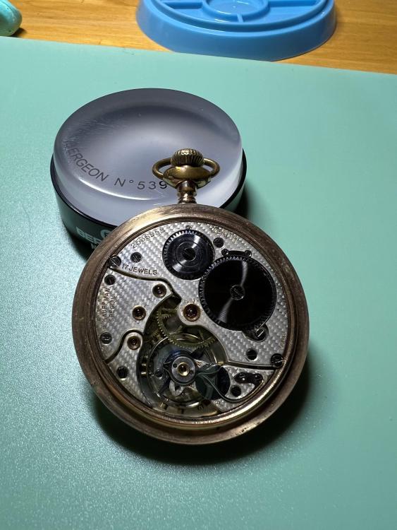

I've recently started my journey of learning this wonderful hobby.  I purchased a pocket watch from ebay to practice on and I am having difficulty finding any information about the movement and I'm hoping someone can point me in the right direction.  It is a zenith 17 jewel movement and the serial number is 2536958.  R. Kaufman special is also marked on the movement.  I searched the pocket watch directory with no luck.

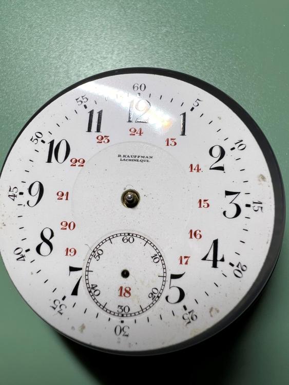

Here is a picture of the dial side.  I did not get a picture with the hands on.  Tonight I will measure the movement.

Glad to see you are familiar with  Zenith brand,  though you didn 't ask this should fetch easy $400 when fixed.
 I think its caliber 10.5NSI.
Good luck
Dr ranfft lists many Zenith calibers, google should bring you this caliber plus bunch of relevent info. just google,
Zenith  10.5"' NSI   ranfft
 It should tell if there are different bridge layout to this caliber.
Good luck pal.

For future reference when people asked for dial side photos they went a dial side of the movement not the dial. There's stuff under the dial which can be used for identification purposes but we can't see those of the dials on and of course we need the size of the watch. This is because the book we would look at that lists these lists the watches by size and if you do go through looking for all the setting components and not knowing the size well basically people will do that for you so you got a help out here. Then sometimes you're lucky they mark on the dial side of the movement what watch you have sometimes.

Finally got back to looking at this.  The movement is 42.5mm and here is the dial side picture.  Again, anywhere I look using any of the numbers engraved on the movement turn up limited information.
This dimension makes it around 18 to 19 line movement. Here's one that's close not exactly the same though.
http://www.ranfft.de/cgi-bin/bidfun-db.cgi?10&ranfft&0&2uswk&Zenith_19_5
Similar designs still not right and diameter is much bigger.
http://www.ranfft.de/cgi-bin/bidfun-db.cgi?10&ranfft&0&2uswk&Zenith_20_5_NVI
One of the problems with identifying watches on this discussion group is we didn't get a diameter. Now that we have a diameter you'll notice that this watch is about one half the diameter size ruling it out as they watch. Pictures of watches can be so misleading which is why we need sizes
http://www.ranfft.de/cgi-bin/bidfun-db.cgi?10&ranfft&0&2uswk&Zenith_10_5_NSI

Just copy and paste everything @Mike78 said and you've got my story too. Made a random eBay purchase to practice on and ended up with a gorgeous Zenith Half Hunter from 1916. I have successfully stripped, cleaned and serviced it, just waiting for a case spring I ordered from the US to arrive to replace the broken one it came with.
I do have a question - a tiny screw (arrowed in the second picture) which is NOT to release the stem. It doesn't quite protrude into the cavity where the winding gubbins live, so unless it has lost its tip its purpose is a mystery. Any suggestions welcome.
