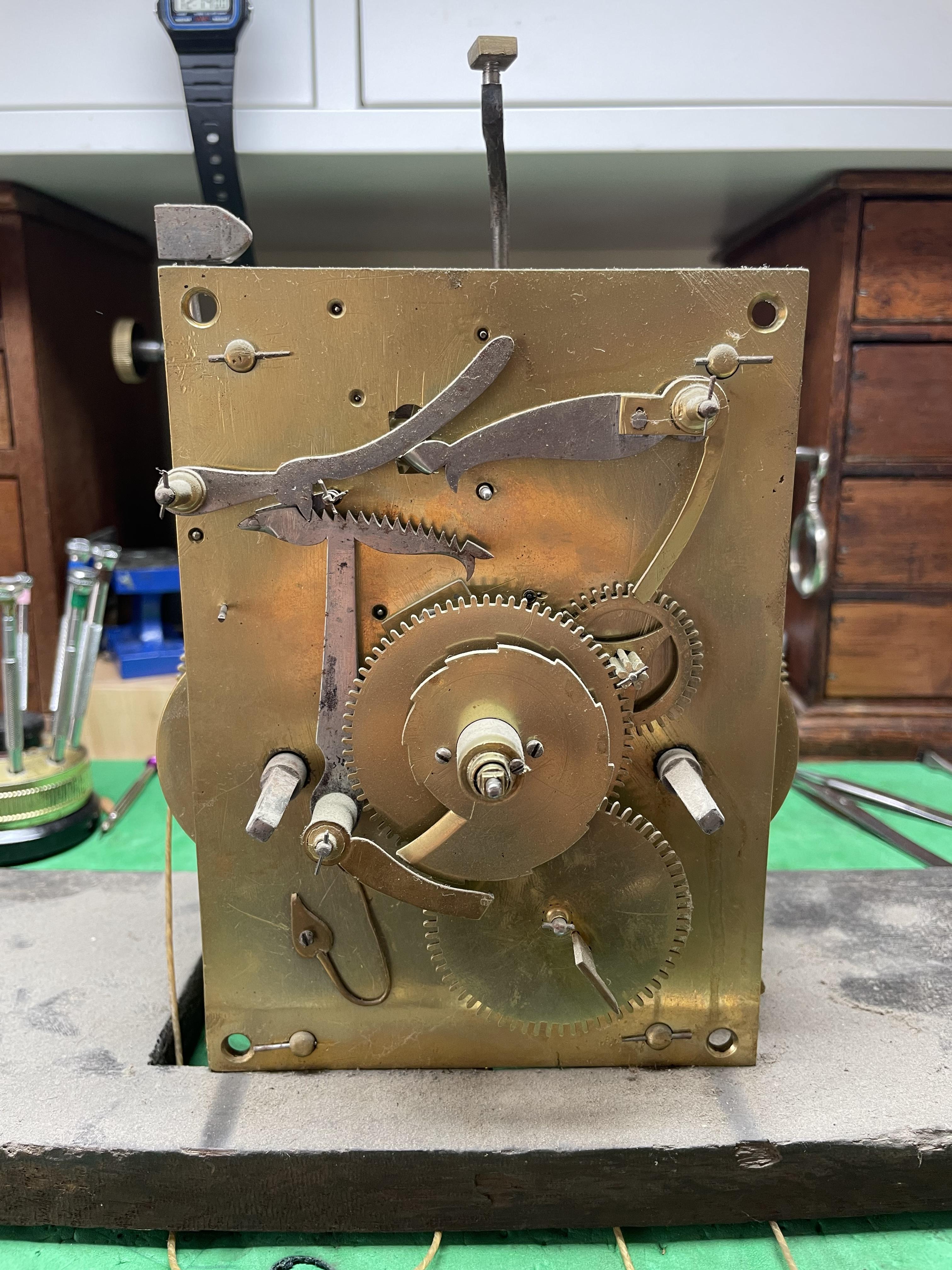

Ok here goes, 1700’s strike movement, serviced including a few bushes required. End and side shake all good on all arbor assemblies.
New gut line fitted and all is well, that is until there are 8 winds left on the going train great wheel.
When it gets to this point it stops! Been on test for 3 weeks and it stops at the same place each time.
There is power going to the escape wheel as if moved it flicks back nicely, if I swing the pendulum it will tick for a few minutes max and then stop again.
Im going to remove the dial and hands tomorrow and see if there is a problem around the motion works etc. Although as the movement runs for a good 4 days without any problems striking correctly and keeps fantastic time I’m at a loss as to where else to look for a possible problem.
So over to the forum members for any other experience on what else it could be.

It's been some time that this clock has been serviced just look at all the dust. The barrel arbor on the strike side I can see light through it so some wear there. A full service is what I recommend. If you just want to try and sort out why it stops, I would just have the going train working, when it stops you have very little to look at to pin point the problem.
It’s actually been 4 weeks since it was serviced!these photos are just for reference.

4 weeks and all that dust? hasn't it been in its case. To save time I think it will help you saving time if you just have the time side going. What are the pallets like, escape wheel teeth, any burr on them, check all teeth, pinons, pivots and pivot holes, make sure the pivots are burnished. also check that all of the train runs evenly as this can cause the depth of teeth and pinon to mesh wrong this will cause hang ups. By doing this you do not have the hassle of wondering if the strike side has anything to to do with the stopping. Make sure it stands on a solid floor and not on carpet or near where people walk by.
The photos are before the service, all required bushing has been done and pivots polished/burnished .
Escape wheel teeth fine, pallets polished.
The movement is on the test stand in my rest room and not disturbed. It runs fine keeping good time and striking as it should with no stoppages for 4 days then stops with 8 turns of gut line left on the great wheel.

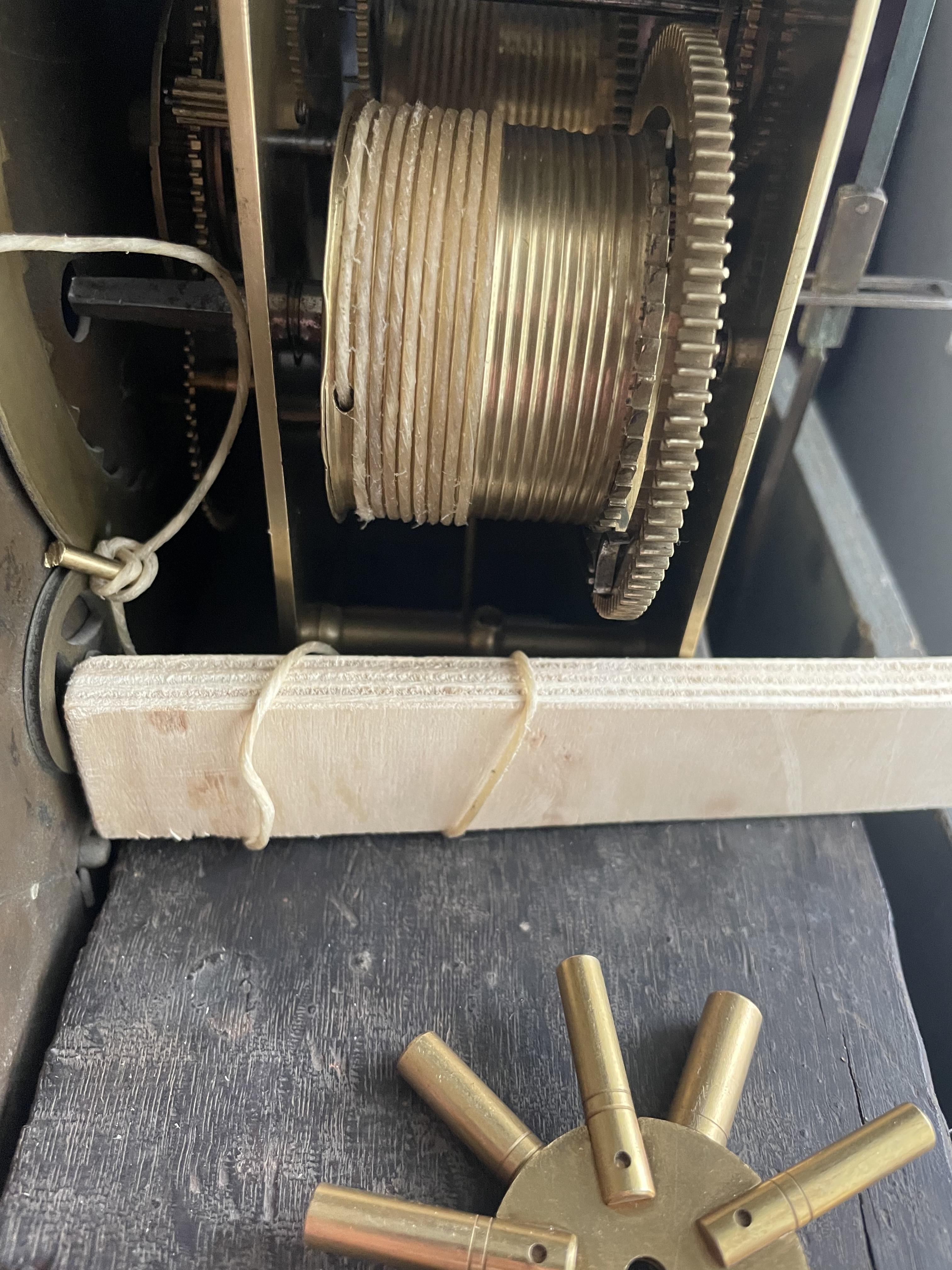

I have if you look at the photo wound the free end of the gut line around a piece of wood ( thus shortening it by a few inches ) and started the pendulum again and it’s been running now for nearly an hour with no dramas????

Lines should be the correct length.  You can use a piece of peg wood and tie the gut around it so the line won't slip through the hole, it is not the way I would do it but I can't put into words the way I was taught. What you have looks very messy. I always used nylon coated lines as I can see the gut is already fraying.
With regard to this, both lines are the correct length. And yes the tying off of the line is the usual loop over loop with a bite to hold it in place. The rather untidy job I have done there is a 2 sec. Experiment which seems to of got the train working all day today since I lifted the weight be approx 2”.
As for The gut line fraying it’s brand new from cousins and has been on the clock for the 4 weeks of testing .
