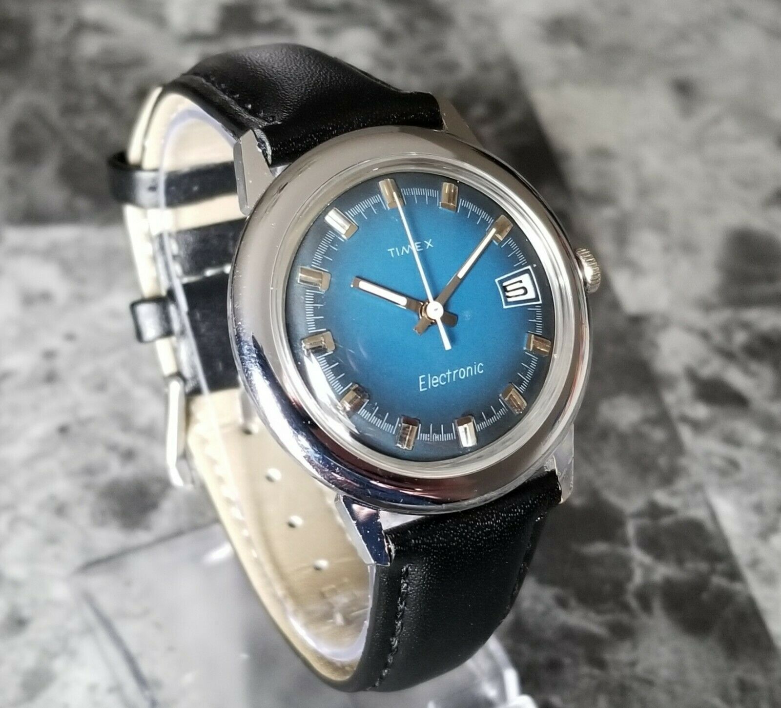

I have two Timex Electronic watches. They will both run if you twist the watch fast in your hand but then will stop. Both have new batteries in them. Is there something I can do maybe oil the bearings or is there nothing I can do to get it running again. Thanks.
Hi Can you post some pictures of the movements along with a little history of the watches please.  There are many reasons why a watch stops, the common ones are dirt oil oil congealed oil both of which require the watch to be cleaned and relubricated. without being able to see the watch/s in question its just guess work. with pictures members will know the model and the possible causes apertaining to that model.  thanks
there different version of Timex watches with Electronic on the dial.   so it would help to see a pic.  but, in general the issue could be a bad circuit board, open balance coil,  poor continuity and so on.
Both are M40 movements. One I bought a NOS Timex replacement movement and changed it out. Worked for a few months then does the when I twist it like you do to get an old pocket watch balance wheel moving it will run for 3 to 5 seconds and stop. The blue one ran great for about 9 months. I have never tried to clean it. I have done several Timex Marlin movements, I think they were M24s I could be wrong but I have taken those down and put them in the Timex recommended lighter fluid, then sonic cleaned in alcohol and used Mobius to oil the friction points.  But I have never messed with the M40s but to change them out.

based on the pic you have an M51 and not M40.  What makes it electronic is the integration of a diode to the balance.  Yes, not so much electronics as it sounds.
short of a full tear down any other method is more of a short cut.  Which is fine as long as you don't run the watch all the time or just enjoy wearing a vintage watch more for the look rather than to track time.    I would recommend not to leave the watch running when not in use.  Maybe even remove the battery if they will sit for long periods of time.
