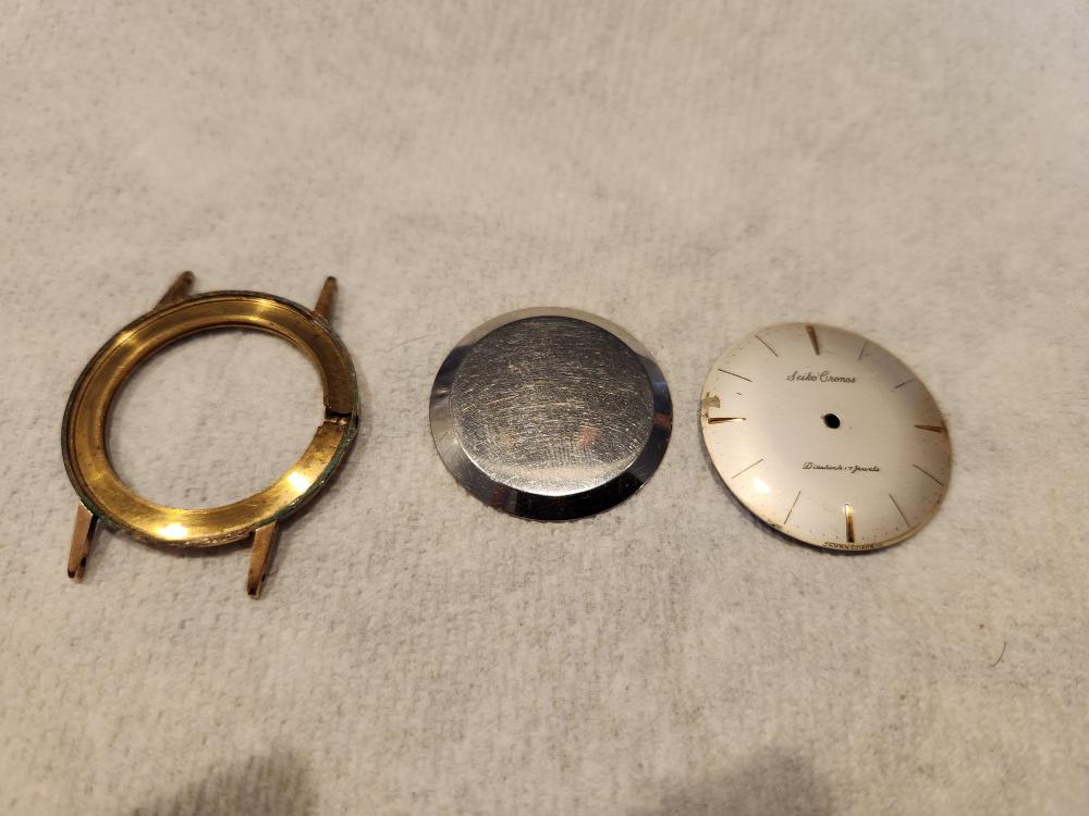

Well I do like the sound of a cheap option! I'm having trouble identifying this movement to search for the part, any idea what it is? The case back is very worn but I can barely make out J14028A, and the inside of the case back has the number 910047. I tried searching for all of these online and they do lead to seiko watches, but none of them resemble the watch or movement I have. The only text on the movement itself that isn't visible in my initial post is C29 underneath the balance.

Even if you have somebody who's experienced there's a problem? Were still missing some key information at least we got a nice picture of one side but we still need a picture of the other side. Also we need the diameter the movement and for that I've attached a PDF. Typically diameters of movements are not measured in millimeters Okay you measure in millimeters but you look on the chart And then you give us the ligne sizes.
Then the reason why we need the dial side is for a time span of I'm not sure how far back and how far into the future went but was a time span where all the setting parts of the watches are unique. So if you have typically a Swiss watch you know the size into what the setting parts look like you can look in the bestfit book an attempt to figure out what watch you. I did look bestfit book has some Seiko watches so may be but even if we identify there is no guarantee of parts because this is a vintage Seiko or be technically correct a vintage pre-Seiko watch. But still it looks like a nice-looking movement it be nice if we could save it.

The closest measurement on that chart seems to be 25.942mm or 11-1/2 lignes. I've attached photos of the other side of the movement as well as the measurement. Maybe I should repost this in the 'identify this movement' sub-forum?

Okay looks like it's about 11 1/2 size let's see if bestfit has anything. Then no you didn't really think it was going to be this easy did you?. As you can see from the image and though I didn't specifically ask for it you need to deal the clearly see all three parts but I snipped out both sections of the book you can see the ones that I've indicated are probably similar. You'll notice there's a star on each of the images some don't have the start the fine print says these watches all have the same setting components but nothing else may possibly interchange perhaps. So it basically narrows us down to a category of Seiko watches that parts may or may not interchange.
Well it is confirming what I suspected it's part of a family. More jewels not as expensive as the other one but notice the similarities. It looks like may be the caliber is the name on the dial so perhaps it's a Seikosha Cronos.  Which unfortunately still brings up a similar problem of no tech sheets because they probably didn't do tech sheets back then and if they did its can be all in Japanese perhaps and possibly no parts at all because they probably don't have any parts plus of course it's older and anything that gets to be older has parts problems anyway.

Looks like it probably is a Seikosha Cronos Because of you do a search on eBay and notice how it appears to be a seller in Japan the movements are all basically identical except of course the jewel account and at the lower end one like yours a different spring for the balance jewel assembly. But I'm assuming that all the parts probably interchange in that particular family.
It looks like as I said they're all part of the family they start adding extra names on number of jewels go up price goes up etc. and it looks like the parts interchange if we could find them perhaps you can see how closely this one matches yours

Then I did find out what this number is it's your serial number. A lot of people posted on groups like the model number but it's not it's the serial number. Then apparently The watch is a simply referred to by Seiko as the "Cronos" caliber, without a number. It came in 3 jewel counts (17, 21, and 23).  But on the group I'm currently looking at it looks like parts to interchange with other watches. Conceivably worst-case we might have to if we can find another part just steal the pallet fork bridge jewel if the bridges do not fit.

Apologies for not responding for a month... but after many hours of research, I found it! https://buyee.jp/item/yahoo/auction/t1064529022?lang=en&rc=yaucc_mod

which told me the pallet bridge (or I guess pallet cock) was item no 161440. Googling that, I found it was indeed a pallet bridge but the wrong one, so then it seemed smart to replace the 44 with 54, which turns out to be correct. So it is seiko part number 161540 I think. The thing is, the auction I linked above is the only mention of seiko part 161540 on the entire internet as far as I can tell, so I can't find that part from a more reputable seller.
