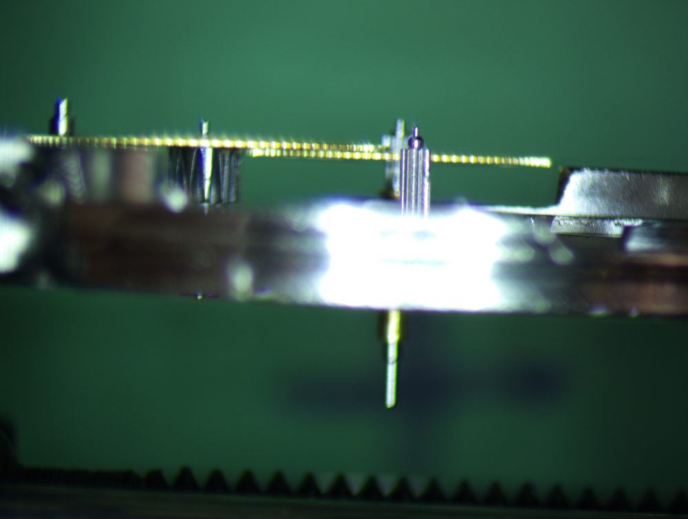

So I gave up on that jewel and thought I'd just try using the whole main plate from the donor AS 5206. It seemed like everything is the same except the balance setting. I put the balance in and it spun freely, so off I go.
I noticed the train wasn't running as freely as I'd like so I checked the end shake and found a lot on the 3rd wheel. Then I took a look from the side...
Then I inspected the jewel for the 3rd wheel and sure enough:
20231125120627178.thumb.png.2ba215dc30a6d746a15db71747c6a48d.png20231125120752510.thumb.png.9225c10e28e6fe419d4e58e33fb96800.png
And then I noticed there's no oil sink for the jewel. Here's the one in the original mainplate:
So now I have a decision.
  1. Use the donor mainplate and press the 3rd wheel jewel to the correct depth, and oil the pivot before installation.
  2. Use the donor mainplate and use the 3rd wheel jewel from the original mainplate.
  3. Use the original mainplate and press the whole lower balance chaton out of the donor mainplate and put it in the original.
I'm taking votes; what would you do?
 The balance wheel is unlevel and needs to be poised, as is, you would  be seeing big delta in positional variation

Thanks, @Nucejoe. Taking a closer look brought something more concerning to my attention: the pallet cock appears to be bent!
I bet in certain positions it was just enough combined with the uneven balance to cause contact and stop the movement.
After fixing that, took an initial timegrapher reading to see where we're at, and I'm not unhappy.
