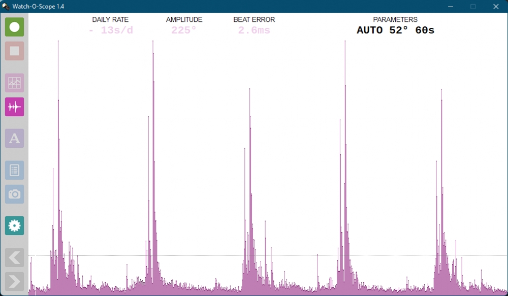

Before disassembly, the timegraph looked reasonable, but 321 degrees of amplitude was suspicious.
Results after cleaning, reassembly, oiling, and a slight tweak to the collet for the beat error:
The amplitude visually looked low, so I took a slow motion video, which looks around 150 degrees or less to me. That video is about 15 minutes after a full wind.
So far I have:
- demagnetized the movement
- checked end and side shake of the balance, which looks good to me
- checked that nothing is fouling on the balance and the hairspring looks flat
What else should I be on the lookout for when I take the movement apart again?
Edit to note that I didn't take the mainspring out of the barrel, since it looked practically new. With the low amplitude, I should do that as well. But I'd still like to find out where all the noise in the timegraph plot is coming from.
Edited by ManSkirtBrew
Lift angle should be 42 degrees. Looks like an issue with the escapement (if you're sure the hairspring isn't rubbing somewhere). What that issue is is pretty hard to say without more investigation.
Ah, thank you. For some reason I consistently forget to look that up before using the software.
And thanks for the advice. I'll start with a more thorough investigation of the pallets and escape wheel.

Good point. Clipping the movement holder right by the balance definitely gave me more expected results:

This is likely the issue. Dial down there's something audibly rubbing. Now to hunt it down.

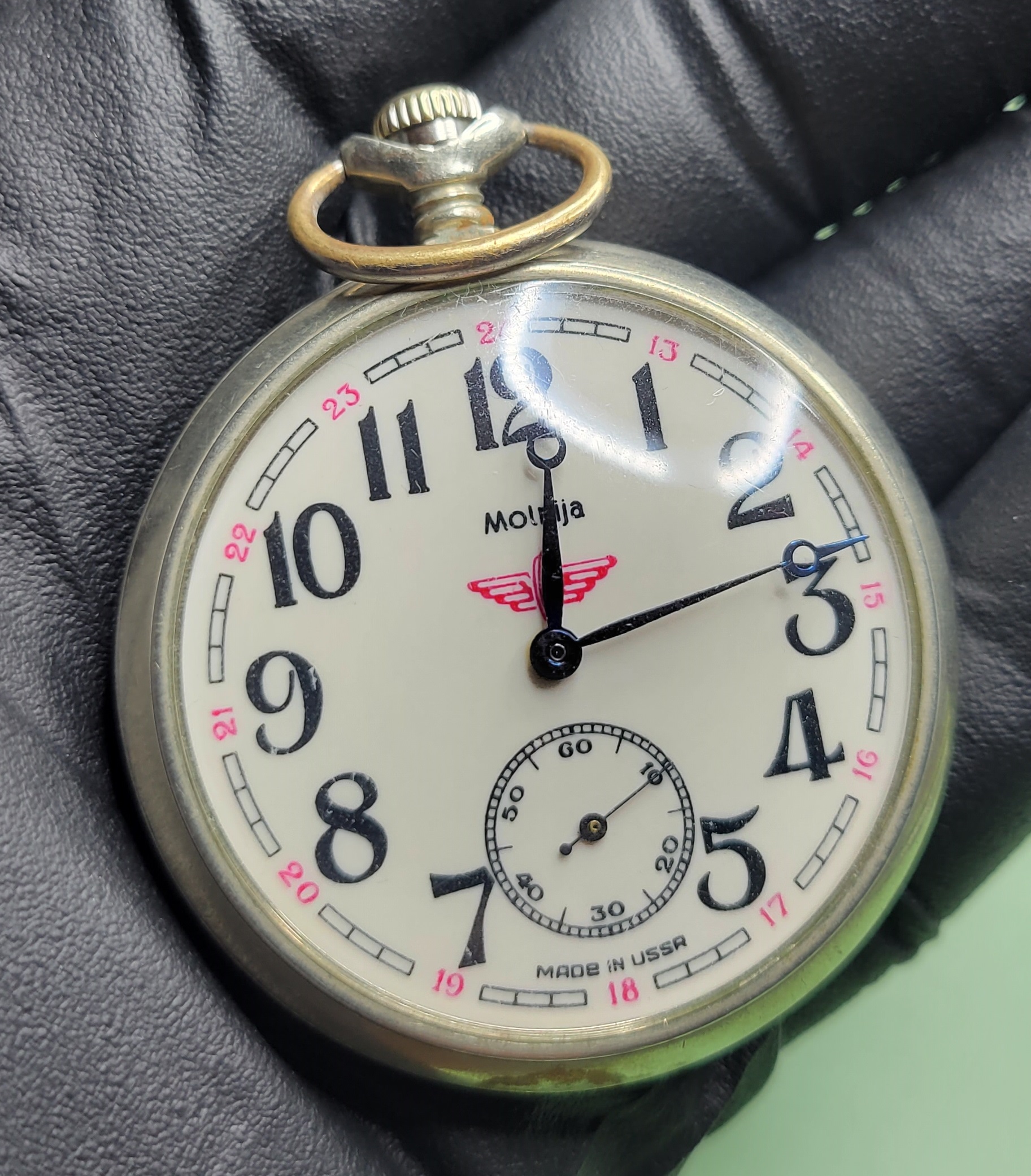

This watch has been a great learning experience. First, the results. This is after a day of running in. I know the beat error is still a tad high, but I haven't messed with it since pressing the hairspring back onto the balance staff.
It turns out not only was the hairspring twisted up in a few directions, but the balance wheel itself was dished such that one edge was hitting the center wheel! A little work with my staking set was able to fix most of it. It's still slightly wobbly, but it clears the center wheel. I've been wanting truing calipers for a while--I have another of the same watch that needs a balance staff replaced, so maybe I'll use that as an excuse to buy a new tool.
I also got to use my dial foot tool, since both feet were broken on the plastic dial. It was very easy to use. The hardest part was getting the old foot out of the movement plate!
20221119_153941.thumb.jpg.9fe8237056c273d165c8fd1843355a5f.jpg20221118_115403.thumb.jpg.7ce2f40f26318d99d8c8e9448d488040.jpg20221119_155645.thumb.jpg.f8c7f780610a335d66bddd61e3c3a726.jpg
Only thing left is to case it up. It's got a handsome little dust cover under the snap-off back.
20221119_162903.thumb.jpg.b0fa1a8df42d1b357dd6b2162715181e.jpg20221119_162846.thumb.jpg.6c54d4e8efad7abcd6a777d0fb72ce1f.jpg20221119_162859.thumb.jpg.644673ea4d745ff8adacc5136fced143.jpg
