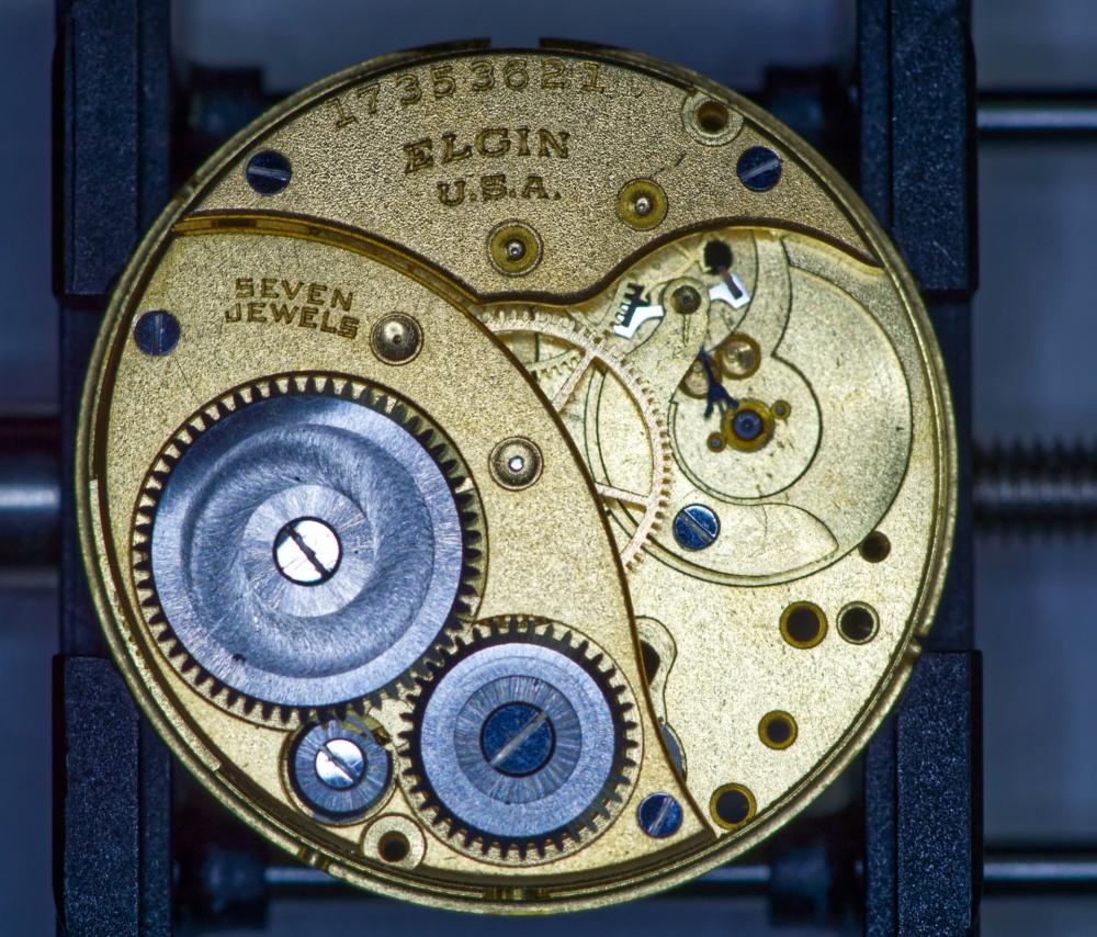

I spent the afternoon yesterday working on the grade 409 Elgin. I disassembled it, washed all the parts and began reassembly. It's good that I have two of these movements because (as always) I lost a few screws along the way. This is a photo of one of the kind of screws that I lost. It is sitting on the graduated surface of a 6" Starrett rule. The thick lines represent the marks on the rule and they are 0.0156" apart (or 0.39mm for the rest of you - I don't have a metric rule, I have a metric dial caliper). The point is that the screw is really (really) small. It looks like a piece of black pepper.
Explain to me how/why my stainless/non-magnetic tweezers seem to be magnetically attracted to these screws?
By the way, two of these hold the upper balance jewel setting into the balance cock.

The gilded plate and bridges cleaned up nicely in the Elma wash and rinse. I need to install the keyless and reassemble (and install) the balance.
