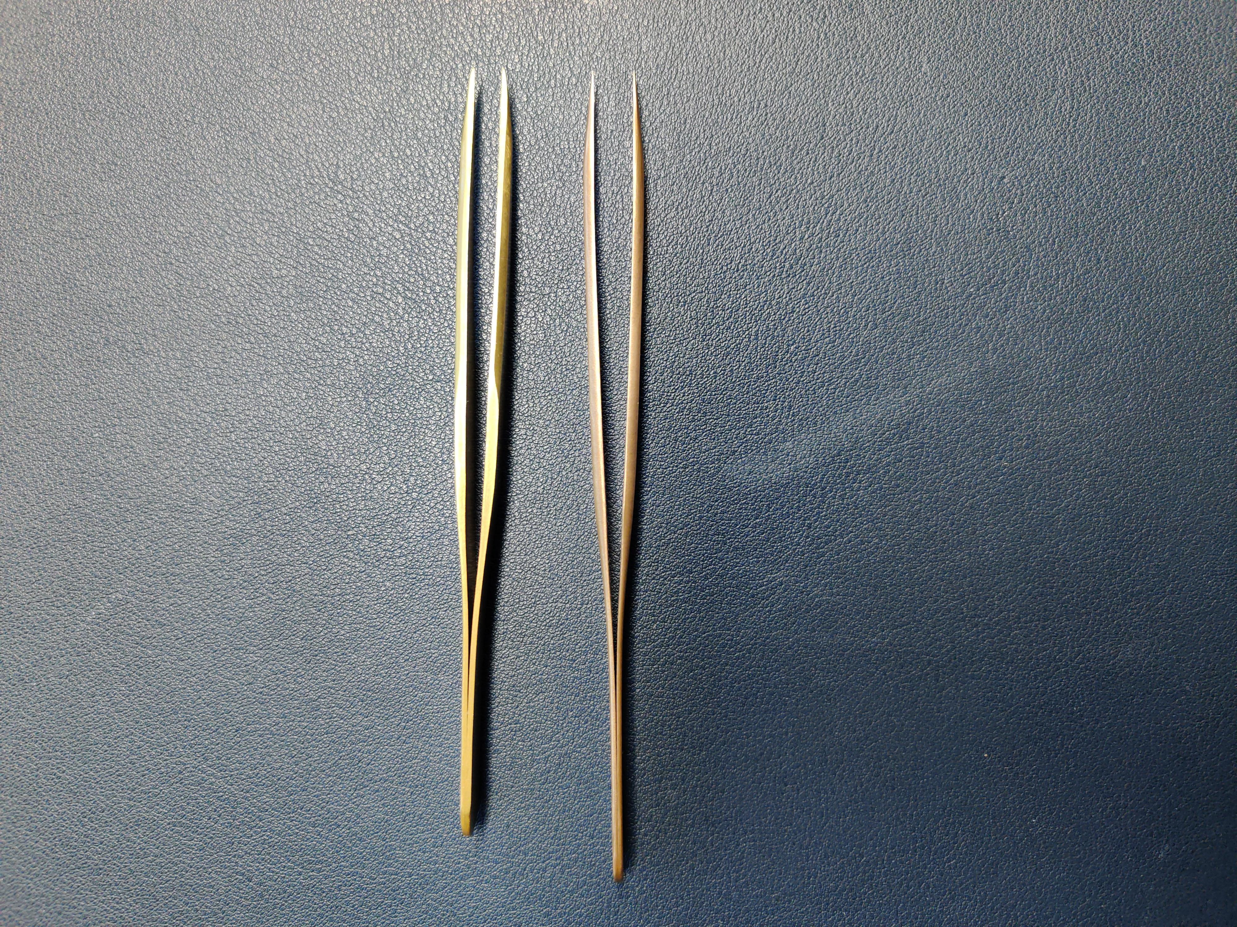

I always preferred nickel tweezers to brass; much stronger, but with similar "grippiness" when handling small parts, which is their main advantage over steel in my opinion. They come in #11 and #12, which I can't really tell apart, but they are similar to #3 steel tweezers in size and shape. When new they are quite fine. After some time they become more and more blunt with redressing- I have some 20+ years old that have lost a good 2 cm of length and are useful when some real force is needed. They are more expensive than brass but worth it in my opinion.
