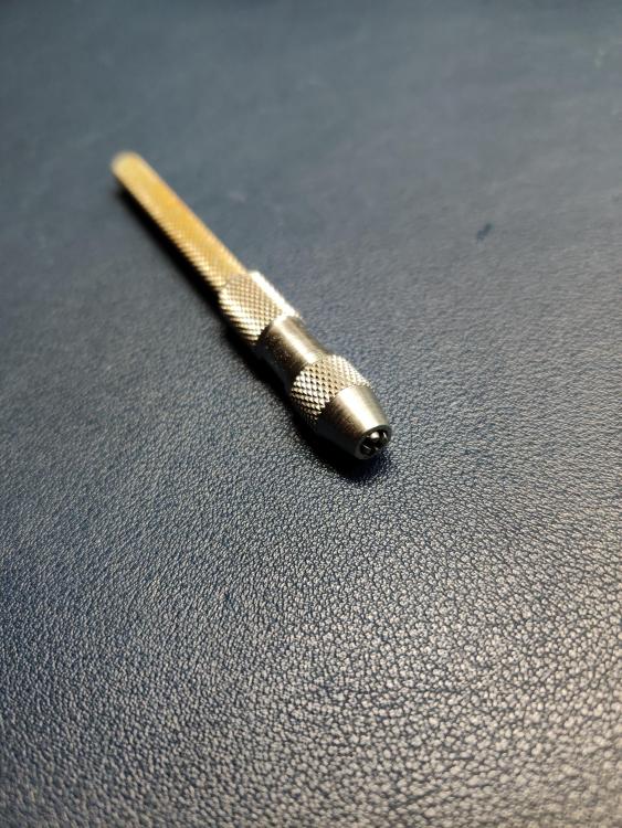

I use a pin vise.
That looks interesting...by chance do you have a link to that specific item? looks like there's a few things called pin vices taht may or may not do what i need this for.  Also it seems like you could probably really easily print some sort of tubular guide for it to ensure you get a straight pull.

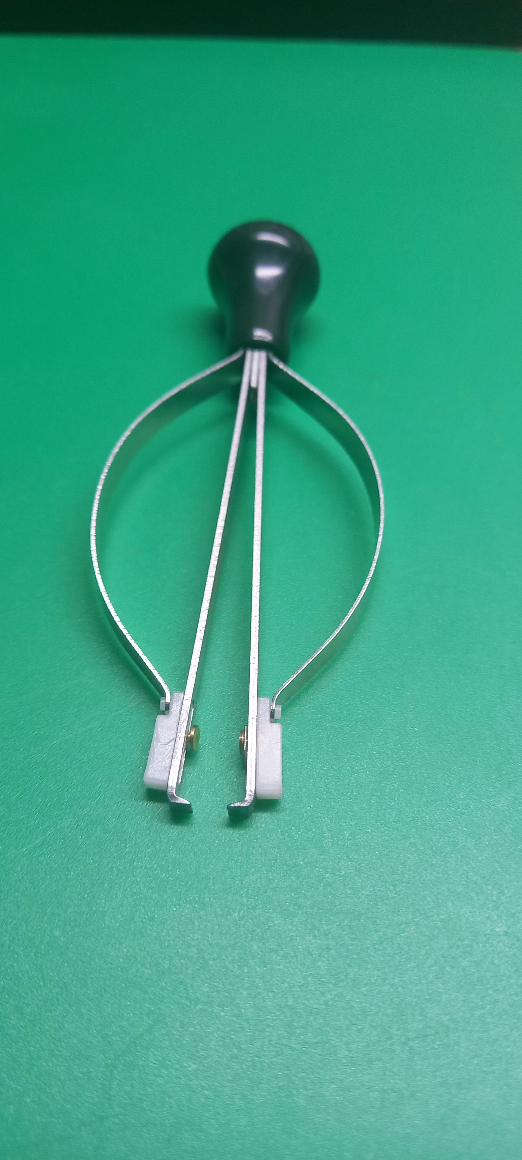

When I first started, I used a cheap Chinese hand remover for removing cannon pinions too. It works quite well.
Then I bought a vintage K&D cannon pinion remover on eBay. But it couldn't even close down on collets that were 1mm, making it practically useless.
I modified the collet and removed the centre ejector pin. Now it can close on  collets smaller than 0.7mm.

I did buy a chinese knockoff of the bergeon presto cannon pinion remover and it was absolutely useless. The plastic buffers weren't the same length, only one slid down the proper amount, the jaws weren't alligned and the gap between them was way too big for most cannon pinions.
If i could find a chinese version of hte presto 2 that actually works that would be ideal.  I did find another site that lists the begeon one and i ordered it. We'll see if they cancel the order again.

That one I brought home from my tool set at work, It's a Starrett B pin vise,  it holds from  0.8mm to 1.6mm.
I also have this set, and a bunch of miscellaneous ones that I've picked up. The nose on the "Z" set is different from the on I showed in the picture, I think that one is the plain 162.
Starrett S162Z Pin Vises Set (4 Pieces)
https://www.starrett.com/metrology/product-detail/S162Z
You can buy them at Amazon, etc.  Not cheap, but I use them in all sorts of ways.

I am trying to get my head around how you use it.  Do you hold it with one hand, lower on to the cannon pinion, tighten with the other hand, then while holding the movement, pull?
Almost -
I hold it in my right hand, lower it on to the cannon pinion, then hold the collar with my left hand, and twist the barrel until it's tight.  Then pull straight up, but I do that by resting my hand on the table and just using my fingers to pull up.
On pocket watches I usually use heavy brass tweezers, and just hold the movement and try to lift straight up. I  fit my thumb under the tweezers and and try to lift that way, rather than levering, which could bend things.

The only concern I would have with this method is if you don't pull Absolutely straight up you could Bend the center shaft.

This sounds risky
Or break it. Oops yes i have. My cheap presto tool works perfecty every time.
I use a vintage canon pin remover on the left first (usually works), but if not I switch to the presto which will do the trick otherwise.
I am surprised, but at the same time not surprised that they appear to be out of stock everywhere.  I am having trouble getting a proper clock mainspring winder.
Vintage puller (left),  presto puller (center), and presto hand puller ( far right).
 Interestingly the presto hand remover seems identical to the presto cannon pinion remover except for the plunger, but it is in stock.  You could maybe buy one and try using it.

Hi Birb. This actually came in a cheap watch repair kit. Its really a hand remover, i took out the center part that lowers on to the hands to steady them and reshaped the tips to grab the cannon pinion when it closes up. The plastic sides push down on the mainplate and the cannon pinion pops staight up and off.
Edited by Neverenoughwatches
The quality of the Chinese hand removers is getting worse. The first one I bought 4 years ago was still ok, but the ones I bought recently were totally useless. The two white plastic blocks on my original were riveted to the metal with brass rivets. The recent ones were just held by a plastic pin with the ends flattened by a soldering iron. It broke on the first use.
