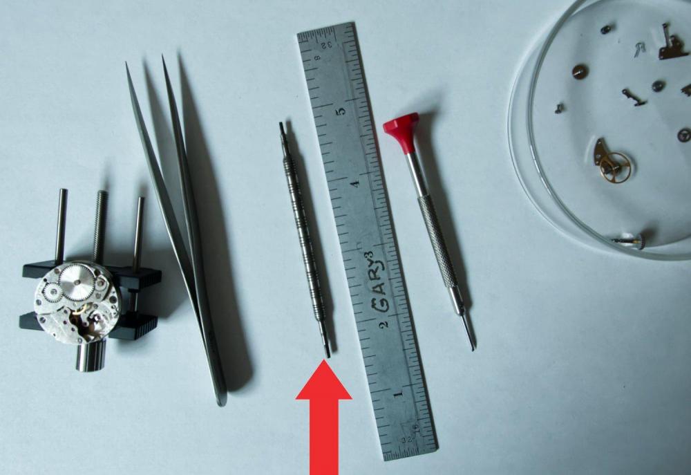

I am disassembling a Waltham 1883 pocket watch. The crown is integrated into the case so when i remove the movement from the case i have nothing to hold onto when i move the click to release the power on the mainspring. I don't see anyway to separate the crown from the case.

There are bench keys for most old pocket watches. When you remove the stem from the case and have the movement, there is a stem in the movement with a square socket in the keyless. The bench key for the Elgin I was working on looks like this (between the tweezers and the steel rule - it has different square sizes on each end). I got this one from https://www.daveswatchparts.com/ He was easy to deal with and helped me to get the correct size tool.
I suspect that buying the tool for a single job would be silly if you are at all handy. You could measure the size socket, buy some square stock (or file some to size) and use in a pin vise. You might also get away with using a screw driver with a width equal to the corner to corner width of the socket - but using square stock would be better (less likely to bugger up the socket).

Yes, you're pretty much going to need a let-down key to do the job safely. I suppose you could pull the sleeve and stem from the case pendant and use the crown/stem combo, but it's a bit tricky and you might end up springing the sleeve that threads into the pendant. And you'd be messing with the important depth of it as well. Forget I mentioned it. 🙂
If you look on da Bay, you might find a K&D let-down key that has one bar on the handle, which is the largest one. That will be the size you'd need for an 18s Waltham like an 1883 model, regardless of the grade. BTW, a serial number would be helpful to establish the likely grade. Images work as well. Good luck.

That is standard for most American pocket watches the stem and crown Are part of the case and the movement is a separate item.. Then as others have mentioned you definitely need the let down keys to both wind the watch and let the power off.

As others have mentioned you need bench keys standard for working on American pocket watches. I've attached some pictures of bench key is and a few keys for key wind watches. Worst-case grab a piece amenable in a file and just make a key. Do not try to use your screwdriver as others have it doesn't always end well and getting replacement components can be a challenge. Although you could file a screwdriver down to be Square to fit in if you can find one the right size that would give you handle the hold onto.

Thank you all so much. I need the straight letdown key like JohnR725 posted in his top picture. I didn't know they existed. Thanks again to all who took time to read my post and answer.
