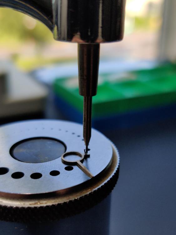

I'm working on a Seth Thomas model 9 grade 36 pocket watch from ~1906, and during cleaning in the ultrasonic a regulator pin broke. I'm not sure if it was the ultrasonic action or the way it was sitting in the basket that did it in, but it was severely corroded and gummed up to begin with.
Replacing a pin like this is something I haven't done before, and I believe I have a suitable taper pin to use as a replacement, but I'm scratching my head on the best way to get the remnants of the pin out of the regulator without mangling the hole.
Looking for ideas, any pointers would be greatly appreciated.
This is not my watch,  and I want to get it running. It's only seven jewel, so not worth sinking a lot of money into. I'd prefer not to have to scrounge a parts movement or spend money on a part if it can be avoided. I'm just going to have to take the hit on my labor 🙂 Besides, if I manage to do this, it will be great experience.

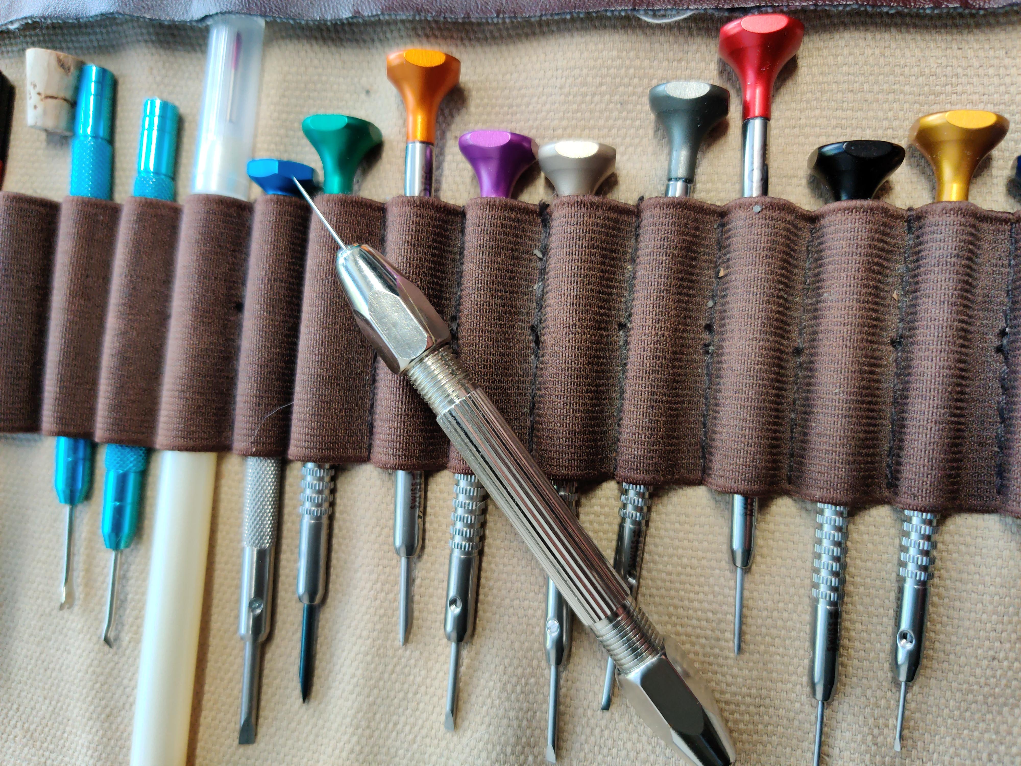

How about a fine needle ground down to slightly under the same dimension but not to a point as this will have the effect of spreading the pin. The needle in a self locking pin vice. Popping to my watch room to investigate.  I have the bloody covid nonsense so confined to staying in for a few days so i may as well be useful 🙂
Sorry about delay dadisitic been busy with man flu lol. Yes mate the smallest needle from a selection, no need to even dress it down to size but flatten off the point to a fraction undersize of the diameter matching the pin you are pushing out then fitted in a small pin vice like this if you have one. Joblots of old watchmakers tools from ebay often throw these up for pennies.
I keep a needle in a pin vise handy in my tool roll. I think I'll stone down the end and give it a try! If it doesn't work, I get to make a punch for my staking set.

Cool. Tool manufacturing my favourite. You're way too organised for me mate. I'm like the chef that has to have every gadget and cooking utensil out on the worktop. You want to see my watchroom, you know the goldfish that grows to the size of its bowl, well there is no water left in mine. 😅

I have needle files that I used to smooth out the broken stub of the regulator pin,  but I wasn't able to make the needle method work. Too wobbly, and too hard to keep lined up. Just pressing didn't work, and I wasn't able to juggle everything and take a hammer too it.
So, like you, I get to make a stake. I have some A2 bar stock at 5mm, so I'm going to get some turning practice by seeing if I can make a tip that will work.  I don't want to sacrifice one of my stakes, as amazingly, they are all in pretty good shape 🙂

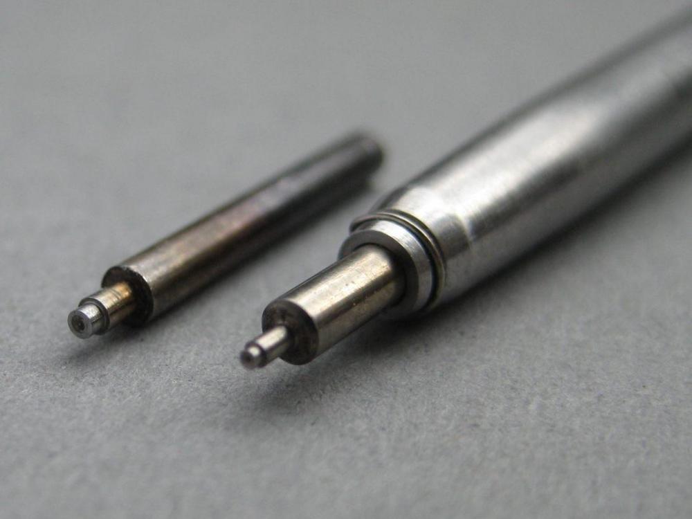

You won't sacrifice or make from scratch a whole punch just for a tiny pin, that soon will break?
Better make e.g. 2-mm inserts for a 2-mm bored punch:
The pin for loosening shall be length = diameter. And a 2nd one much longer for removing the loose item.
1st picture shows inserts for punching out tiny rings from foil.
Some small drilling I do with pivot drills and a home made adapter for 1-mm shank drills in my staking tool:

Thanks, Frank @praezis, this looks like a solution that will work now and be there to solve future problems.
I like the small inserts, much easier to heat treat if necessary.

I have successfully removed the regulator pin.
It turns out that I have a flat faced punch with a 2mm hole in it, and my 2mm A2 rod  stock fits nicely without requiring adjustment of the diameter. Lucky me!
So, based on the idea from@praezis, I turned a little insert.
The tip is 0.25mm, and with the tooling I have I can't make a square shoulder at that scale, so it should have been longer. The step keeps the tool from going to far and impacting the other pin.
A couple of taps, and the old pin was mostly out.
Now to replace the pin and straighten things up. I hope the other one doesn't break when it's straightened, but now I can replace that one too if I need too.
