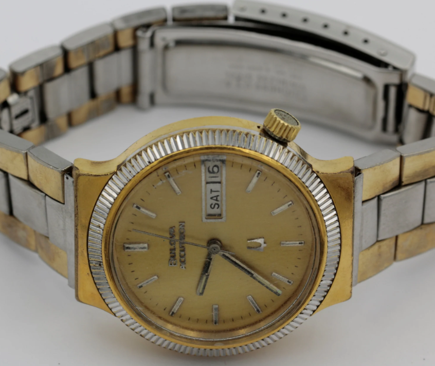

I have a Bulova Accutron that I got in the late 70's.  It looks similar to the one  below (mine is silver with a gold bezel).
I would like to try to remove the back cover and replace the battery.
Would  anybody know  the battery I  would  need?  I've heard these used some  type of mercury battery that's no longer used.
And, is there a gasket I should try to buy in advance or should I be treating the threads with some type of sealant?
And, to remove the back, should I use something like the Harbor Freight Tool shown (it's at https://www.harborfreight.com/watch-case-opener-91550.html).
Should I also buy a holder for the watch?
I've never done this before and actually am looking forward to it.  Not sure if it'll work or not but I figure I should try.  Anything else I should check  on the watch?
Sorry for all the stupid questions but I am a novice.  😉
Those tools should work to get the back off. Battery is a 344. But- and it's a big but, Simone, these watches work in  reverse of normal mechanical watches. They build power to move the hands and date from what becomes a very high torque source. So they will grind through rust and wear until parts literally fall apart or disintegrate- and run to that point, keeping time. If it hasn't been serviced in the last 5-10 years, best to do a full service, or get in line for the rapidly diminishing parts and a more costly service.
Thank you for your advice!   In the full service would the shop replace gears and parts and lubricate?  I have actually never had it serviced since it was new and it hasn't run in years.  Let me know if  you know a good service place for these and, again, thank you.
