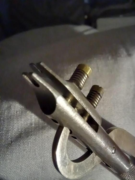

1 hour ago, Paul80 said:
What was it listed as, what made you buy it without knowing what it's for ?
Maybe some sort of clamp or vice grip
It was part of a job lot, the other things i knew what they were and wanted.
1 hour ago, Plato said:
It looks like a bracelet pin tool modified for something else.
https://www.cousinsuk.com/product/pin-removing-pliers-bergeon
How about now . The end reminds me of a part of a balance staff removal. The lever opens up the jaws to insert.
Balance staff and wheel clamp ?
It's for offset canon pinions. I have a couple, neither ever fit one, ground one out to fit Heuer 11 and 12 caliber chronos, use it frequently. I guess they always figured on them being modified?
To be used on the movement itself to remove the cannon pinion ? I was thinking the tip looked like somekind of roller remover. Thanks Nicklesilver

An offset canon pinion is not in the center of the watch, and doesn't carry a hand. It's seen in a number of mid 20th century calibers where the first wheel after the barrel isn't centered. Later designs like most familiar modern ETA calibers deal with the friction needed for hand setting by driving the cannon pinion through an attached wheel which is driven by the rigid offset 3rd pinion.
In the pic the upper pinion is the offset cannon pinion. They are by necessity shorter than regular cannon pinions, and since they are attached directly to the center wheel with no bridge in between can't be pulled with a normal cannon pinion puller. The tool in the first post slides in between the upper cannon pinion and lower fixed pinion, and spreads, thus removing the small cannon pinion without harm.
If you don't have the tool, you can often work them off by gripping them with brass or nickel tweezers and turning while pulling, or sometimes you can grip the arbor area between the two pinions with a pair of steel tweezers and slide them along the arbor (while turning the wheel), the wedge effect will pop off the cannon pinion. If you have a bench block with a V cut and that is open and thin enough on the underside you can get the assembly in it so the cannon pinion is sticking up, sitting on the V, and press down the pivot with brass tweezers. Or- a Platax tool can work well here (about the only good use for that tool in my opinion). But except for the latter technique there's always a risk of damaging the center wheel. The tool really makes it easy.

As usual, a perfect explanation by Nickelsilver!
But the tool is older than offset canon pinions and aimed to a very similar, but slightly different task:
Center wheels and its canon pinion came as adapted assembled units. But for mounting, they had to be separated, and this is, what the tool was initially made for. No other tool will really help, esp. with bored pinions of center seconds or chronographs.
Frank
Thank praezis. I almost overlooked it in the box of tools, then noticed it while sorting through. It looked well made and to have a particular use. I wonder if i will ever use it.
Buy a watch with an offset pinion just to use it. Hehe.
