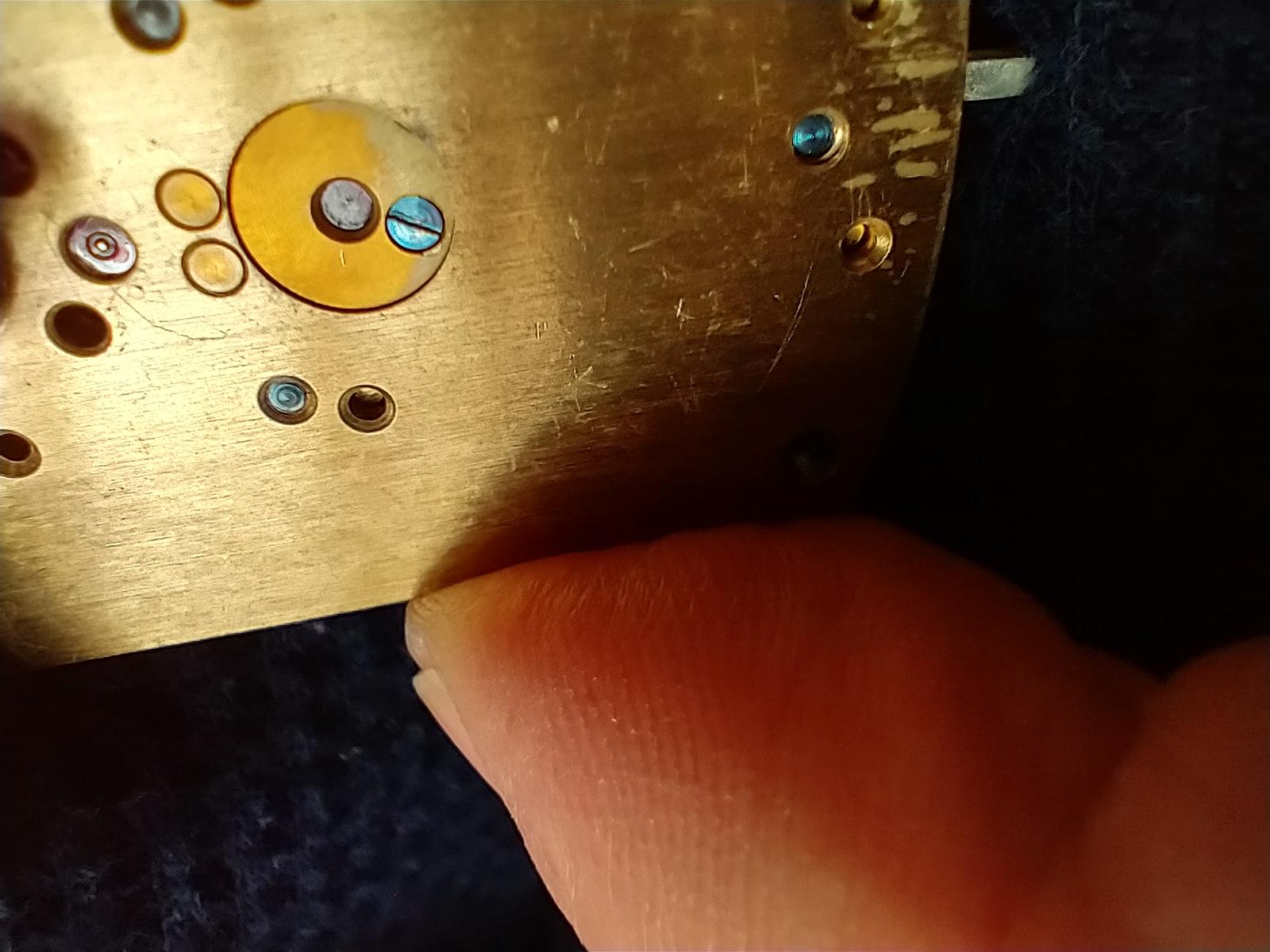

Hi watchweasol yes will do in this photo the arrow pointing to the screw i did remove that what is the signifinance of that screw, thanks
Here's a thought. The center wheel is friction tight I believe held in with a pin that fits in the recess of a spring on top of the center wheel, has the spring worked it's self out part way or all of the way.
Hi oldhippy all i can see is the center wheel has a clutch with a pin through to hold it in place see photo at start of thread do you mean that thanks
5 hours ago, oldhippy said:
Yes that is it. As I said I wondered if the pin had worked its self out as that would cause the hands to wiz round.

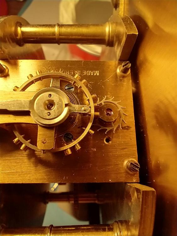

checked the clutch it's ok watchweasol wanted some photo's of the stones just going to do that now

are these of any use watchweasol

Am I missing something? Where's the pallet? this should be where the two pallet stones fit? Rocks between the Balance spring and the Escape wheel...has it pinged off?
Me too somethings missing. The escape wheel will just run with no control.

Is this it the photo you want
Hi Willow  I am still of the opion that if you remove the balance complete and expose the pallets and escape wheel you will be able to inspect the interaction of the pallet and the escape wheel locking or not locking as may be the case. the other thing is the engagement of the contrate wheel whick Old Hippy mentioned earlier. If you have bad engagementit could ruin the platform amd the wheel. An other point to check is the contrate wheel tight on its pinion and not slipping.  cheers
yes the interaction with the pallet and the escape wheel is not right the escape wheel is just rocking back and forth when i set the balance wheel in motion never worked on one of these is it easy enough to take apart
