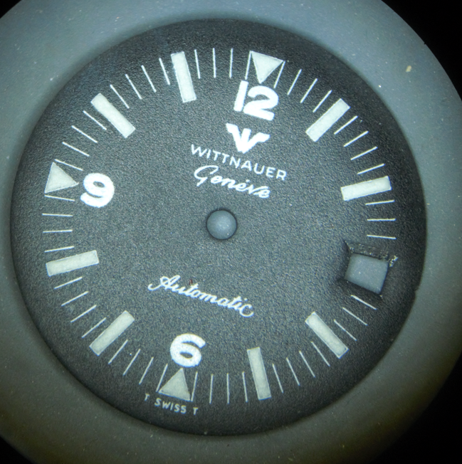

Here are two identical dial layouts.  One was done by International Dial and the other was done by Kirk Rich.
Sadly, one of the refinishers failed to follow my instructions to use a patina lume.
You choose which is the best.  After everyone has had some time to review, I will post the identity of each.

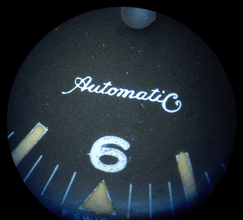

Hmm, hard one to pick for me, I think I gravitate towards the first dial. Comparing with photos online the text is more accurate (see the 'c' at the end of 'Automatic') and in general seems a bit more crisp and defined.
The lume on the first dial has also been more carefully applied, lots of running over the lines on the second dial.
The numbers in the first dial however are not as sharp as those in the second but the second has quality issues in all 3 numbers displayed, especially the '9'.
The date display in the second it a bit nicer, I also tend to prefer the finish of the black on the second dial, a little bit finer than the first.
Even given that I stick with my preference of the first dial, the crisper logo and accurate text is probably the most important thing for me. I don't place a huge importance on the aged lume although it is definitely a concern if you asked for it and they did not use it, I would not be happy in that case!

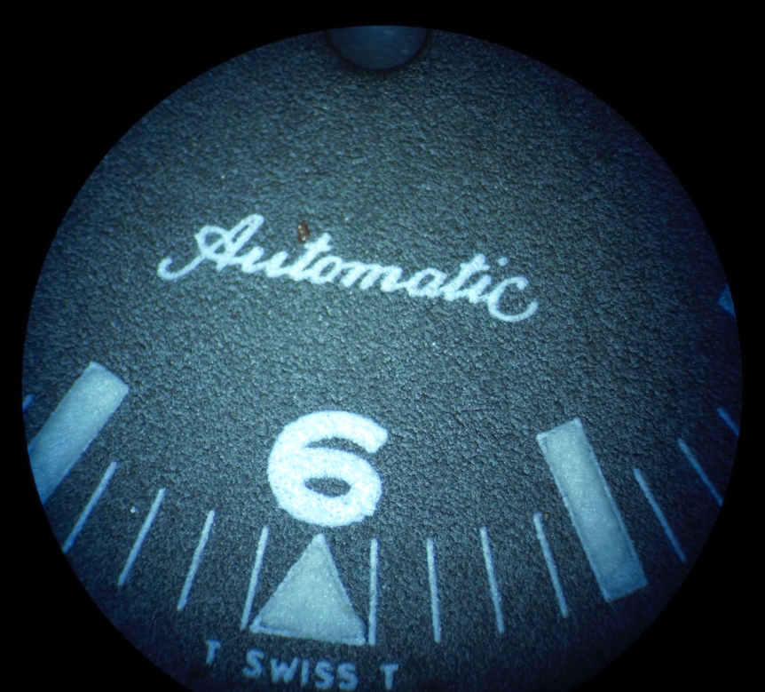

Well, I just realized that the first dial has yet another problem.  IT IS NOT AN AUTOMATIC.  I am posting a picture of the dial I sent.
Although the dials are essentially the same, one is for an automatic (C11KAS) and the other is for a manual (C11K)

The second one got an extra indicator line between hr3 and hr4,  but I like it.
Opps , one less line between hr2 and hr3.
21 minutes ago, LittleWatchShop said:
I spoke with the refinisher today...he said he would make it right.
 hr2 and hr4 markers are positioned asymetric with respect to hr3.
The whole dial is off , you will always be 20min late.
I would send both back. To many mistakes even the logo is done poorly and not sharp, the wittnauer text has the wrong font in either one of them.
But it all depends on what you agreed.
These dial refinishers are backed up for many months and the only game in town.  At least at some level, they call the shots.  It is hard to specify: "make it look like it came from the factory" so you have to just hope for the best.  I recently bought a NOS dial (like the one described in this post).  They are incredibly rare and 3X+ more expensive.  At the end of the day, you take what you can get.  Some argue not to refinish.  I get that.  But if a dial is a mess...I think refinishing is OK.  The darker dial came from my watch which (many many years ago) I had customized.  The paint began to flake off, so I put the original dial back on the watch and sent the customized one back to return to original (low risk transaction).  Nevertheless, I am unhappy.  But the refinisher has promised to make it right.  It is a no brainer in this case...it was a spectacular FUBAR.

Update: Have resolved the issue of lume and "automatic" with one refinisher who will fix these issues and put me in front of the queue.
Still trying to close the loop with the other dial refinisher--several phone calls but working through and "email" issue (which is quite interesting).
There was a post recently in the Facebook group "Old Vintage Watches" where someone got their Vacheron dial back from International Dial Company after a 7+ month wait, and man, it looked like it had been done by a blind man with a dull crayon. Just unbelievably bad.
I would say that IDC did OK except for following instructions.  I think the turn time was about seven months.  They are gonna fix it, so I will get what I get.
