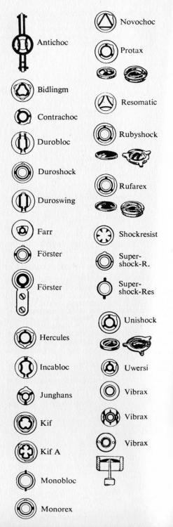

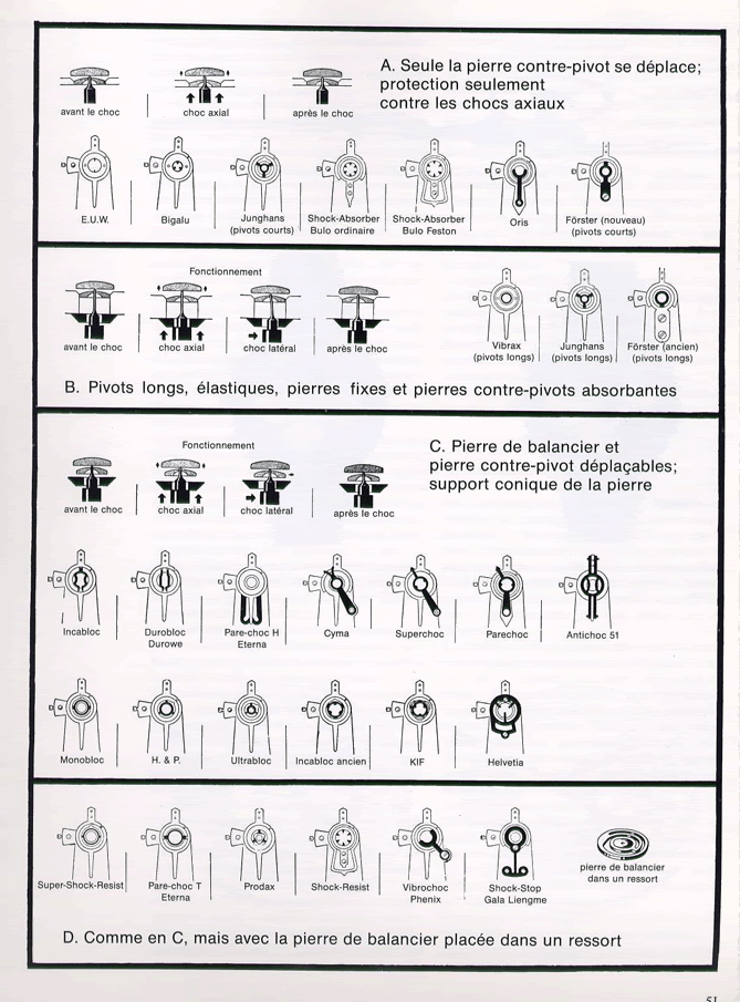

Hi guys, I have been trying to service a Tressa AS 1906 movement only to find that its missing the upper top jewel for the balance. I guess this was a type they used before incabloc. I have attached a photo of the bottom balance jewel. as u can see it has a spring with 3 prongs protruding which hold the jewel in place when the prongs are placed under the collar.
I have also seen this type of shock protection on an Accurist ETA 2409.
I would be grateful if anyone can let me know the name of it and if there is anywhere i can get spares as I couldn't find them on cousins (probably because I don't know the name.
Many thanks
There are several systems that use that shape of spring,  Uwersi ,Unishoc,Ultrabloc and contrachoc to name a few.  Find attaches diagrans of the different systems there are likley to be others not listed.

We would need a historian to know, wouldn't we? Without someone who has already solved this sourcing issue successfully chiming in.
I got a notion to do some detective work and see which other less-common antishock systems Tressa used, many of them seem to have a 3-toothed ring that looks a bit like what the watch wiki says is "bigalu" or maybe Kif Protechoc, but then i realized that just because Tressa worked with one vendor on several watches doesn't mean they worked with the same vendor on others.
Not that we know who made "Bigalu" antishock anyway.
many thanks for all your help guys, what a minefield
from what i can see could be 1 of many my best guess of the hundreds of possibilities at the moment is rubyshock.
doesn't look as if I will be able to positively identify it let alone source a replacement jewel  lol
I think my easiest bet is to find a donor 1903 incablock movement and swap over all the existing parts

This is a  supershock on an AHO
Thats an interesting looking design. Is the cap jewel held in place by the cage on the timing adustment ? You'd have a job losing it. Identifying the movement make and calibre is the best way barring any serial numbers and a listed database. But potentially Rich you could approx date a watch by the manufacturing years of a certain shock design if you could find that listed somewhere.  Not much use if it has a long span of manufacture or they've been stock piled, so not particularly a great way of dating a watch.
Antichoc 51 according to flume
