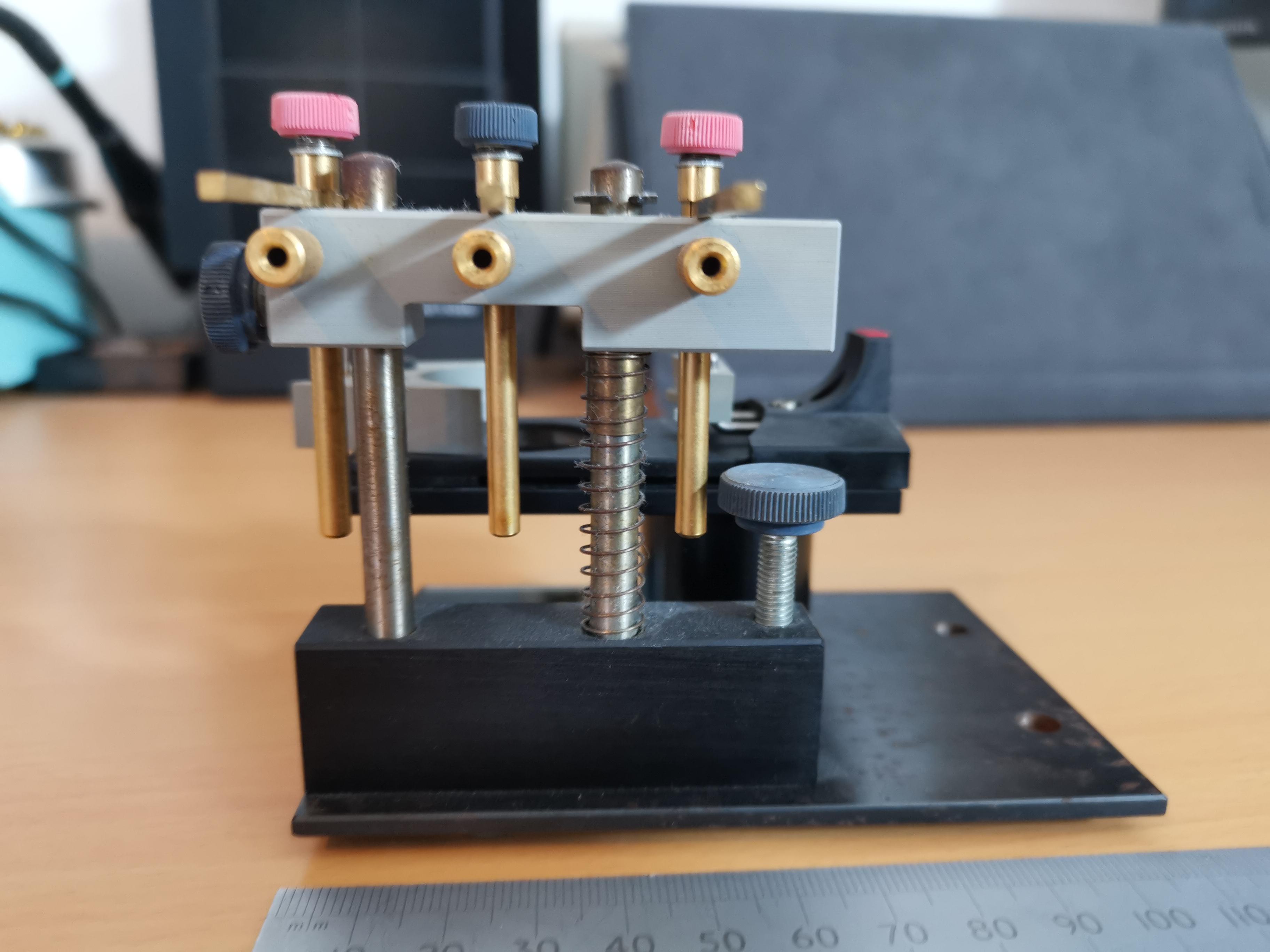

2 minutes ago, LittleWatchShop said:
Well it is very nice...jealous.  I may have to build one but I would rather not!
It's mostly plastic, clamps and springs on a metal base... I'll take some more photos and measurements tomorrow if you want?
Sure. I can 3D print all of the plastic pieces.  I bought some pogo pins awhile back thinking I would build the probes.
Every time I test a quartz movement (out of the case), it is a fiddly process...need to do better.
I'll take some decent photos of it tomorrow, it's not perfect but quite versatile... the clamp is the same as the one on the Vibrograf M80.
