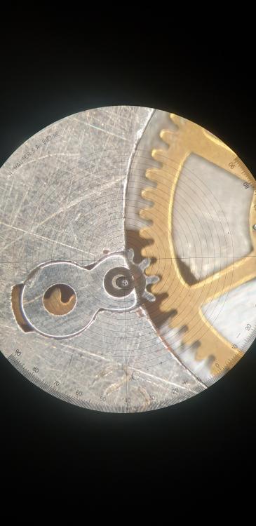

Just curious, but how is the jeweling done for mainplate “edge-type” jewel bearings, commonly found for third wheels? The jewel is not typically held in a full hole on the mainplate, but on a U shaped crescent in the mainplate. This would appear to make it quite difficult to support on the stump of a normal jeweling tool (either Horia micrometer type or lever-type).
It can be pushed out and in just fine with normal stumps and pushers. The seating in the plate is machined during manufacture with a 3 point hold, there's no way to ream a partial hole like this.

The jewel setting hole looks damaged

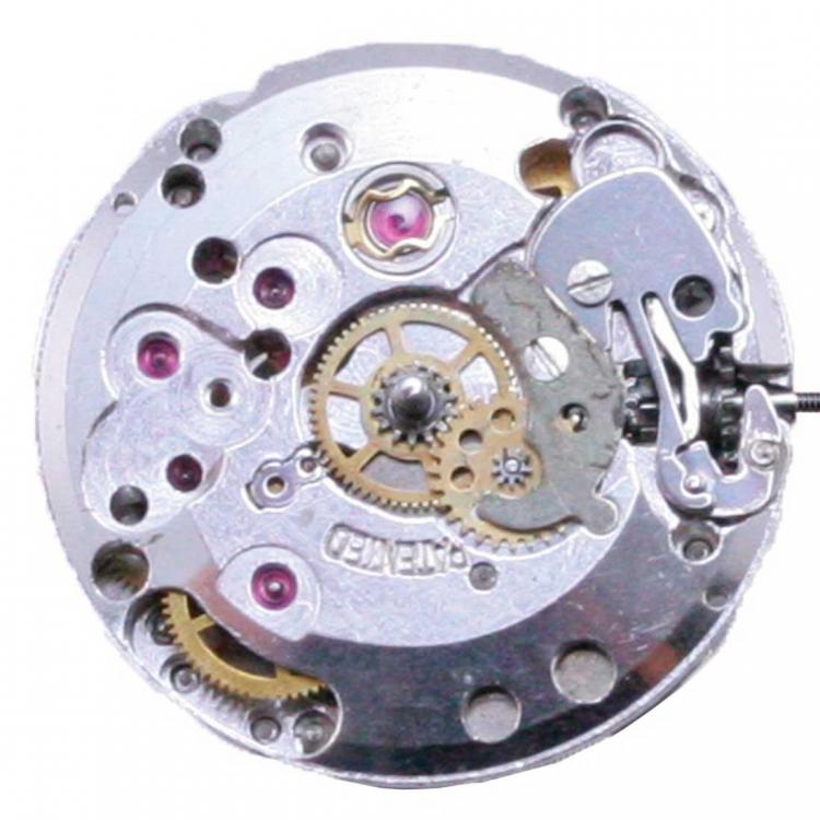

Here's another ETA 2671, or in this case a Cartier 077. The same 3 points of contact setting.
This was in a ladies Cartier Santos.
What a poor design indeed. The picture displayed at the beginning of this post clearly shows damage to its setting so it might not be a straight forward repair if the jewel needs changing.

There is no damage to the jewel setting, although there is some discolouration around the jewel setting in the photo, which makes it look odd. In real life it looks exactly the same as the much better picture shown by @Marc, and the jewel is held securely by being “pinched” at 3 positions.
Still, I agree with you that replacing a jewel in this sort of U-shaped setting will be hard since a stump of a jeweling tool wouldn’t support the main plate on the part where the jewel is sticking out. Which is why I made this post to find out more.
Maybe you will need some way to support the whole main plate on the base of a jeweling tool, in order to replace jewels in U-shaped settings?
