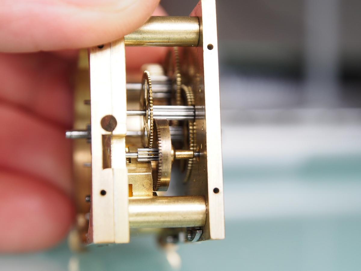

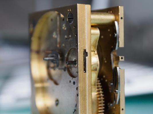

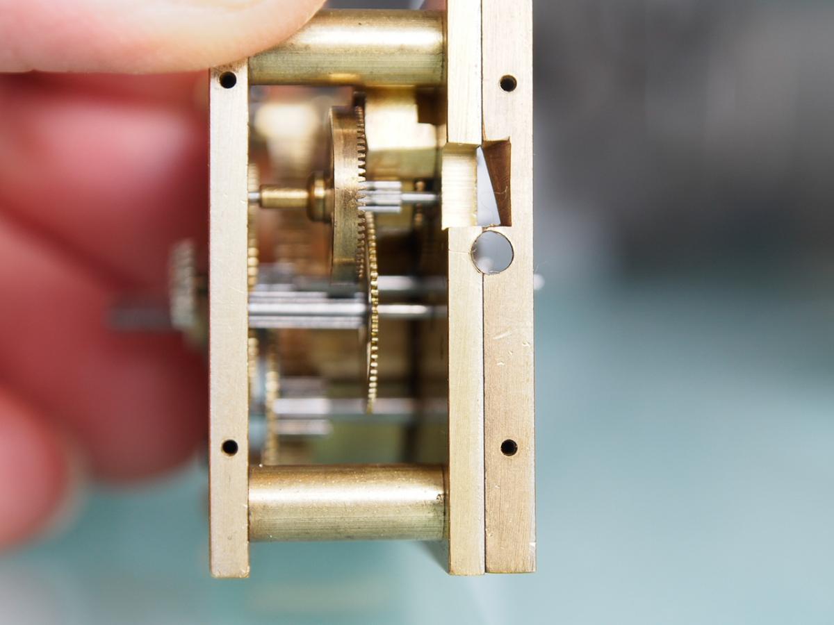

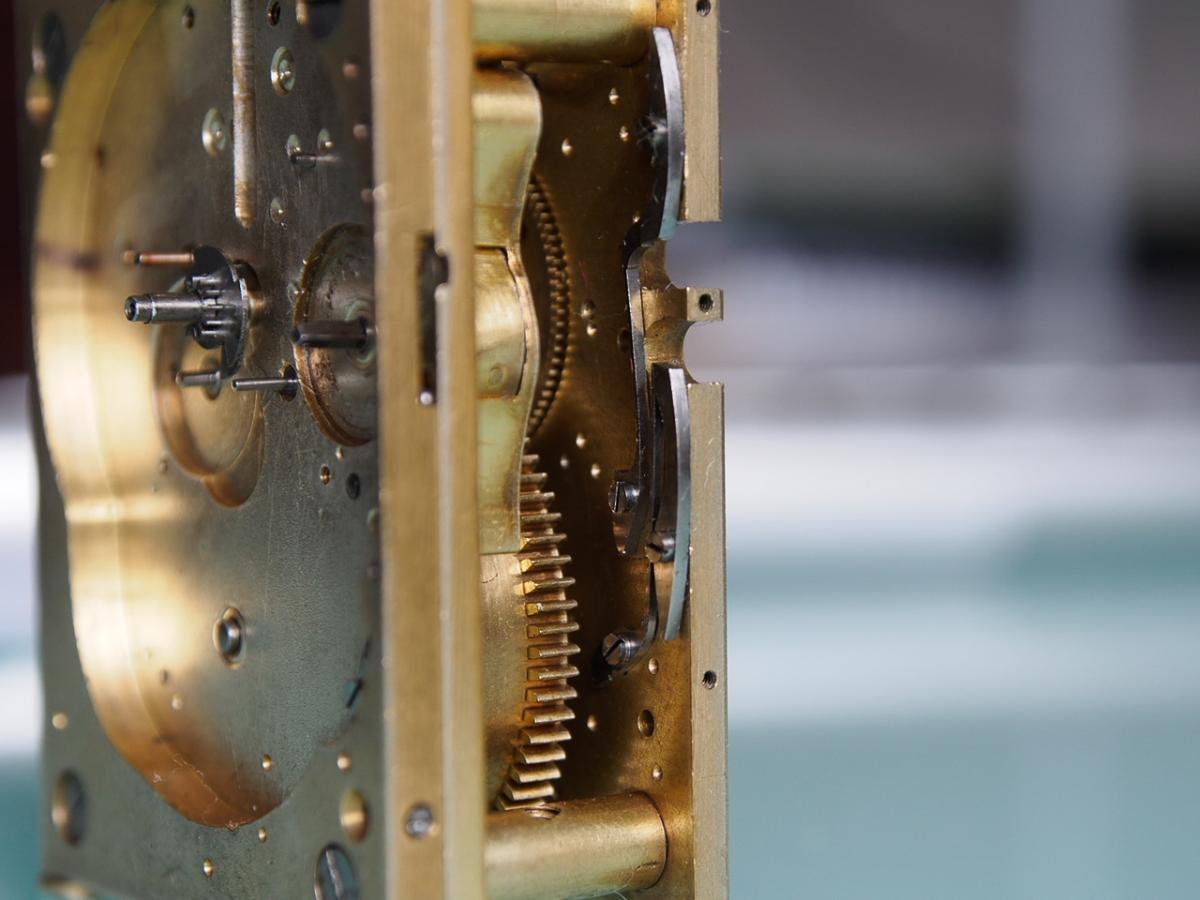

It might be the chime/repeater was removed as a request such as the Downing Street clocks which had all of there chimes removed
I think your right. I've just had a look at Dave's clock and you can see the two small screws and the plate where the repeat press knob fits in.
I can definitely confirm that your clock is Swiss and it's a quarter repeater. Unfortunately nearly all the  mechanism behind the dial for the strike/repeat is missing apart from one of the lever springs, all that is left between the plates is under the small plate held together by two screws which is the barrel.  The back plate is silvered and it's got many nasty deep scratches on it. Now the really bad news if this had been complete and in working order it would at auction fetch between £2,000 - £2,500 but as it stands you would be lucky for it to fetch £200

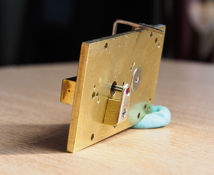

Well I got the platform back from Roy yesterday. I knew you would all be interested to see it so I have taken some pictures of it prior to refitting it to the clock.
When I spoke to Roy on the phone I asked him if he would mind telling me exactly how he carried out the repair. What he said was that the lower jewel was fairly well set into it's bridge, so he re-jeweled it, a little higher up I assume, and this allowed him to re-pivot the broken end so that it all worked out nicely. The pictures might make it a little clearer to understand. I hope the pictures are of good enough quality to make it out.

I've just downloaded your link and it works well. The action of the balance is very good with just a small amount of power. Please use the correct fitting key. I understand what Roy has done and no one would know unless they were to take the escape wheel out then you would see the shorter pinion, what he has done is quite common and keeps the cost down. As this is a travel clock it should work in all positions even upside down, so if you haven't done so far I would test it, you don't need to do it for hours just minutes, watch the contrite wheel against the escape wheel for any problems with depth and you might need to adjust accordingly.

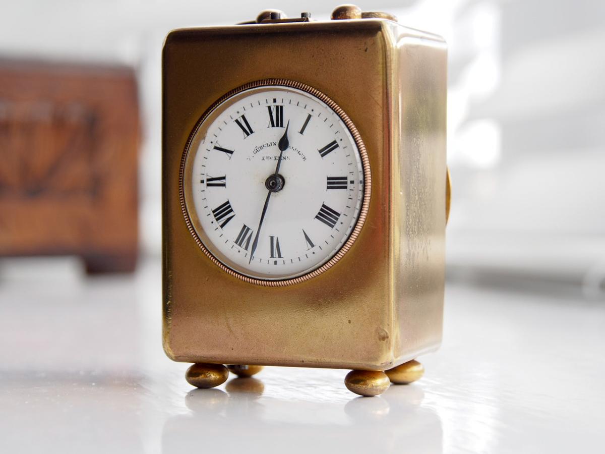

Well, it's keeping really good time so far. Lost about a minute overnight. Sadly I don't know where the screw is that you mention and I don't have a spare but, I checked the other one and it is tight. I have put it back in it's case and I suppose I will reluctantly have to give it back to it's rightful owner. I wish it belonged to me as I am quite taken with it, it is a lovely little clock.  Here are a couple of final pictures of it complete and ready to go home.

Thank you davey57 for sharing this lovely clock and with such good pictures. I hope I've been helpful to you. I know what its like to part with a clock that you have worked on.
