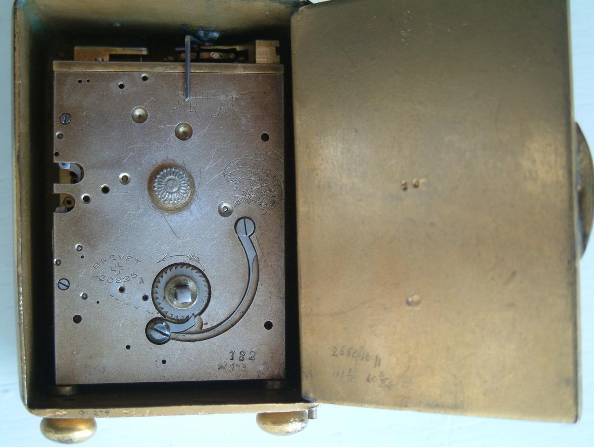

We were talking about hobbies the other day and I happened to mention that I had become interested in watches and had enjoyed stripping some down and rebuilding them. My friend asked if I would have a look at an old clock that had  belonged to a relation of his who once had a watch/clock repair business. It came into his posession after the old gent passed. I said I would take a look but also said that if it was of any sentimental or monetary value I would not be too happy setting about it just in case I made matters worse. He said he wasn't bothered either way and brought it down for me yesterday. Thought I might post some pictures of it. It is a lovely thing, heavy and somewhat bashed but it does have something about it. Does anyone know anything about this kind of clock? It doesn't run and if you turn the knob to adjust the time the hands just spin very fast. I would quite like to investigate it, but I would like to be reassured that it is not of any great value. You just never know what you might have in your hands.
Here are the pictures. I hope you find them interesting.
The name on the dial looks like E Gübelin Horologer Lucerne. There is quite a bit written about the company on the net.
Thanks
Dave
Very nice clock, I hope you can repair it since it is a beauty! IMHO there might be an issue with the pallet fork if they have one? I've never worked on a clock before so I don't know what they look like inside or which solution they use for this part of the movement. My reasoning is that there is nothing to "stop" the train wheel from the action of the spring. This is the job of the pallet fork...if you allow the over simplification.
Cheers,
Bob
No great value but certainly worth restoring. Start by removing the platform on the top of the clock. This is called a platform escapement. Replacement are available in a variety of sizes from Cousins and other suppliers. They are not cheap. If the lower part of the clock looks in good shape with no wear on the bushings and the main spring is intact, then your best solution would be to find a replacement platform escapement. These come without the holes for fixing to the clock base and you would have to drill those using the old platform as a guide.
Repairing the original platform escapement is another possibility but it could involve making new parts.
Should you choose to look into the replacement platform solution be careful to choose a platform with the gear wheel underneath the platform (that connects with the gear train of the clock) of the right size and orientation. This is a tricky job, but challenging and finally rewarding when the clock hands begin to turn again.

Brevet or Brevete is French for "patent" or "patented. So, it is NOT always the maker's name!
But there was a French maker called Brevet so it can be confusing.
However I think this clock is very interesting because it is Swiss not French as I first thought.
Gübelin were founded in 1894 & are located in Lucerne,Switzerland & made & still make superior quality watches & clocks. There are many of their vintage pocket watches to be found on the net.
I am not sure of the value but it is a collectors item that is for sure.
​I will be interested to see the pics of the movement as I have never worked on one of these. As CJD states it looks like it has a platform escapement on the top but remember,remember let the mainspring down before any removal of parts & this is vintage and any replacement parts (apart from the platform escapement) will have to be made.

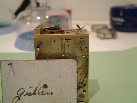

Well despite what I said I just could not resist "having a quick look"  I have discovered the problem, the escape wheel has a broken bottom pivot and is not engaging with the wheel it is supposed to (not sure what the correct name for that would be?)  Is this seriously bad news?  What are the chances of finding a replacement?  I also see that at one time it would have chimed but most of the mechanism has been removed. I removed the dial and noticed that appears to be signed, "Gübelin".
Not very good light for my picture, but you can hopefully see the broken pivot.
Good news in effect! But first of all: the platform - this is a very special design and you would be hard put to find a suitable replacement. But the good news is that the fault is due to the broken pivot and not damaged teeth. The pivot can be replaced either by drilling out the old one and inserting a new pin of the correct size. This is a task best left to the clockmaker unless you have suitable tools. An alternative solution is to use a pivot cap. These look like this and one of the correct size can be relatively easily fitted over the stub of the broken pivot.
You would need a watchmaker's lathe to do this job. If you are equipped for that then I could perhaps supply the cap. You would have to send me the dimensions. Otherwise http://www.dashto.com/can supply a selection of caps some with drilled holes at the thick end and others blank to be drilled out by yourself.
the URL is: http://www.dashto.com/newlists/materials.htm
and search for 'pivot caps'
A worthwhile and relatively easy job for this nice little clock from a top-end Swiss watchmaker.

The lower bearing for the escapement wheel and its pinion is a part of the platform and so you could give only the platform to the clockmaker. You would then have to reinstall the platform ensuring the correct meshing of the pinion and its corresponding gear of the clock gear train. That is not too difficult.
As to finding a replacement part, your best bet would be to look for one of those clock makers with lots of vintage clocks in his collection and to ask if he had a suitable part in his bottom drawer.
