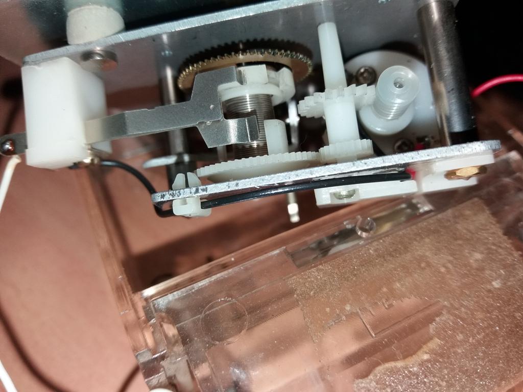

I found this curiosity in the bottom of a drawer while clearing out some of my late fathers things, the movement looks to be electromechanical,  inside the clear case I can see a small motor, some pinions/gears etc a 1.5V battery holder.
A wire protrudes from the bottom, working this from side to side advances the hands so if the wire is moved from side to side at the correct beat it should keep time - just inside the bottom of the movement I can see a flat spring hanger for the pendulum, as the pendulum swings from side to side it pushes the wire from side to side to advance the hands. Something is either missing or broken on the spring as the hook on the pendulum simply slides off
I'm not 100% sure how it works but I'm guessing the motor provides impulse for the pendulum, which does the time keeping, the length is adjustable as in a fully mechanical clock movement, not having delved any deeper I'm not sure if the impulse applied to the pendulum is regular or if impulse is applied once the pendulum swing has decayed to a certain point.
The inside of the movement is stamped Nittoh Clock Co. No 0 jewels an hour or so of internet search has come with zero.
This type of movement will work without the pendulum fixing, on these clocks the pendulum is only for show. So your first step is to see if the movement works.
I pulled the movement out of the plastic case, it looks as if the motor winds a spring which powers the movement, as the spring unwinds a cam closes switch contacts - the motor is activated and it winds the spring - possibly one turn, with existing preload it is enough to power the movement (an assumption) - a second cam opens the contacts - the motor stops - I can see an escape wheel and rather than a pallet assembly there is a disc with 2 pins, the wire protruding from the bottom is attached directly to this disc with the 2 pins, this wire has a loop in it, the pendulum hangs from the flat spring and passes through the loop, so looks like the pendulum gets its impulse in the regular way from a spring via an escape wheel. I tried a battery, the motor is working and does wind the spring - with no pendulum there is no action from the movement, of course I may well be wrong on how it works, when I get more time I'll strip it down and post more photos.
The flat spring has a slot and a brass shim with 2 tabs that fit in the slot - it looks like the pendulum is meant to be permanently fitted to the movement, a clamp is fitted the bottom the movement that clamps the pendulum for transportation. The small piece of brass shim looks slightly damaged - possibly the pendulum has been forcibly removed, the flat spring is quite thin and in a confined spot so I'd need to remove it from the movement to get a better look at how the pendulum is attached .

There is something clearly missing from the pendulum assembly - if I measure the timber case from the centre of the dial to the centre of the hole where the pendulum is visible I get approx 165mm, laying out the movement and pendulum so they are the same spacing apart there is a gap of approx 40mm between the hook end of the pendulum and the flat spring hanging from the movement, this is the bit that is missing.
I fitted the minute hand, made up a crude connector from thick copper wire approx 40mm long to go from the flat spring to the pendulum, setup the movement in a clamp and gave the pendulum a swing - away it went, 14hrs later still going, the motor that winds the spring seems to activate about every 10 min, overnight it lost approx 10 min so I'm reasonably close with my 40mm measurement, adjusting the copper wire connector will be easy, once I get within a minute of 8 or 10 hours I'll make a more permanent one from brass stock I have on hand and do the final adjustment with the thumb screw at the bottom of the pendulum.

Rather than take a trial and error approach to the length of the pendulum I thought I'd be smart and take a logical approach, I put the movement back into the timber case with just the minute hand installed, I worked the wire loop that the pendulum passes through from side to side by hand and counted the 'swings' needed for the minute hand to travel 5min, some simple maths gave me the period of the pendulum and an online pendulum period calculator gave me the length of the pendulum, I shortened the length of copper wire used to make the temporary hanger and set it going - overnight it gained 15 min, clearly my approach was wrong, I feel that my error was in estimating the centre of mass of the pendulum, a simple pendulum made from a length of cord and a metal ball is easy to work out the centre of mass as all of the mass is in the ball, this pendulum is made of a flat metal bar so the centre of mass will not be in the middle of the bottom weight. It was not a total loss though as now I know the length is somewhere in between the two lengths I tried.
oldhippy - I appreciate you taking the time to reply but feel that your assessment is in this case incorrect, I'm aware modern battery operated pendulum clocks have a pendulum that is decorative only, I fitted a new Seiko pendulum chiming movement to my in-laws clock when the original Hermle movement gave up the ghost after 12+ yrs. This movement does have a battery but it also has an escape wheel, stop the pendulum and the clock stops, if I wait until the motor activates and remove the battery the movement keeps going for around 8-9 min, it's probably pre-quartz, I found an electro-mechanical clock movement here, it has an escape and a balance wheel where the movement I have has an escape wheel and pendulum
I think OH is correct. The pendulum does not affect the timing of the clock. The timing is regulated by the screw on the back of the casing. You see the screw with the black indicator hand? There is a graduated scale on the transparent plastic case to show its relative position.
