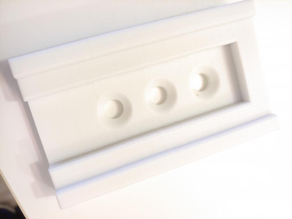

Hi, just wanted to share a little housing tool I built for sharpening screwdrivers, attached the design and STL files here along with pics. Works pretty well for me.
It fits Dan's Arkansas Pocket sharpening stone (3" x 1" x 1/4"), which is very affordable and comes in many grades. Has drainage holes at the bottom, in case you choose to use water for the stones. Also has walls/edges to prevent the wheels from running off or over the stone, like a railroad track.
sharp1.thumb.jpg.9462536ee5ceefaa1b0c010c29538f0a.jpgsharp2.thumb.jpg.987b67ec9b90427e5243dd485274c267.jpg
sharpener_v1-Body.stl sharpener_v1.FCStd

Oh! What a great idea and nice setup. I was also wondering about arkansas stone and I struggle to find a good one with the right size and setup.
Now to order them and find someone to print the holder.

UPDATE: I realized that not everyone uses that same sharpening tool as me. So I updated the FreeCAD design files such that users can manually input the width value as they please. The width is the sharpening tool's wheel to wheel distance with the smallest screwdriver inserted. There is an additional +5% margin added for clearance, this is also in the spreadsheet.
Attached the design files, and several pre-generated STL files with different widths. Its still the same design as before, just with a parameterizable width. If you don't care about the size, then just pick the biggest one.
sharpener_v2.FCStd sharpener_v2-42mm.stl sharpener_v2-40mm.stl sharpener_v2-38mm.stl sharpener_v2-36mm.stl

I received a set of 2 Arkansas stone (M and F) like yours and I ordered the 3D printing, will be done this week. I also added a small design for a 20mmx20mmx50mm block to file the blade edge perpendicular to the stone to finish it that the 3D printer designed for free. Made from nylon as it's most durable.
I will post pictures when I pick the parts.

I like the guide rails for the honing guide. Well done!

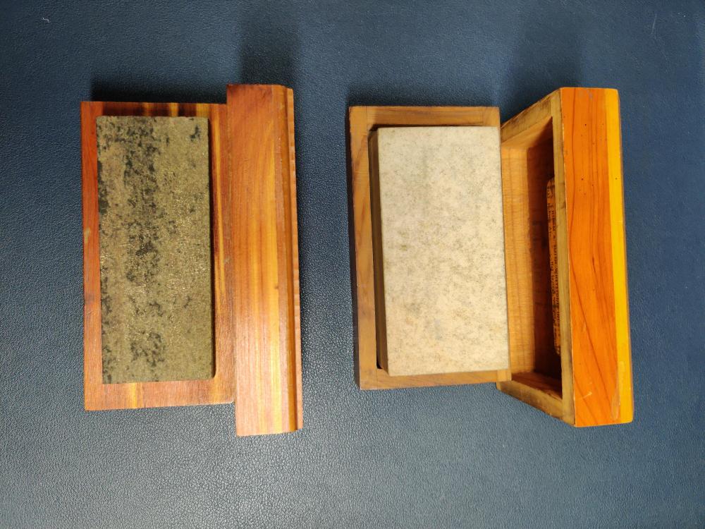

I have a Hard Arkansas and a Medium Arkansas that I've had for years and years, I usually use the medium for screwdrivers, makes quick work of them.
I also have a large assortment of carborundum (India?) and diamond stones, but still use the Arkansas stones for most everything.
I worked on some brass tweezers on the medium stone and ended up with some brass embedded in the stone, won't do that again 🙂

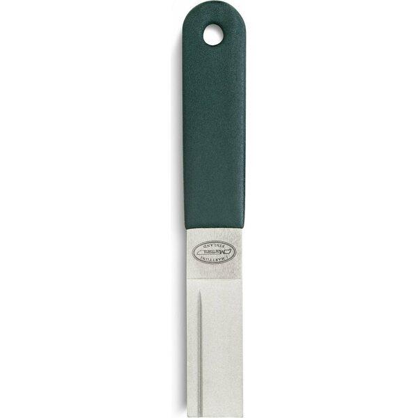

A Finnish friend gave me one of these Marttiini pocket diamond sharpeners like 18 years ago and it's what I've used for screwdrivers (and tweezers except really fine ones) ever since. Freehand, takes less than a minute to touch up a blade.
3 hours ago, LittleWatchShop said:
I will probably get run out of town on a rail for admitting to using these for sharpening my drivers.
That's the exact same thing I have in the photos above, just smaller. I think mine are something like 8"x3" or thereabouts. They were one of, if not the largest size plates they had at the time. Stand up to the hardest alloys, stay flat forever, and it's easy to clean out the swarf. I use dish soap in tap water as a lubricant, and chase each sharpening session with a coat of jojoba oil.
