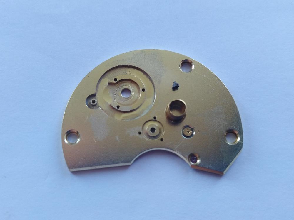

Hi Clock and Watchmakers,
I got a key wound pocket watch and I don't know how to remove the second wheel from its plate and i wanted. Is this things fraction fitted? How could I remove it without damaging it?
My best regards,
lui
ps: note that somebody has replaced a jewel with a home made bushing seen on the third pic
IMG_20210714_131544.thumb.jpg.fef33bc7777e286a6eab20a754f86e17.jpgIMG_20210714_131623.thumb.jpg.7b784154c28c6666c18206196fa1a818.jpgIMG_20210714_131602.thumb.jpg.ddeb13b6c492ee1d25b86c6bf64df9f2.jpg

Hi John,
thank you for answering me. I posted a closeup which might help, i desperately need some success here and I don't want to brake this. I also think that something is wrong with this setup as there was no protruding pin when the canon pinion was on. Yes the watch came with no minute hand. PN= pinion?

I would like to try to help.  May I ask some questions first?:
- I see three holes in the bridge plate surrounding the second wheel's square key dog.  Are those screw holes?  For a screw-set jewel bearing?
- The wheel is all riveted together, so the square key dog is too large to be simply pushed through the pivot hole in the bridge plate.  It must be applied to the shaft from the other side, after the shaft was inserted.  Can you tell if the square key dog is only pressed onto the shaft end, or if it is pinned, or if some other method was used?  Ideally,  the square key winding dog should be of one piece with the shaft, but I cannot see yet how that can be the case here.
occasionally I've seen this staking set would be really nice here. You can use a bench block but whatever you do you have to make sure everything is flat because of anything as protruding on the other plates you risk damaging stuff like of the balance bridges farther out in the main plate you to break the balance staff. Another way you can do it is the holding your hand? Then gently whack it with a hammer.
If nothing is sticking out then staking sets nice pointy punch gently push in the center to get it to start to come out. Because trying to pull the canon pinion off this friction on can be a challenge.
to give you an idea I was looking and were lucky I have something on the bench. You'll notice that the  end was protruding out of the canon pinion. In this particular case I guess held it in my hand because it wasn't convenient arrested on anything and gently whacked the protruding pin. You'll see a series of photographs this should be helpful.
In your particular case put the plates back together again the risk damaging things with that flopping around and trying to push it out without the right supports you still risk damaging things.
Then if you want absolute proof that you do have a pin with a squarehead put something on the other end. I have your picture slightly modified notice where I drew the line that's where the pin is coming out. If you stick something on the pin parts and rotate the square you should see it rotate hold the center wheel while you're doing it the center wheel is basically a tube.
you will note that mine is slightly different than yours in that the washer is in a brass part. That's so that when you're using your key you hopefully don't slip and scratch the plates up.

Thank you all. I really appreciate it. Now it is taken apart. The bridge is dead flat, i gently hit the shaft with my hammer. Barely touched it really and it came apart. My theory is that it was already moved a bit possibly by a key jammed on the square. It would explain why the minute hand lost and why was not protruding pin above the canon pinion.
