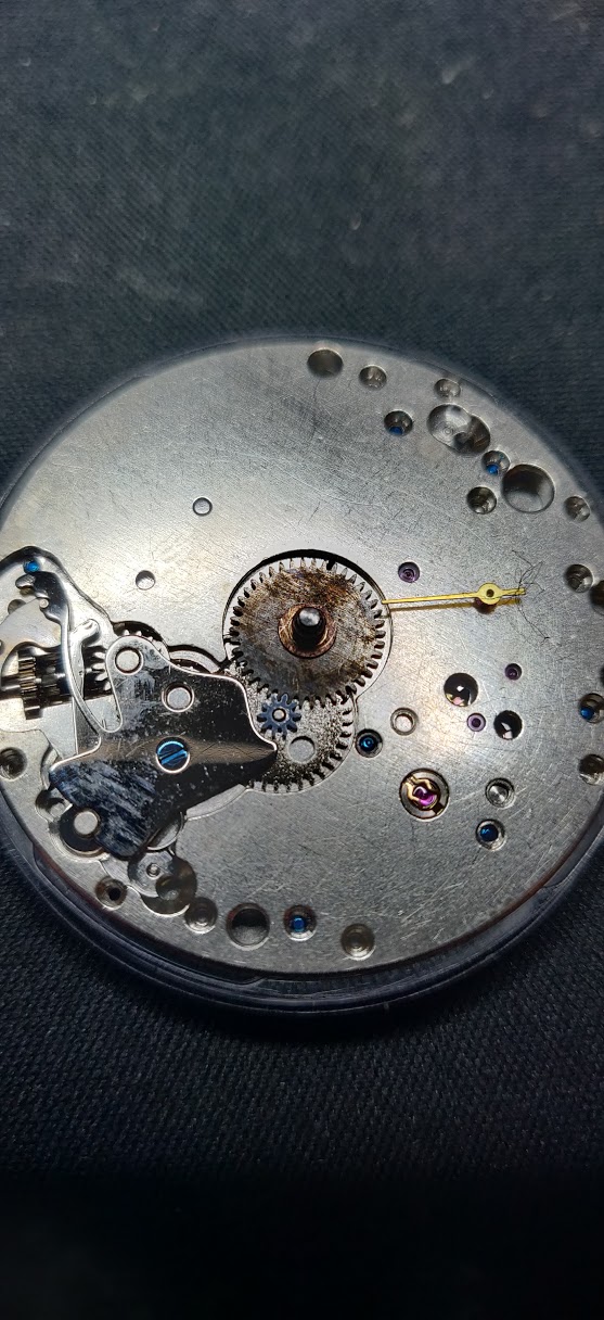

Thanks for this post MikePilk, I just came across a similar problem with an Omega 1022. The problem I had was the seconds pinion spring was bent out of shape and did not even engage with the wheel properly, so the seconds hand was not moving at all. (no power loss though :) I removed the automatic module so I could access the spring and work on it. Once I bent it back close to the right shape, I experienced the same problem you reported about power loss. Many tweaks later, and the seconds hand is moving properly again, with amplitude back to good numbers again. Cheers
