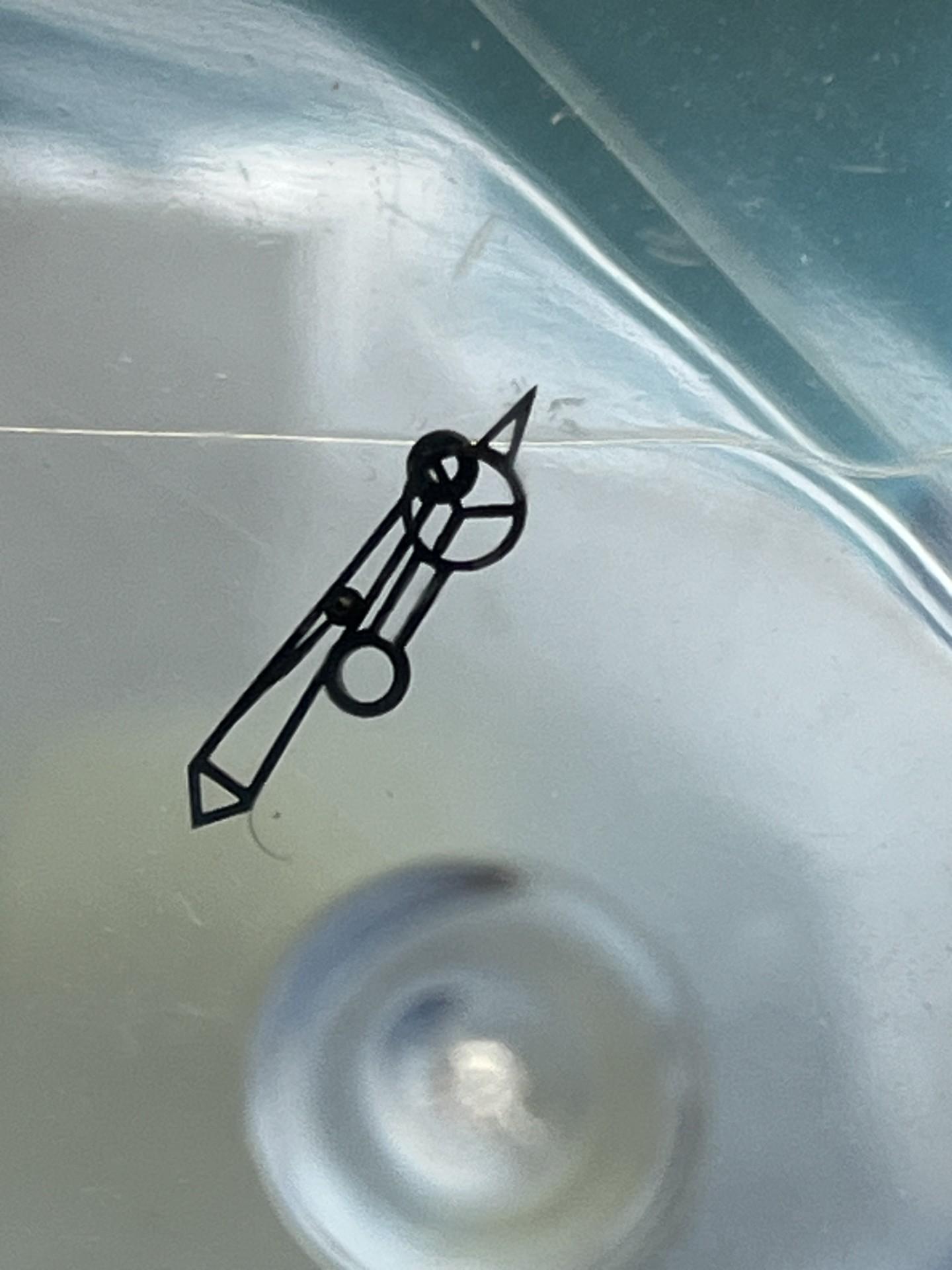

Wondering what everyone’s method/material is for color matching very old lume on watch hands. I don’t want it to glow, just refill the hour hand to match the old minute hand, as the radium ā€œpaintā€ is gone from the hourĀ hand.

Before I start down this path of painting vintage watch hands I thought I would check in and follow up on a couple of the comments above.Ā  @WoolshireĀ How did your hands turn out using the flat enamel paint? In order to get the vintage look I was thinking about mixing some brown and yellow with white.Ā  If that doesn't work I might also try the chalk and lacquer as mentioned by nickelsilver.

…I just did orange to cover major surgery on this chrono seconds hand. The original orange has a textured appearance that looks like cerakote. I added a bit of texture powder to testor paint and it passes the 30cm test, though a touch too clean…
IMG_0503.thumb.jpeg.cda5216ceee40dbffacdd76b1345ac0b.jpegIMG_0505.thumb.jpeg.f95f88bbce381089bbe0920f3aa5d04e.jpeg
