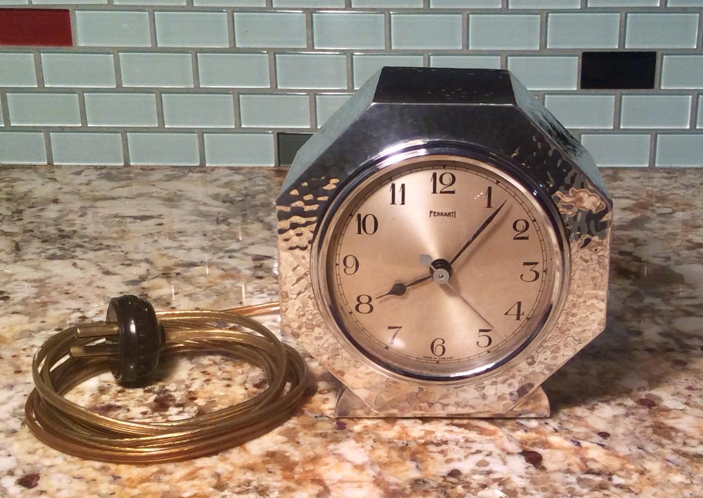

I’m not sure if you’re still mulling over this, but I noticed your comment about whether or not to polish your octagonal Ferranti pewter clock.  I purchased one a number of years ago and decided to polish it.  Thought I’d upload a pic of it for comparison.  Pewter is usually left with a duller finish, but I liked the shiny, almost mirrored look I got with gentle buffing wheel + simichrome
