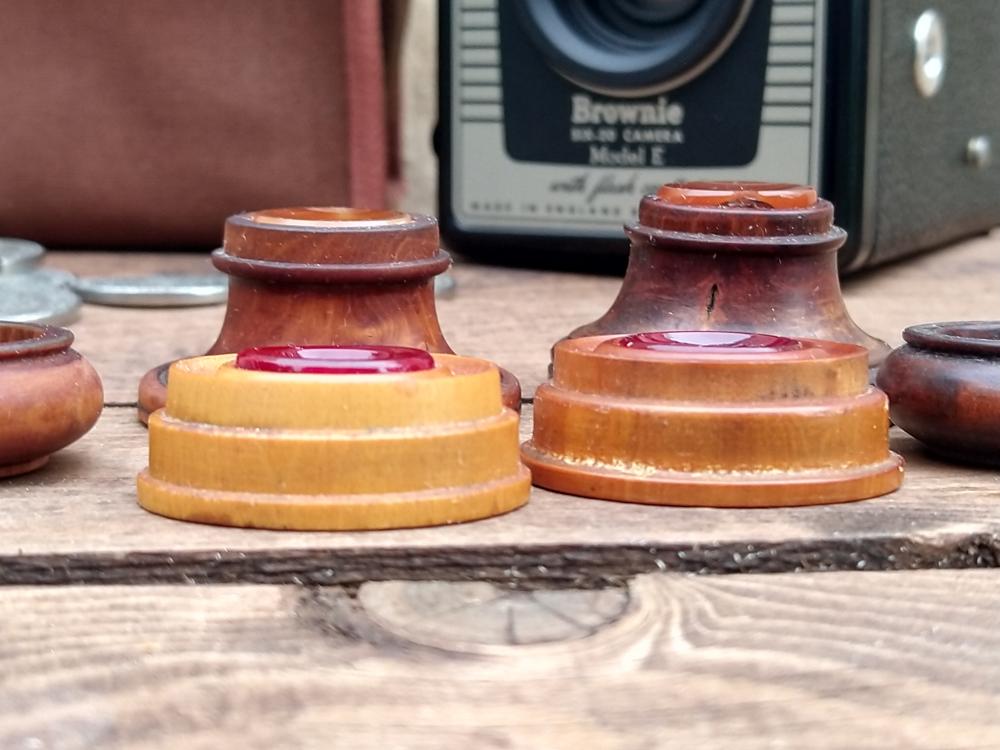

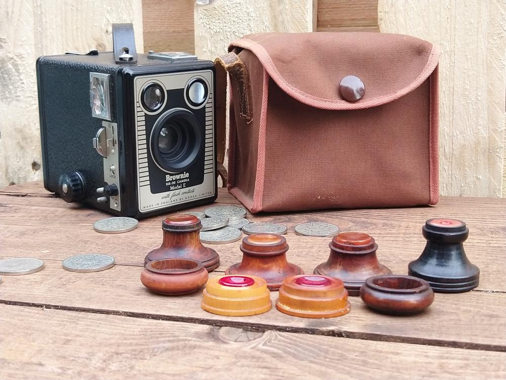

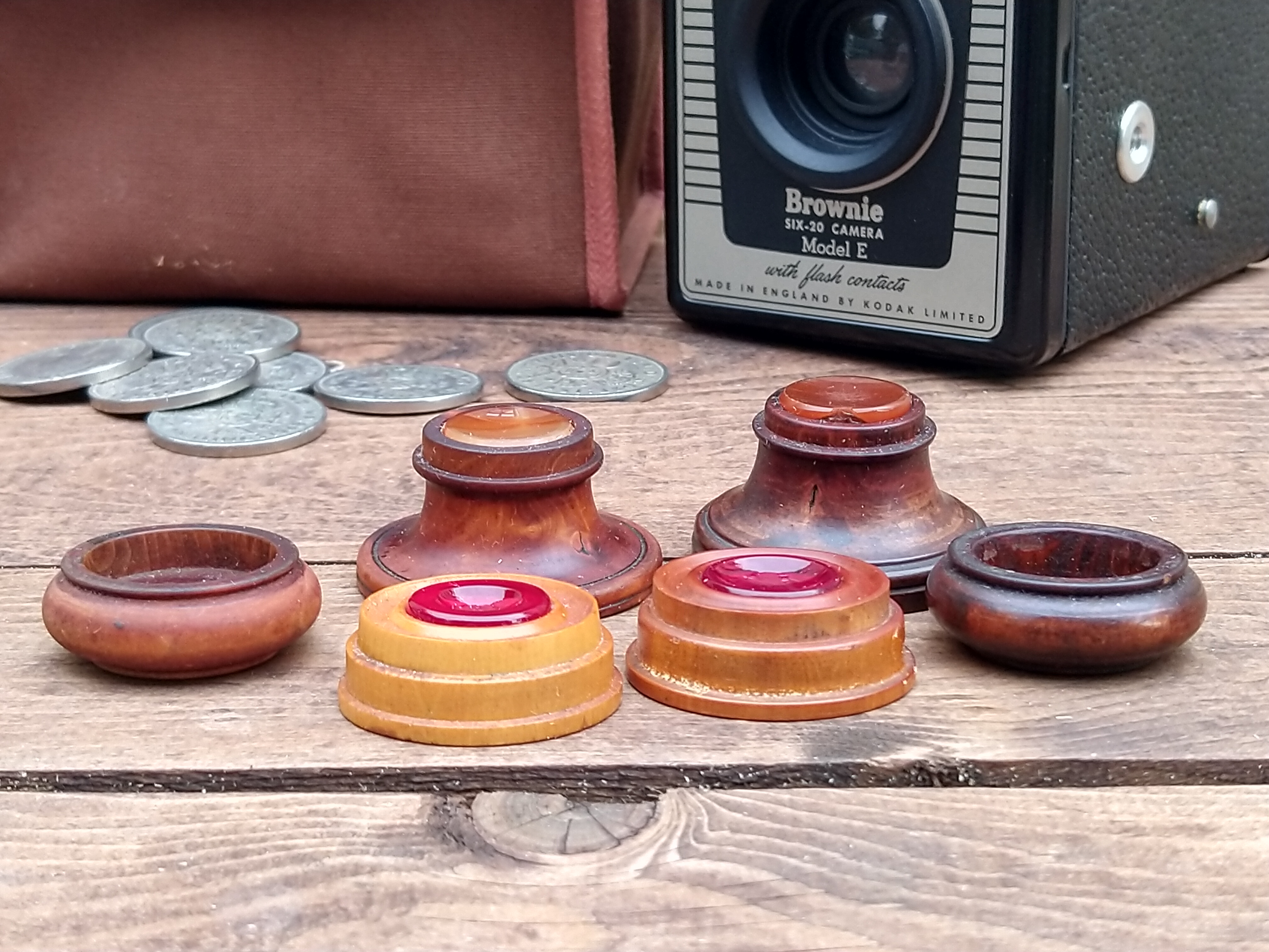

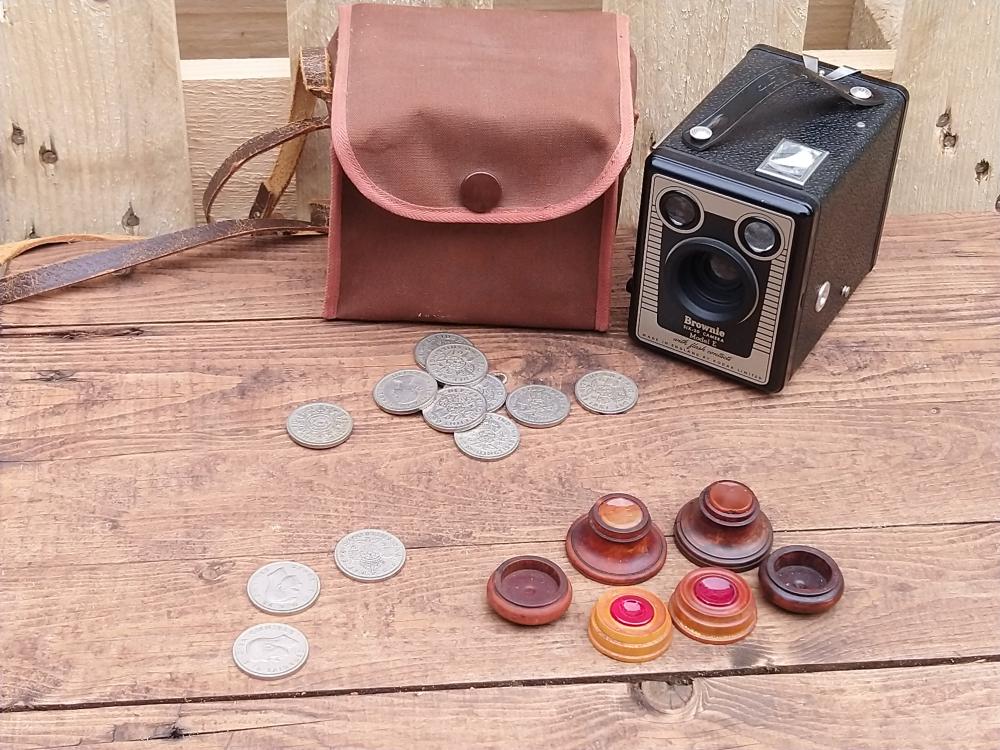

I have received this beauty today. Would you know how and where to buy the insert? The oil cup, which somewhere mentioned as agate cup somewhere as glass cup? I have been thinking about this for a while now as I have a lathe. One option would be to buy a stand with 3-4 cups and cannibalize them, but it would not be very cost effective. Any idea?

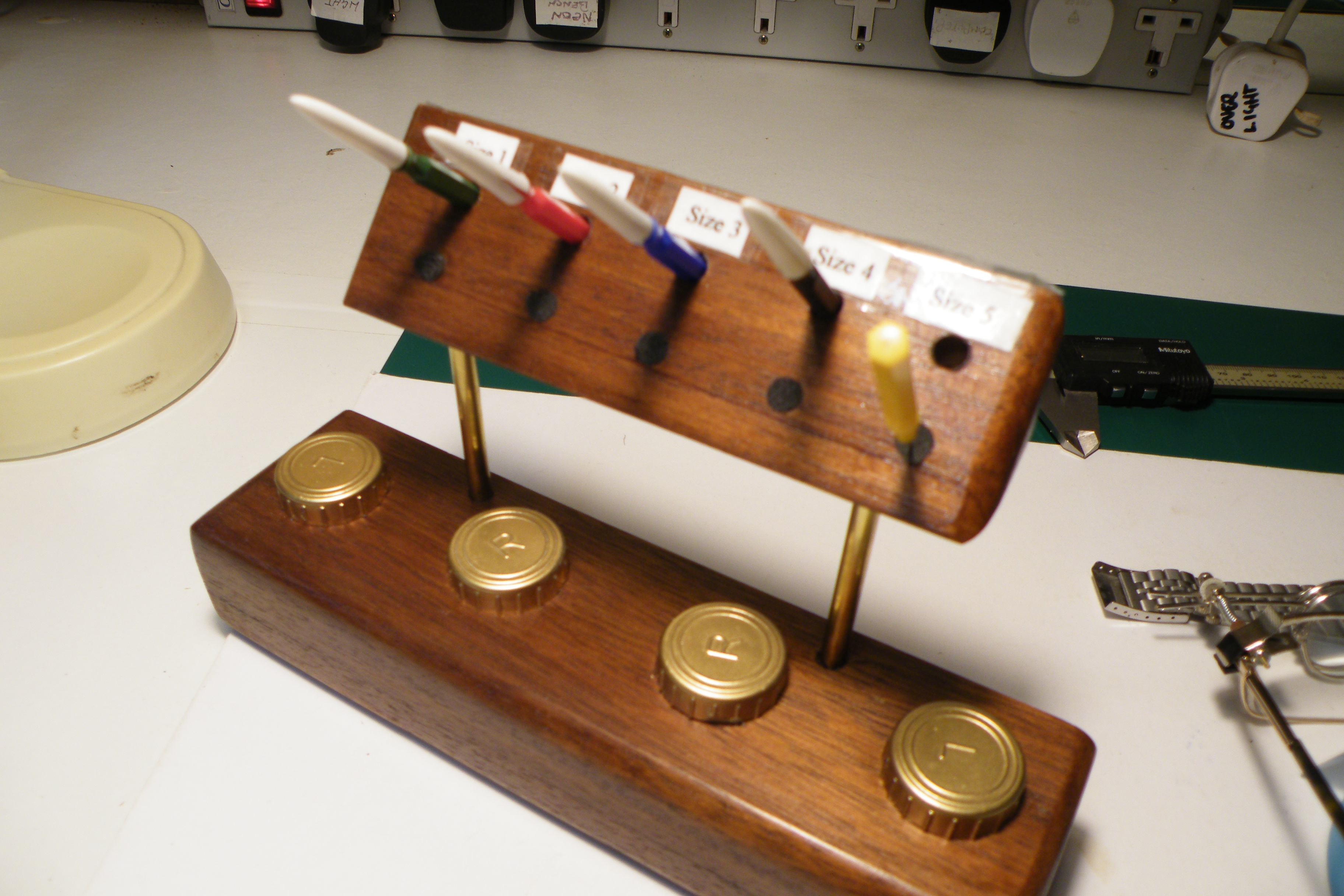

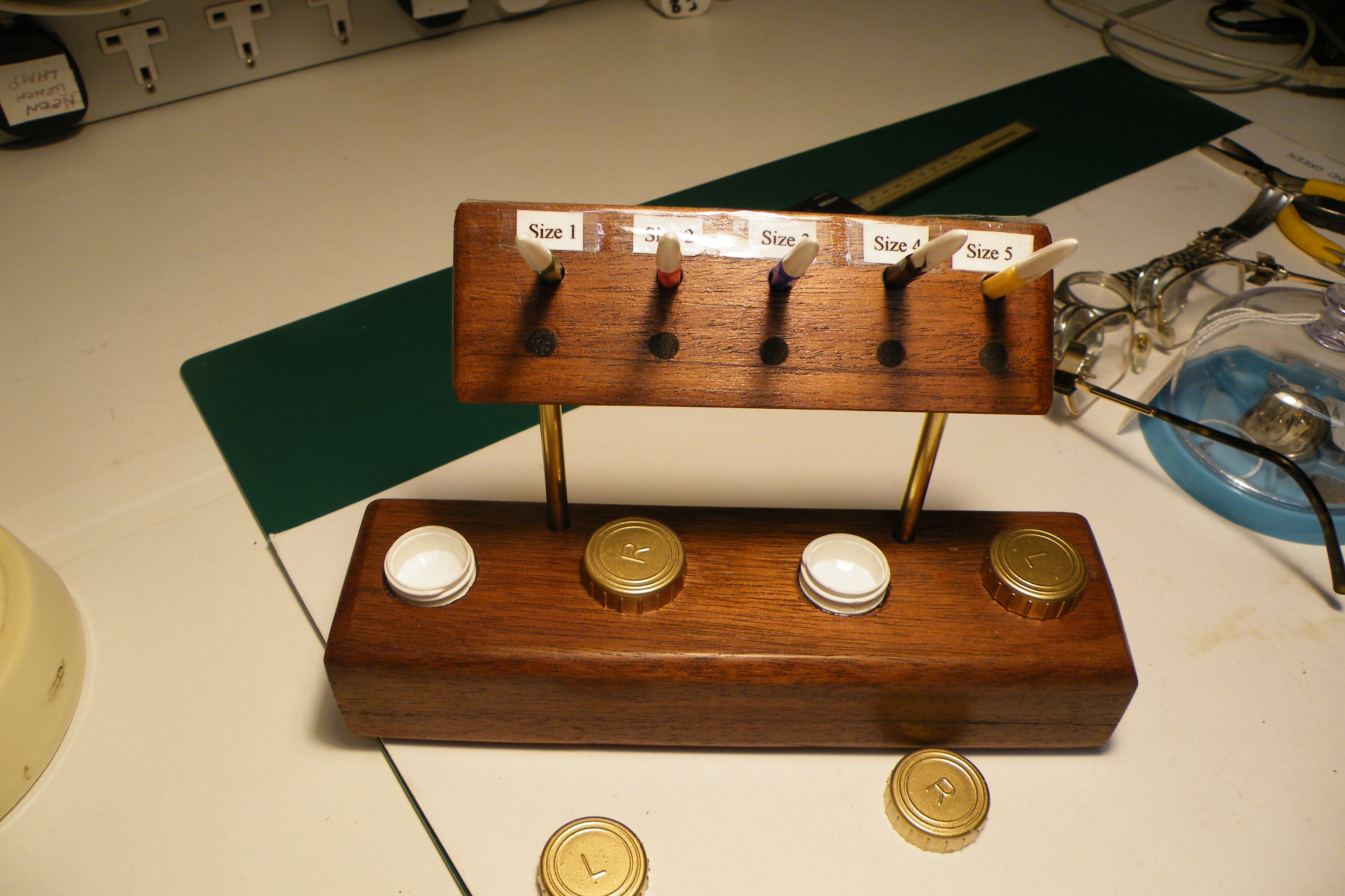

Hi  That a vintage pot, Glass in a treen case, too good to use its a collectors item.  I made my own stand and used contact lens cases as oil pots. They have a hard plastic coating so as not to damage the lenses and screw caps. If they should become damaged  they are easily replaced at low cost. will post photo if required.
I have a vintage bergeon with four cups, the lid closes on them. Bought them used.

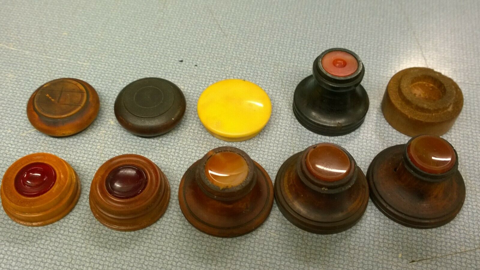

Beleive it or not, cups wear out, glass have gotten scratched up, pitted.
Be careful with it, I guess you should avoid poking the cups with the oiler don't use  screwdriver as oiler if you work on clocks.

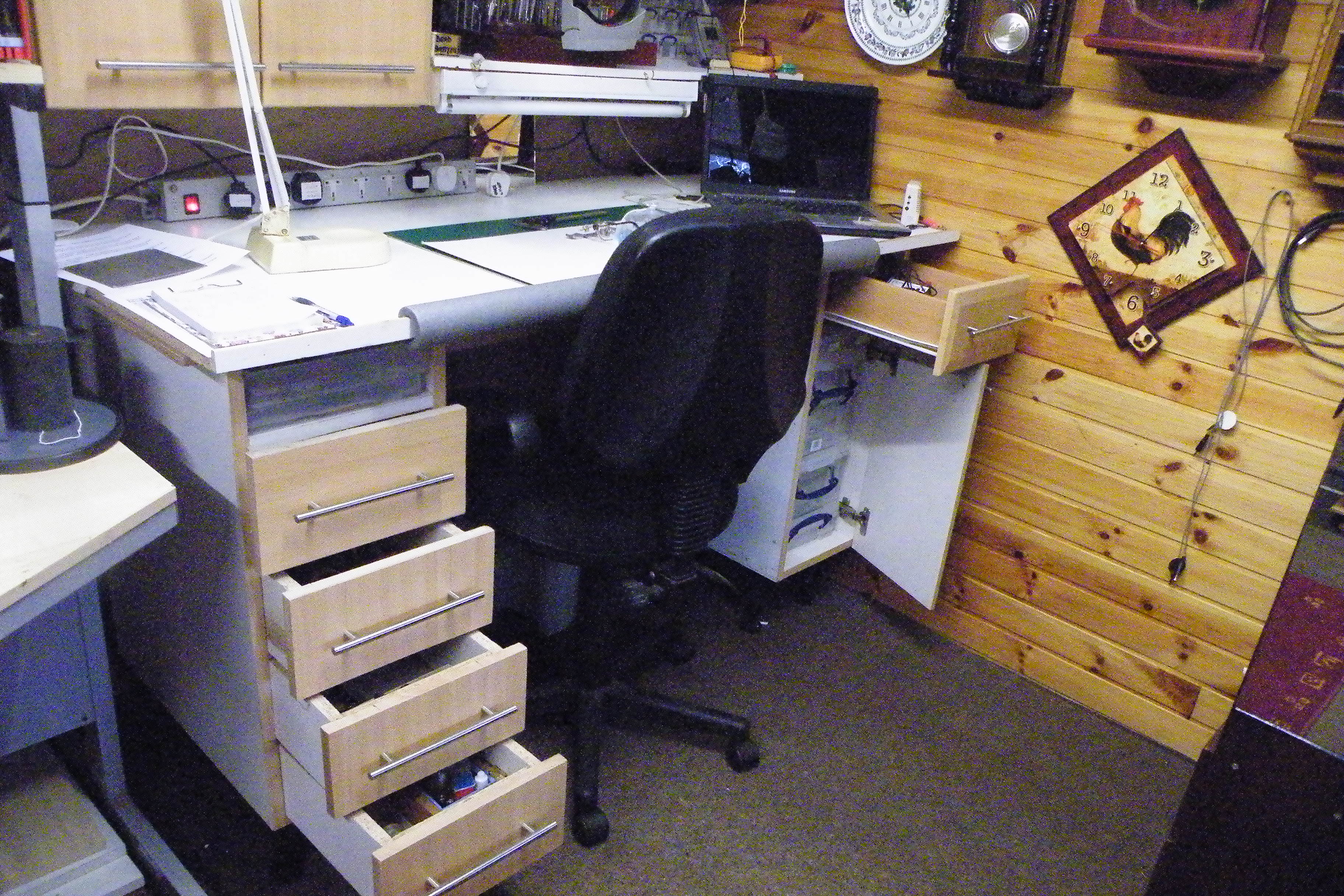

Hi Luiazazrambo     attached below is the oil cup stand and oilers made from the contact lens cups and one of the workbench build at zero cost from redundant scrap cabinets. Made the drawer unit and modified the cupboard.  the oilstand also zero cost apart from the investment of time.
  • Thanks 2

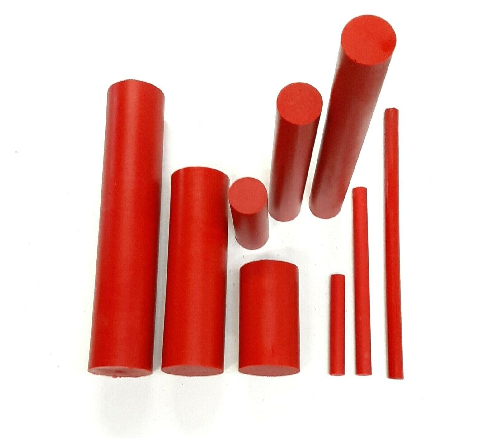

I watched a youtube video posted by OH - i think - earlier about a clock repair and the guy made oil cups out of brass or copper rods. So that's another option. And another one i saw that a guy used red nylon rods and again a lathe to make oil cups - i dont know if it would react in any way with the oil / grease stored in it.

Oh, Lovley watch den! ?

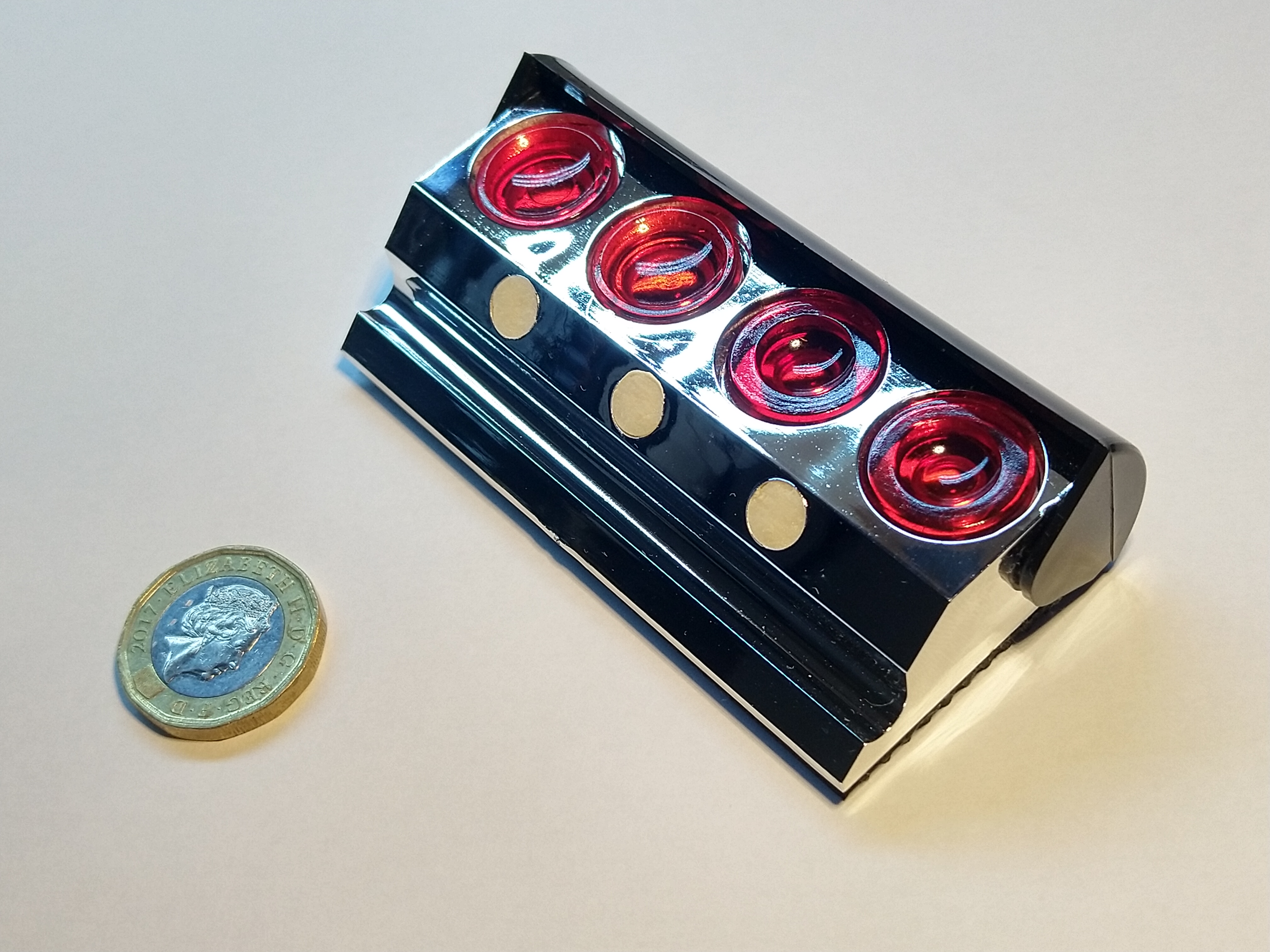

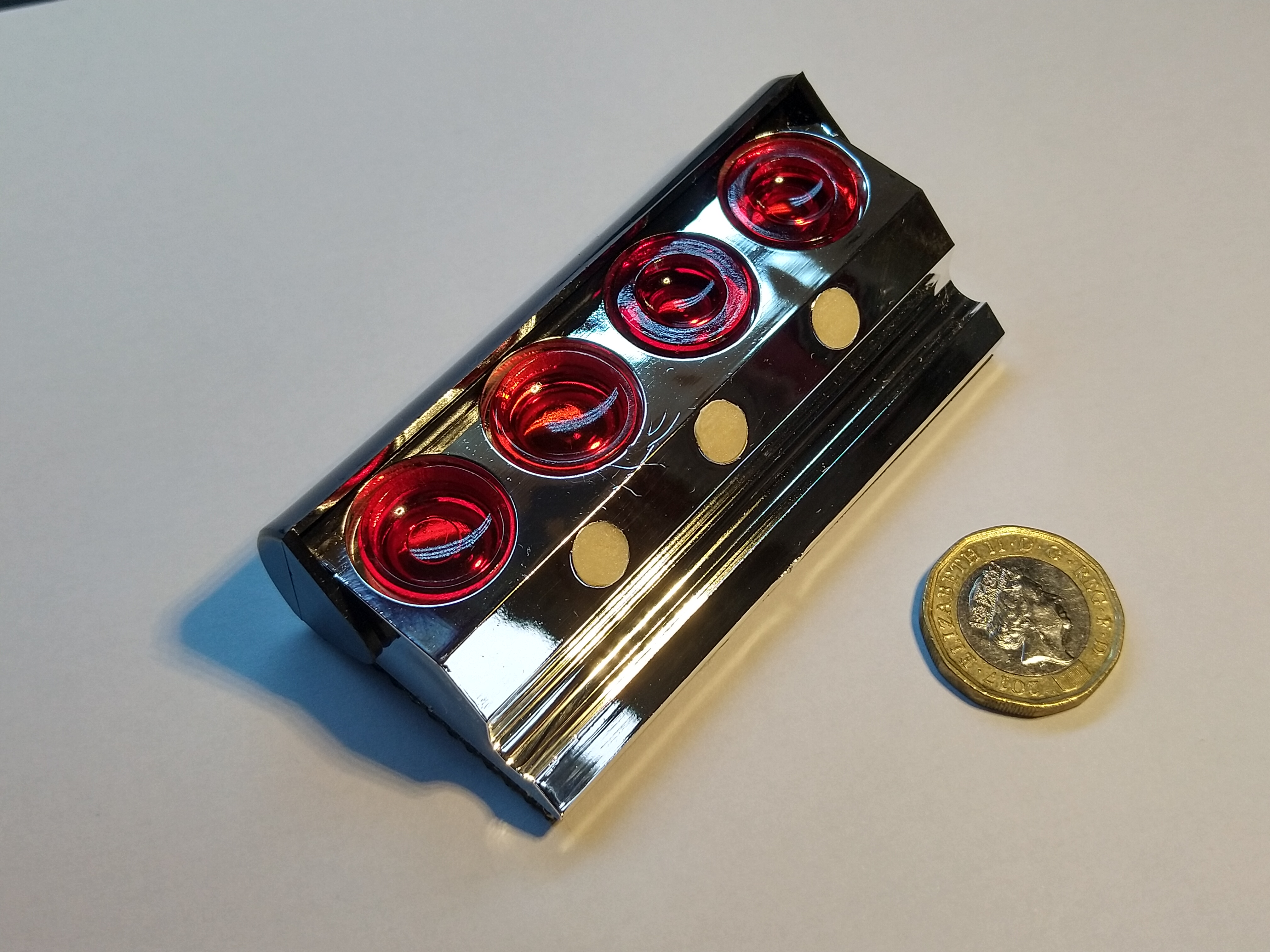

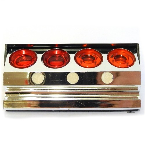

I managed to take this stand apart tonight. Lid and base are plastic, it has a rubber mat glued to the bottom and there is a weight glued to the rubber mat from the inside for stability otherwise it would be lightweight. It seems that the red glass oil cups glued into the holes, i could not remove them so it is not possible to replace them and there are only two sizes 2 x 2. The plastic body feels and looks the same way how those chrome? plated plastic toys look and feel. It is not produced by horotec by the way, but a supplier.
It was:
Subtotal£21.95
Domestic 1st class£3.00
20% VAT£4.99
Order total£29.94

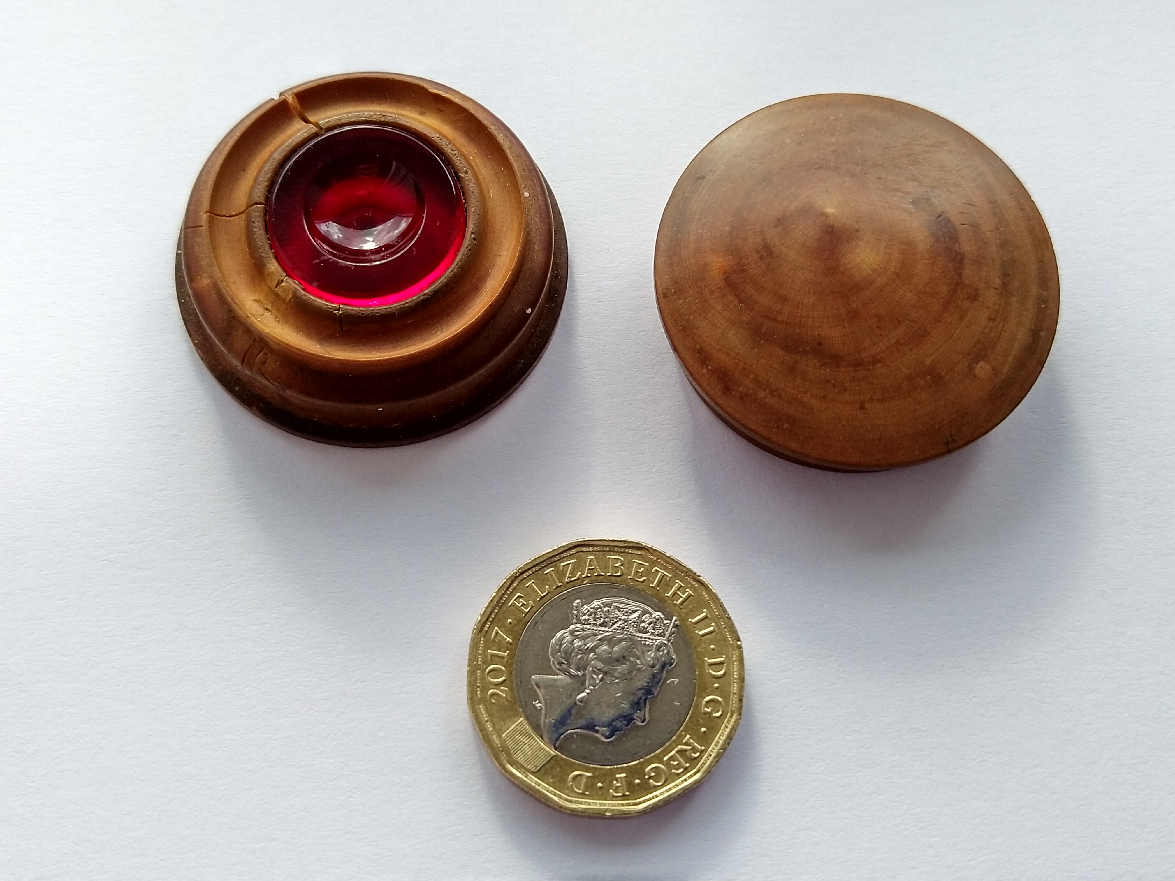

It is small and seems to be stable. Its an upgrade for me, but some ppl probably would not like it. If I manage to turn that treen case thingy i might get the red glass cups out of it by braking the plastic case.
