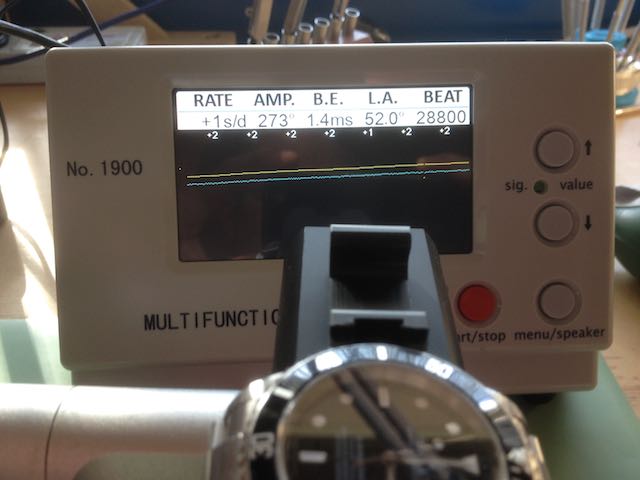

STRANGE ISSUE. before the service this watch was running consistently (never off my wrist for the 6 years) + 20secs. a day. So I purchased a microstella tool expecting to make regulation adjustments. However when I put the watch on the timegrapher after the service it showed either 0 or +3sec. depending on its position without any adjustment.

I also get a very brief bit of snow when changing position so I guess there might be a end shake issue with the balance but this is beyond my abilities at present

As a matter of interest, what was the amplitude before you serviced it?
I am not 100% sure but if my memory serves me correct is was approx.270. However I could not find the correct lift angle for the 3135 so kept the timegrapher set @ 52 deg.
I did not write these figs down which I normally do. It is a small mistake made by me but it was and always has gained 20+ secs a day until now.
If it was 270 before and it's less now due to the new spring being fitted, that might have explained why it is running slightly faster now. I'd like to hear some others thoughts on this.
Thanks Geo, I feel a bit of a plonker really I always put a running watch on the timing machine before & after but I got so involved with getting the correct lubrication, correct tools, etc,etc.  I forgot this bit. I am confident that all is assembled correctly the only thing that has crossed my mind is did the auto oiler oil the bottom escape jewel correctly as I have never used a auto oiler before but did lots of tests before using it.

If you could adjust the beat error closer to zero i think the amplitud will go up . Btw i found watchguy service of a 3135 and he has 52 degrees on his timegrapher to . http://watchguy.co.uk/service-rolex-oyster-perpetual-datejust-16200-calibre-3135/ . And the lift angle is http://hiro.alliancehorlogere.com/en/Under_the_Loupe/Rolex_3135
That's interesting Rogart, but what would you rather have 3 secs a day with BE 1.4 or 6sec a day with BE 0.5? I know what I would rather have. :)
