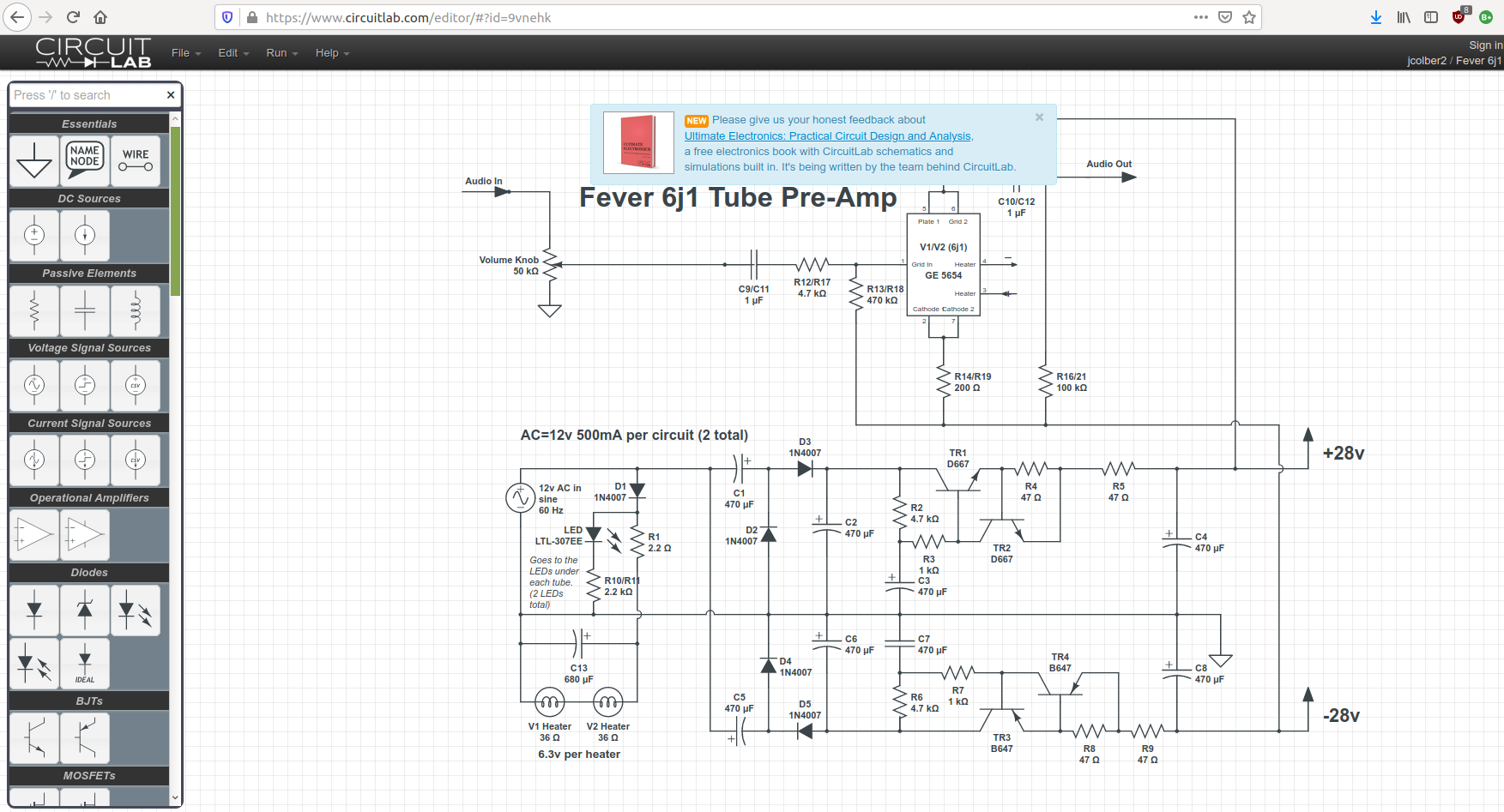

In the middle of a similar project. A cheap-o Chinese 6J1 powered phono preamplifier purchased on Ali-X. Showed up with broken tubes, so I got new ones (after a refund for the amplifier was received). Once I fired it up though, there's no gain at all. My guess is that there are some incorrect or misplaced resistors in the gain stage, but I can't for the life of me find a schematic of the little **BLEEP**! If I want to make it work, I'm going to have to take it apart, make a schematic from scratch as it sits, then math it all out to figure out what the values are SUPPOSED to be, THEN if I'm lucky and it's just a component transposition error, put them back where they should be. If I'm not, I'll have to get really lucky to find a proper resistor in my stash or wait until the next time I need enough components to warrant the shipping cost.
I might take a slightly different aproach, and simply search online for 6J1 amplifier schematic.
There are dozens of similar amplifiers, but they all tend to use the same basic schematics.
For example.

In this particular case, it looks like the component values are actually screen printed on the board under the components, it's just not readable with the components installed on top of the printed values. I'll probably desolder it some day and see if I can't find the errant resistor values, but at the moment it's cost me nothing but some time, and can sit in a cubby in my desk for a while until I get my electronics tools back out for some other thing down the road.
Meanwhile, I decided to take a different and more deliberate path to phono preamp fun. I found a proven schematic online utilizing better quality components, and just need to find time and hobby funds to make all the parts show up on my desk. It'll be much higher quality all around.
You might also find this link useful.
https://www.circuitlab.com/editor/#?id=9vnehk
BTW you do know that the circuit typically uses a 12V AC power supply, not DC, as it needs to use a doubler to make the +/- 28V supply rails. If you feed it DC, the tubes will light, but the thing wont do much else.
EDIT: Given the low power nature of those two dinky little tubes, I doubt if the thing will be capable of much output anyway. Fine as a headphone amp, but not much use for more than a few hundred milliwatts, maybe a watt max. The nearest equivalent non Chinese tube I could find was capable of a maximum dissipation of 1.7 Watts, so allowing for losses etc. you wont exactly be able to crank the thing up to 11 and annoy your neighbours.
https://www.radiomuseum.org/tubes/tube_6j1.html
https://media3.giphy.com/media/3o72F8t9TDi2xVnxOE/giphy.gif
It does want a 12V[b]AC[/b] supply... I'm so used to DC supplies that it didn't register... I just assumed they were relying on a DC power supply for rectification to cut part count and costs, and the doubler never registered in my mind as needing AC... There was exactly a sum total of 0 documentation with the thing, and the ad copy was just bad chinglish. I tried to find a schematic for this particular amplifier, but never quite found one that matched what was in front of me. OK... So maybe the first step here is to find a suitable power supply...
You may already have something lying about that you could use. If you have an older style non switch mode 12V wall wart, you may be able to grab the AC voltage before it hits the bridge rectifier.
Failing that old computer modem power supplies were often AC, as were some older desk phones. I doubt if the voltage is critical, so 15V AC would probably work just as well.
