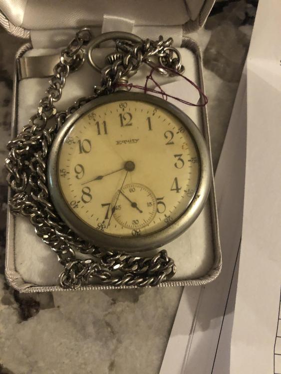

Like my last post, I have another pocket watch that is not working right. When winding, it makes a slight sound so you can hear it clicking, however does not get the watch running, and won't even wind the mainspring. I know that this must be looked at by a professional, but is there any way I can at least identify the problem so I can figure out how much it'll be to fix it? Thank you for your help!
5 minutes ago, TyJlovespocketwatches said:
.I know that this must be looked at by a professional, but is there any way I can at least identify the problem so I can figure out how much it'll be to fix it?
Identifi g the problem will not necessarily let figure out how much it will cost to have fixed. Speaking practically there is no way that a serious professional will do any repair for less than 100 usd/eur/gbp. Then add the cost of parts and an hourly rate after the first one or two.
Anyway since your watch never stops winding, it has a broken mainspring. Of course it may have other damage too.
Thanks! I just wondered if it could narrow things down. I checked in the back of it its fine other than not winding. Ill have to see if I can get an appointment soon. Thanks again!

it would be nice to have a picture of the watch so we know what were talking about.
2 hours ago, Nucejoe said:
A broken mainspring or disengaged from arbour hook.

so let's just make oh wild assumption based on the symptoms and everyone else having the same answer it's probably a new mainspring. New mainsprings typically require a complete overhaul because there is probably something else. So you're looking at a complete overhaul and a new mainspring. depending upon where you get your mainsprings a wholesale price might typically be around $30. Then the silly watchmakers think you're entitled to a profit they will probably mark that up. A lot of times they might double the cost of mainsprings now $60. Then the watchmakers thinks they're entitled to make money how much they charge for a complete overhaul will vary on a lot of factors. Like where is the watchmaker located in expensive location like downtown New York for instance the rent be rather expensive they will probably expect a lot of money. Versus the watchmaker operating out of a farmhouse doing it for the fun in the middle of nowhere will probably charge less perhaps then if you're not dealing with the watchmaker directly are going to a jewelry store who sends it out to the watchmaker they typically double the price.

I would do pictures but as i said before, cant figure out a format anyone can see lol. I was just trying to figure out what was wrong with it. I know how to replace a mainspring, and was hoping that was all.
Thanks for the help yall! Im just gonna do the same thing as the last watch, take it in hoping for the best. Its been great getting help from yall, but I know things get limited when I cant post pictures. even if I could though, wouldn't make much of a difference as I cant get the back off.
Here is an image yall
