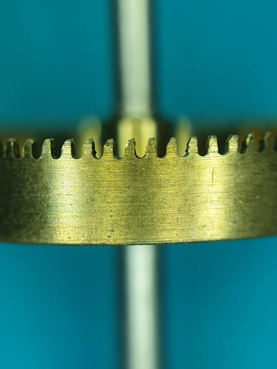

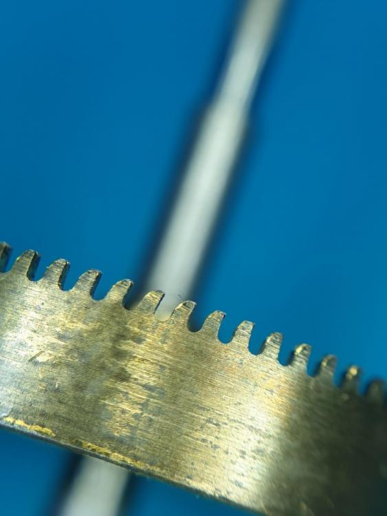

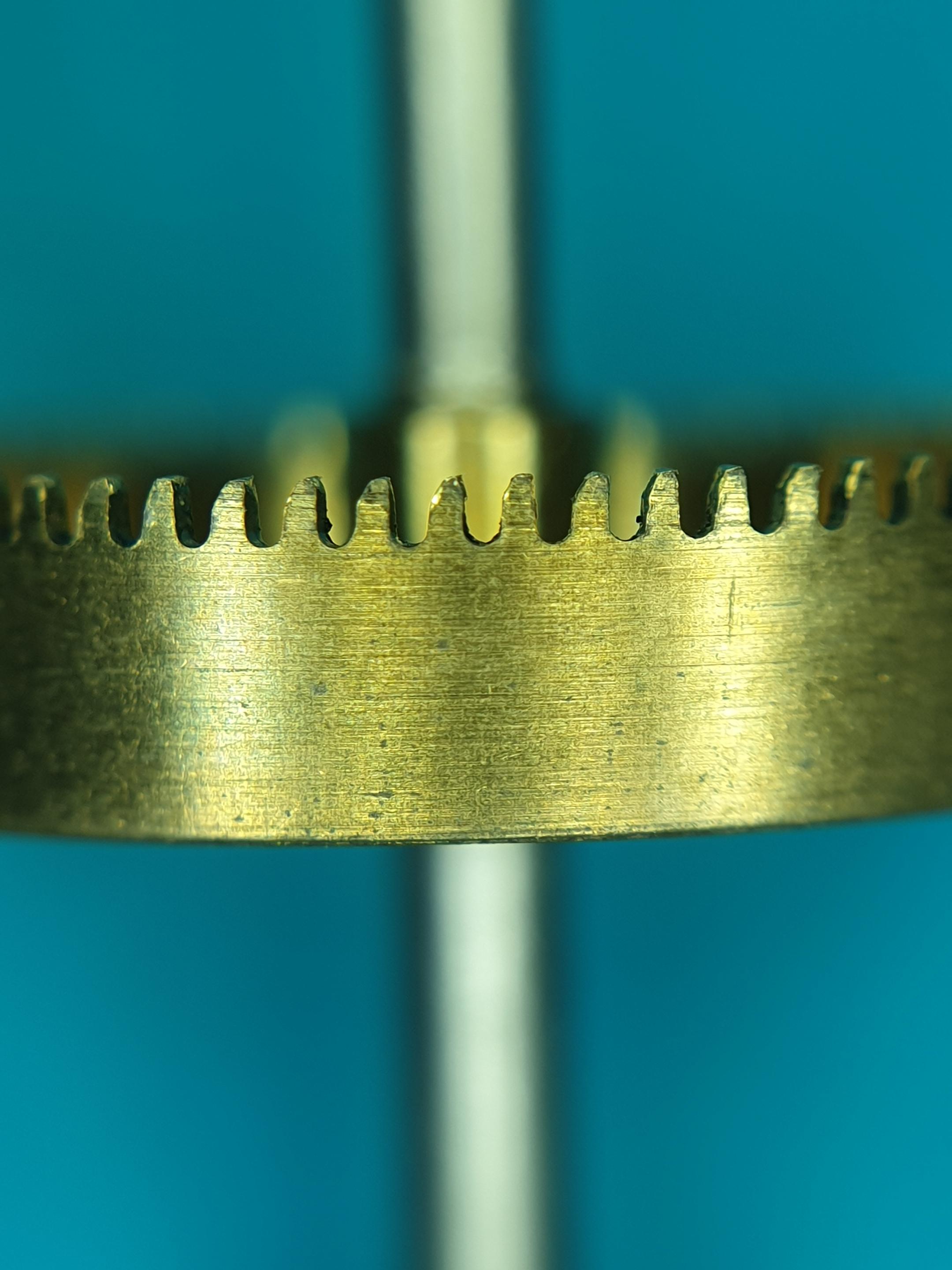

I just took apart my Russian Navy clock for cleaning and to check why it was so loud. I discovered that the escapement platform had loosened and the meshing of the teeth of the 5th wheel to the pinion of the escape wheel had drifted. This resulted in damage to the 5th wheel.
Can I fix this by filing the teeth with a needle file? I don't know if there are replacement parts available for these clocks.
Looks like the contrate wheel. This is a hit or miss situation. You might get away by filing the teeth into shape, but you might also file away some depth, in which case you will need to alter the depth of the wheel, that then might stop the wheel because the depth will be too deep for the teeth that have not been affected. The best solution is to have a new wheel made.
Hi Hector I have seen videos of teeth being straightened up using a tool like a screw driver in the dwell and gently levering the tooth straight. II have done it myself on standard wheel but not a contrate wheel, In the end what have you got to loose if it works and I see no reason why not good, I not you will have to resort to a new wheel, In the end its your choice but I know what I would do     cheers

Hi they are bent , there is a definite cast to the right, a loose platform will put the contrate wheel under strain due to incorrect meshing, Running on the wheel tips causing the slight bend.
Thanks everyone. I'll try making a chisel-like tool to known the teeth back into shape 1st. If that doesn't work then I'll try filing. Last resort, I found a seller in Ukraine than has spare movement minus the escapement platform.
I also didn't believe that there was enough force to bend teeth. But it happened.
I've also seen the brass teeth of an escape wheel wear away hardened steel pallets. Clock repair is similar but so different from watch repair. :startle:
If that was wear, they would all look like that, this has been done by force due to the platform being moved while power was still on. Lucky it didn't break the escape wheel pivot.
Yes. You are right OH. The platform loosened or I forgot to tighten the screws fully after adjusting the platform.

I spent the evening straightening the teeth of the contrate wheel. I followed the advice of watchweasol and used a thick bladed screwdriver to wedge between every tooth and nudged them straight. Then filed the teeth a little to make them symmetrical.
