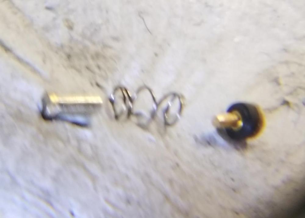

7 hours ago, clockboy said:
Remove the movement from the case. Then you should be able to clean and lub the pushers in situ.
How would you get the cleaner/lube between the sleeve and pusher shaft where I assume there is a spring?
13 hours ago, melav8r said:
you need a crown tube and pusher removal tool or press
Assuming the tube size to sit outside the pusher?
To get the cleaner in to the pusher use an oiler dipped in the cleaner and apply to the shaft, after two or more applications gently work the shaft out and in again  applying cleaner as required untill free.
tried that with some lube and an oiler. Didn't do much. Going to try the cleaner and see it it loosens things up. Thinking more of a rust issue with the springs maybe. I can push them in but they get stuck in that inward position.
 Thanks for all the input.
Figured the pushers out.The silver part is the inner piece on the inside of the case. The brass piece with the o-ring is the outer part that gets pushed. Obviously the spring sits in between. The silver end is a tube that pressure fits over the outer piece. Has a knob like end that keeps it from slipping through  the sleeve insert, which has a large diameter on the outside and a smaller diameter on the inside. That also keeps the spring retained between the 2 pieces.
                                                                             Sorry for the poor quality.
