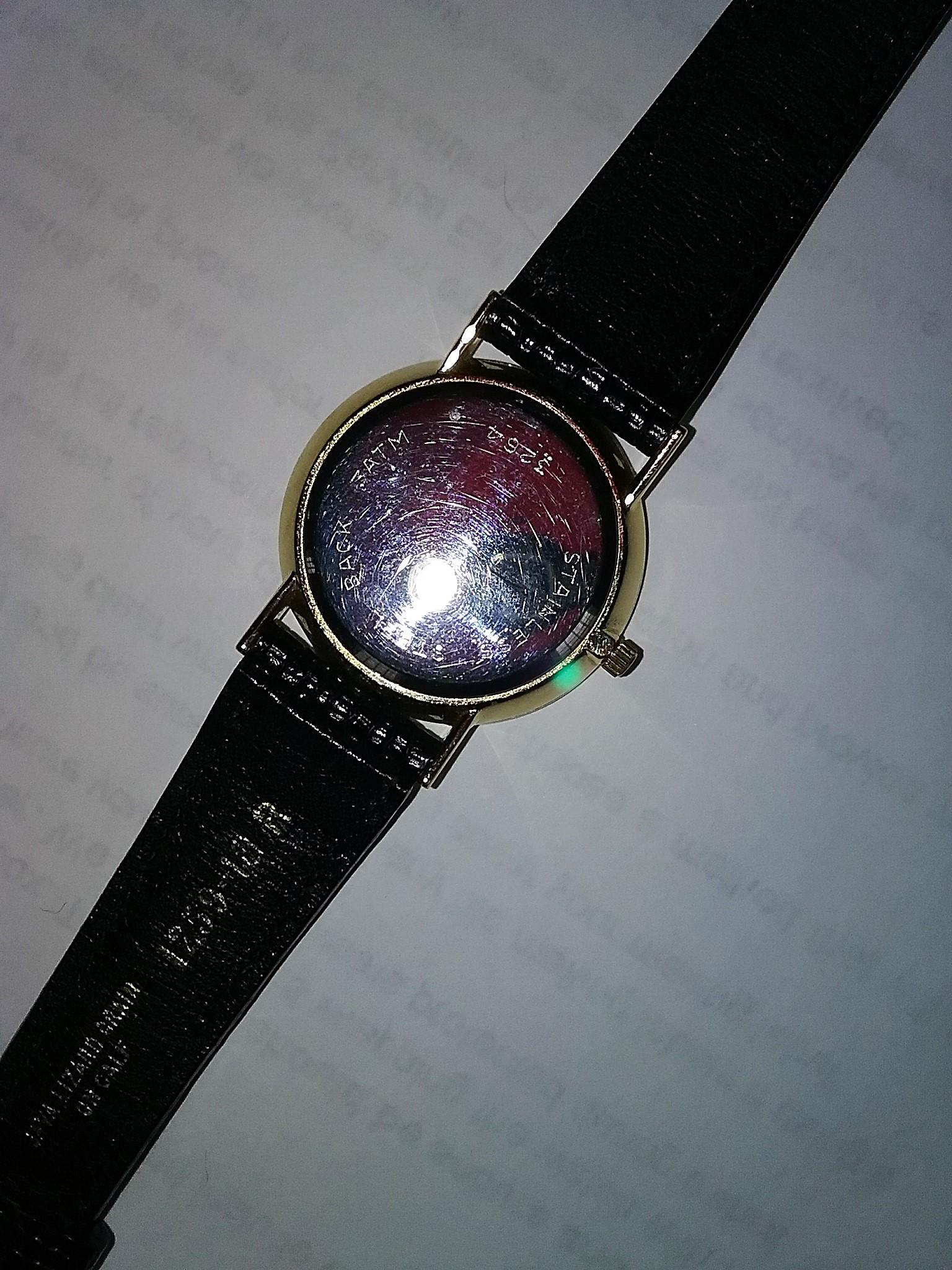

The movement is an ETA 579.105
After removing the stem, I could not remove the movement's holder and extract the movement.  The eta is firmly lodged within the solid one-piece holder - there is no play what so ever between the movement, its holder, and the case.  Upon closer inspection, the movement holder appears to extend under the perimeter of an over-lapping rim that runs the circumference of the watch case.  This rim appears to be, by design, forged as an integral part of the case itself.
Concluding the only way to remove the movement is via the watch face, I found a small indent along the seam where the bezel attaches to the watch's body, so I removed the bezel and its attached crystal.  Now I am waiting for a pair of hand remover levers that I purchased on-line to arrive...
Should I be correct in assuming the movement must come out the bezel side of the case, I wonder if this design has anything to do with the potentially ?fragile? mother-of-pearl face?  At any rate I am unable to proceed until I have safely removed the watch hands.
BTW, Glycine seems to hold their specs, even rudimentary information, about any of their back-catalog watches as though they were state-secrets.  They will, however, be pleased to repair my item, but I think the cost of transport, parts and labor would greatly exceed the monetary value of this particular watch.
Any insight you could provide would be most welcomed.
20200306_104831.thumb.jpg.3ab0fac9d2bffc6bedb05f171cd6954c.jpg20200306_104700.thumb.jpg.8d5a66adcb1c26c1be61355ebd10d264.jpg
You also need to remove the snap case back to access stem release.
Yes, I removed the stem when the I decided the movement needed replacing - my bad for not showing the back of the watch open with its stem removed.  I'm also sending a pic of the watch front with bezel and integrated crystal removed.  I appreciate your guidance.
