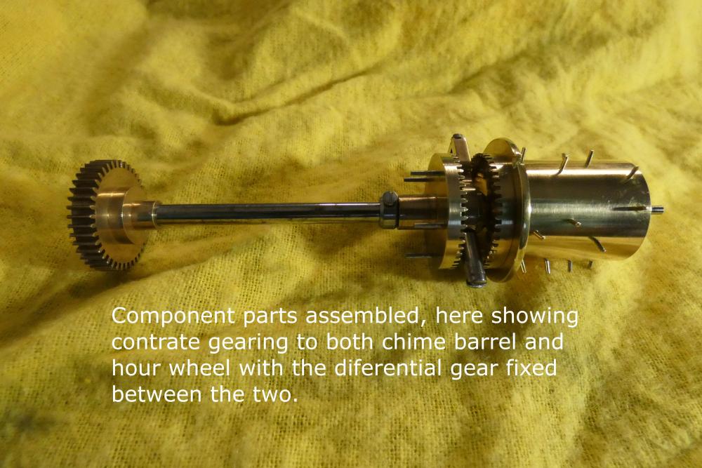

The main advantage for the use of two trains in a chiming clock was to simplify the servicing and Maintenance of the clock and reduce manufacturing costs it also allowed the movement to be much more compact than a traditional three train chiming clock of the period, although most of the mantle and bracket clocks made where in appearance no smaller than three train clocks of the time with the exception of some of the mantle clocks with platform escapement which where very compact in design.
The movement was best employed in the construction of Grandfather clocks with Tubular bells which before where very large and imposing in size, the compact design also made it practical to manufacture Grandmother clocks with tubular bells, having been recently shown a 9 tube grandmother clock by a collector that was even smaller than the rod chiming one I now own.
The key to the design is the ability to seamlessly split the drive between chime and strike, in order to do that the design has a two part contrate geared chime strike drum that allows the chime barrel to be locked and drive transferred to the strike via a differential gear as seen in the photos below:P1.thumb.jpg.8c73422110235086ae087951c390849e.jpg
side view of movement with chime strike barrel in situe
In order to lock and unlock the chime and strike a large V-shaped lever is used P3.thumb.jpg.fecaed8ed1e18d88814a7c69e0391468.jpg
When chiming the lever is pushed to the right by a spring this engages the lever with the striking wheel pins preventing it from running but allowing power to the chime drum.
The clock works in much the same way a Ting Tang type clock would it is fitted with a rack that has twin rack tails one for the quarter chime sequence and one for the hour chime/strike sequence which can only engage with the hour snail when a cut out section of the quarter snail is reached near the hour as shown below:
In order to lock the chime and unlock the strike a tension spring is employed, this is connected to the V shape locking lever and is tensioned on the hour by a pin located on the quarter chime snail this pushes the  lever to the left but is prevented from moving by the rim of the chime barrel after a full 16 note chime sequence the lever engages with a slot on the chime barrel rim locking it, at the same time this disengages the lock on the strike and that begins to run striking the hours.
At about 5 past the hour the pin on the snail releases tension on the spring and the V-shape lever is pushed out of the slot on the chime barrel and back on to the hour strike pins allowing once again quarter chiming.
