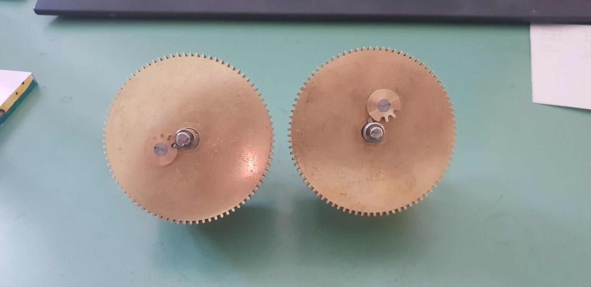

looking through my spares, in an attempt to find a barrel cover for another watch, I came across these.20200202_084902.thumb.jpg.a6193d45d58eaa64209bb2c0adf002e3.jpg  I didn't remove them from anything, I probably just received them in a box of miscellaneous watch parts from Ebay or the like.  Does anybody have an idea about what the extra details do and what they might be from, age, excreta?

The most common Maltese stopworks allow 4 turns, most springs develop 6 or 6.5 turns, so the weakest turns on both ends of wind are avoided.
The gear ratios between barrel and center wheel are also changed so that a useful power reserve is obtained on 4 turns.
Some maltese cross allow 5 turns, but more than that and the Maltese style geometry doesn't work reliably any more.

I suppose a better average spring rate, which would result in a more accurate watch throughout the day.   Sacrificing some duration in favor of  accuracy wouldn't be a bad thing and was probably considered a significant improvement.

10 hours ago, Shane said:
Was it just a mechanism to reduce the likelihood of a broken mainspring until better manufacturing processes rendered it obsolete or did it have some other benefit?
It was to use a more consistent power from the spring. In the pic (from Vintagewatchstraps - great site) you see a typical graph showing power from zero to full wind. The stopworks allow using just the "good" part.
They do also help protect against broken springs, though that's not their purpose. Since there will always be a wrap of spring in the barrel wall at full wind the stress on the hook (whatever form it may be) is greatly reduced. This is an issue in old clocks in particular; I see some 250+ year old Neuchateloise clocks fairly regularly and they are always missing the stopworks. These old boys have tremendously powerful springs, but run a full 8-9 days on just 3.5 turns of spring. They invariably have simple hole end mainsprings, and after hundreds of cycles getting that hole stressed (with the stopworks missing), one day, maybe, BOOM.
I always remake them when missing, even if the customer refuses, just out of respect for the clock. In the pic you can see it's a different type of stopworks, simpler than Maltese cross but very effective. The partial gear has a friction spring to maintain its position, where the Maltese uses the geometry of the cross to hold position.

On 2/2/2020 at 9:28 AM, nickelsilver said:
the maltese cross would be mounted. It limits the number of turns you can wind up and also allows prearming the barrel.
On 2/2/2020 at 11:06 AM, watchweasol said:
he maltese cross (stop work),  a mainspring pre loading and protection device as you cant overwind
