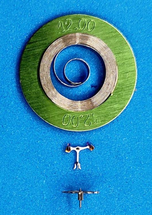

I've faced such complaints earlier and started taking photographs of the parts I ship to my customers. I've attached the picture of the parts I sent to the OP before sending for reference. Please let me know if you see any broken escape wheel pivots.

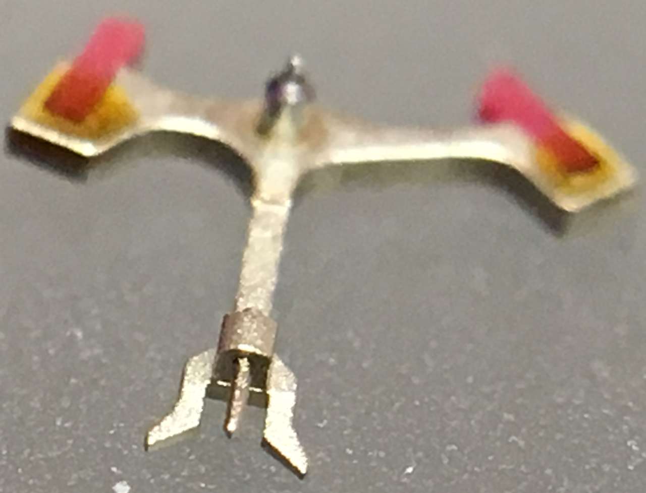

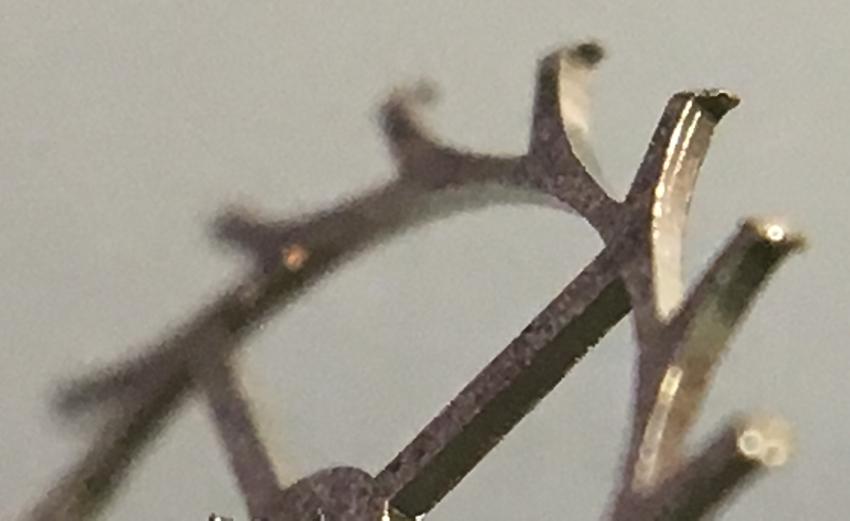

This escape wheel pivot is damaged and just impossible to get clean.
The teeth of the escape wheel look very worn.
The pallet staff pivots are slightly worn and impossible to get clean.
The guard pin isn’t polished. I'm not sure that is always the case, but it is my personal experience that the guard pin is polished.

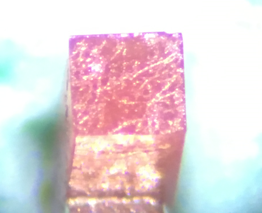

Slightly crackled and worn pallet impulse surface.

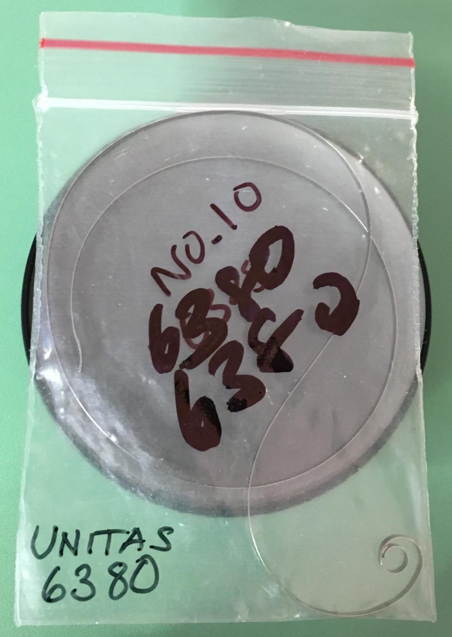

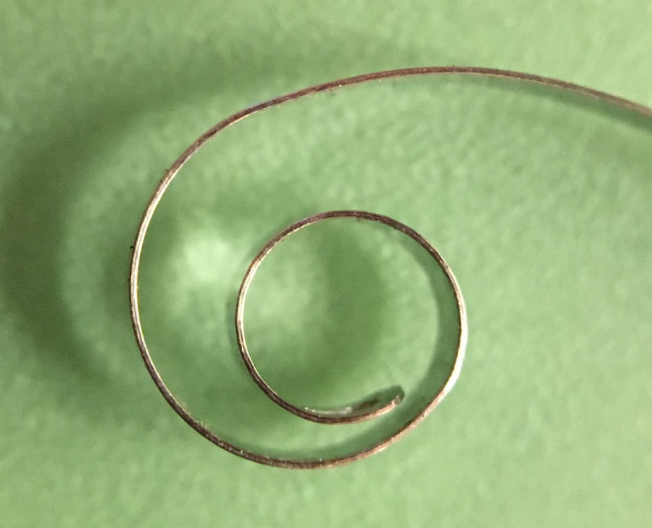

This is how the mainspring was packaged. It did not come tucked in a spacer as shown in your picture.
A slight abuse can be seen in the innermost coils of the spring, and it is of course dirty.

Oh, I should mention too that all parts in my pictures, except the mainspring, has been meticulously cleaned. They were excessively dirty upon arrival.
Thank you for the pictures and the explanation!
As mentioned, these are the stock from 70's. These parts are bought in lots and stored for quite long time and its difficult to check every part in a microscopic level that I ship to a customer.
I would be happy to issue a refund as soon as I receive the parts back and we can close this thread. :-)
